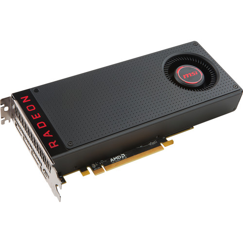

The safest bet should be the RX580 with the reference cooler
Reactions: skeptech
Isn't that what I already have with the Sapphire Pulse?
No, the reference RX580 looks like this.

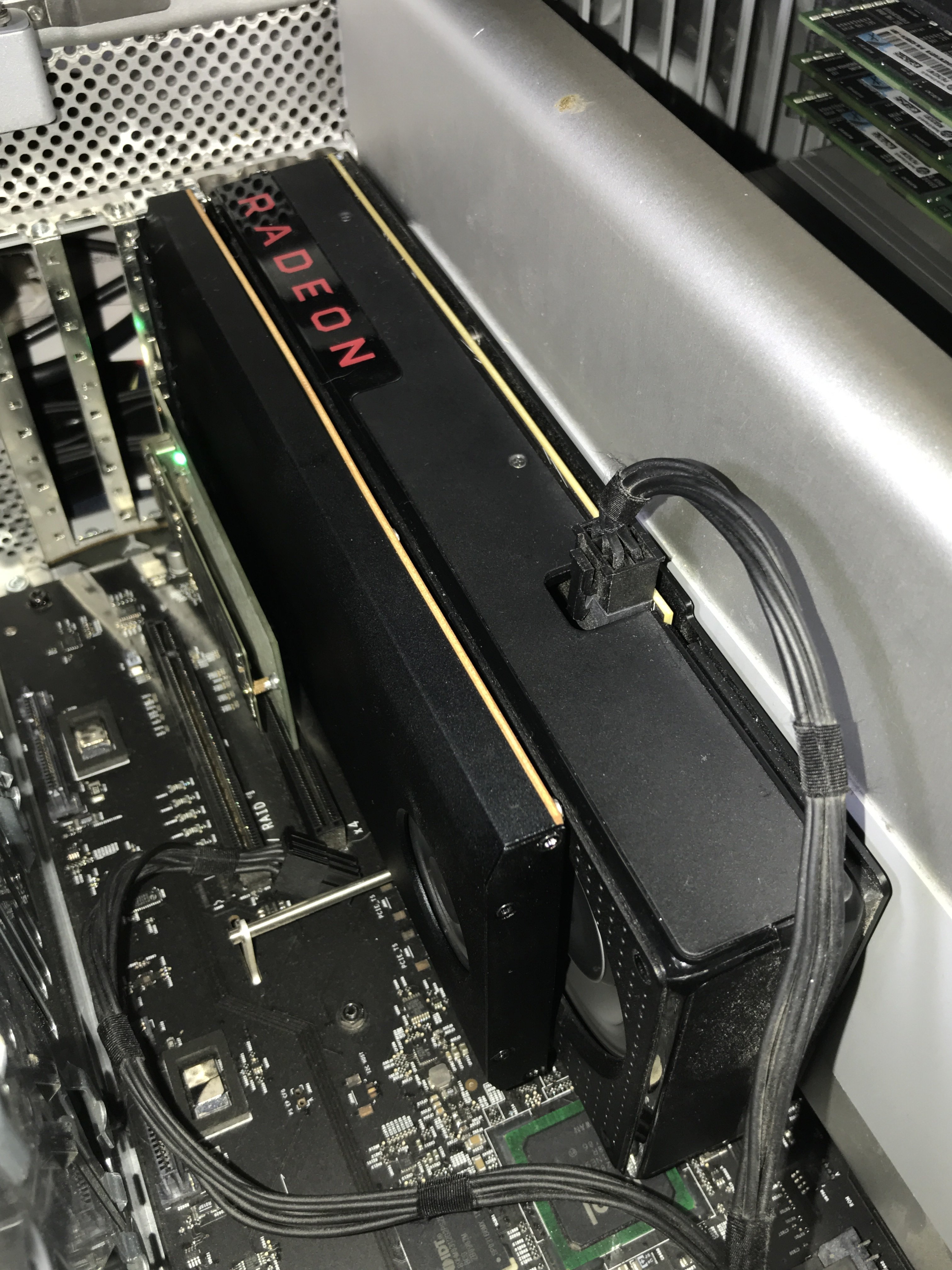

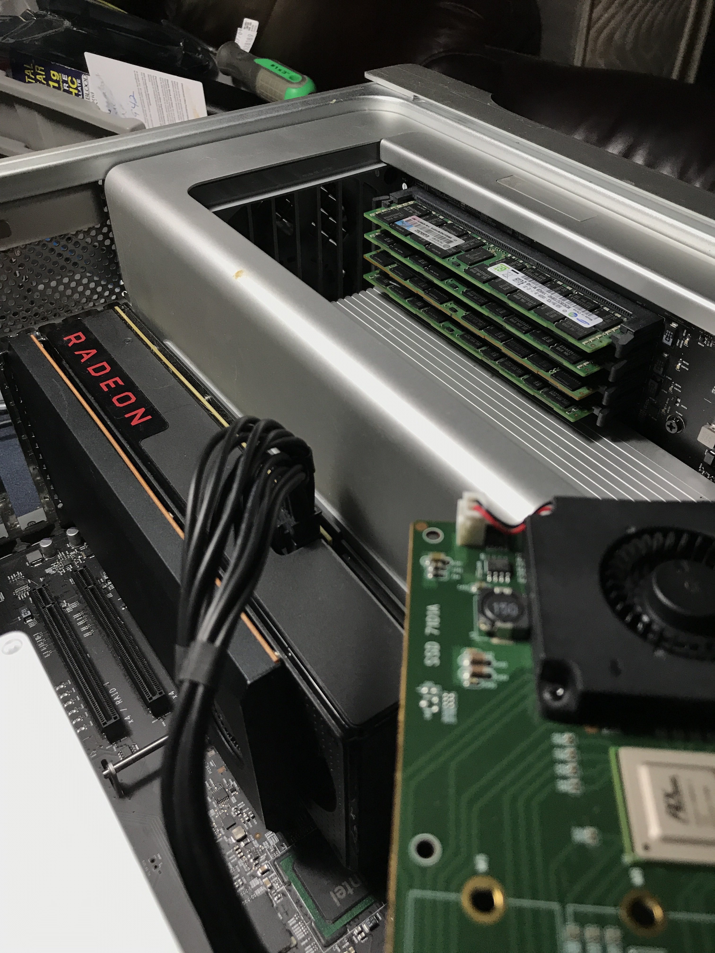

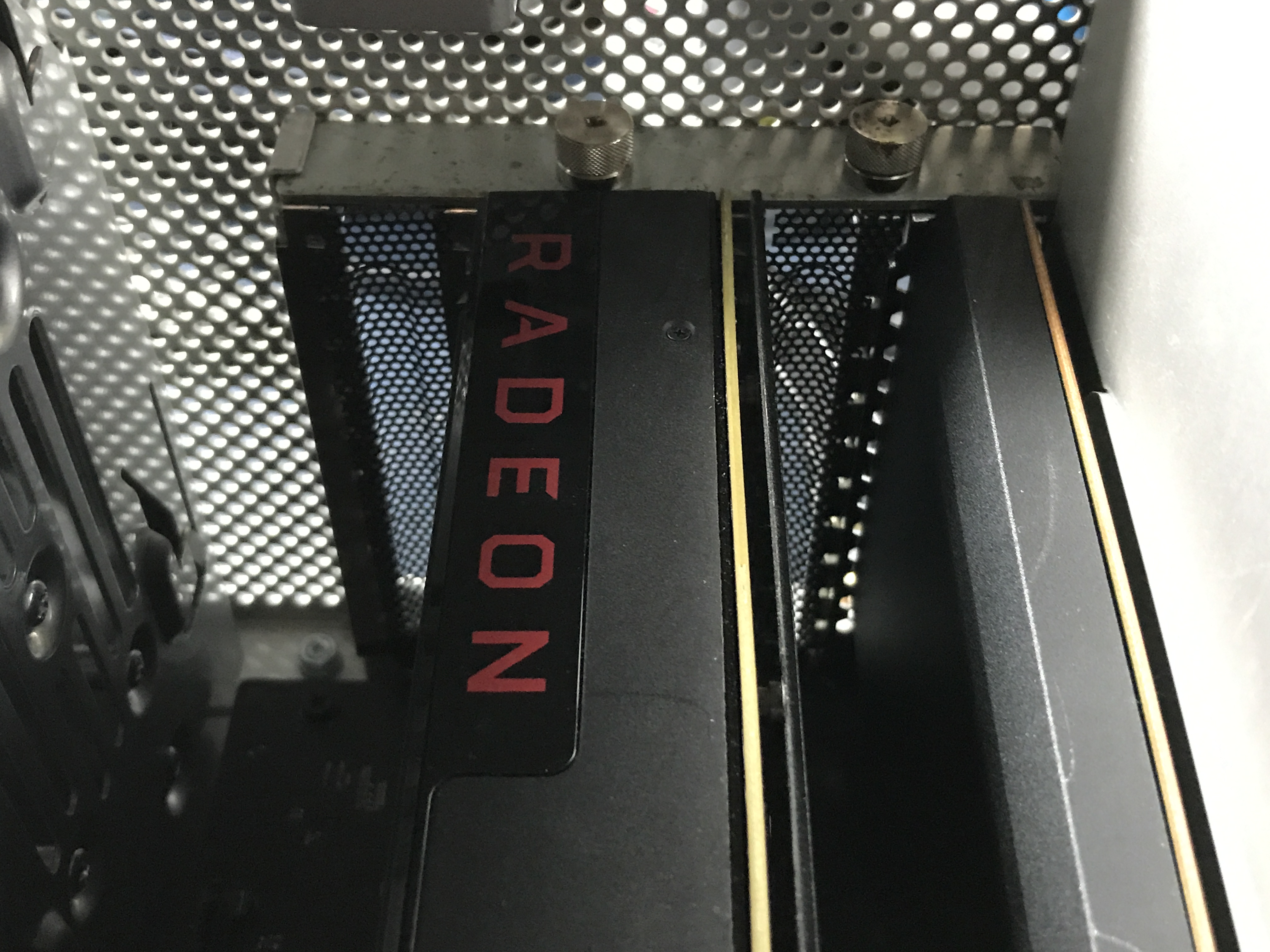

The card is out of published spec. It's 44mm wide, not 40mm as it should be. The fan hub protrudes past the case and rubs a chip on the back of my raid nvme card. I can't put the 580 in slot1 because it will damage the x16 card in slot2, so they have to be inverted. This is a workable solution and even cools better I think, but it blocks access to PCIe slot 3 which I would like to use.
Gotcha, I would agree that the reference card may be your best bet then unless you want to use an all in one cooler.
