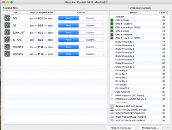

Ok Thanks I will send you the rom. But even in the Sierra the card was running damn hot sitting at Idle, not until I forced the fans through the MFC the temp dropped down.

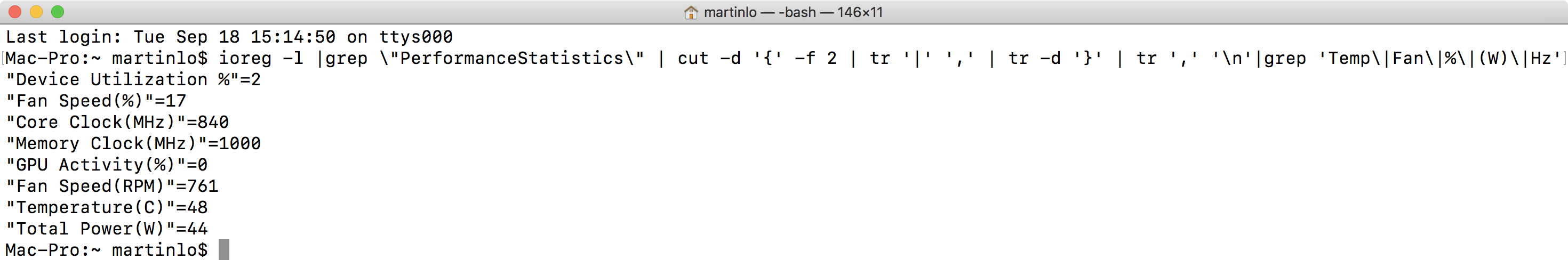

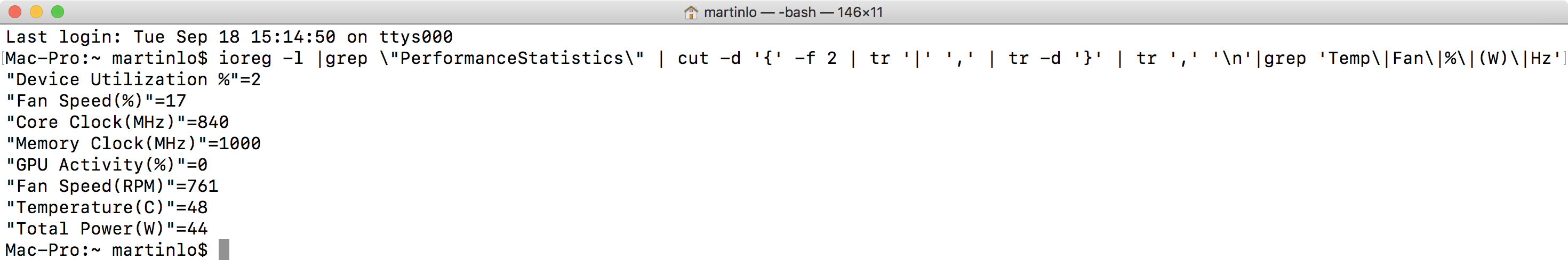

Your screen capture shows nothing about the GPU temperature.
As I said before, you can use this command in terminal to read the GPU temperature.
Code:
ioreg -l |grep \"PerformanceStatistics\" | cut -d '{' -f 2 | tr '|' ',' | tr -d '}' | tr ',' '\n'|grep 'Temp\|Fan\|%\|(W)\|Hz'
The result should looks like this.
Anyway, for human being, 50C is quite warm to touch already. But for graphic card, 50C is cool. And your card's fan should be programmed not to turn on until certain temperature (e.g. my card is 40C). Therefore, even nearly idle, it can still be quite warm to touch. And it is absolutely normal for this generation's GPU.
Last but not least, it will be much easier for me to read if you send me the graphic card's ROM image, but not the data via DarwinDumper.

your temperatures look fine, there the same as mine basically.
yours are a tad hotter but your ambient is 33c and mine is 26c so in proportion to your hotter climate the temperatures are the same.
if your GPU hits 100c then you have to look in to it, it's designed to run around 80c + as you have a reference style cooler on your card it will just dump hot air out of the case, that is the kind of card a macpro was designed for.
ie it actually will aid in cooling the macpro.
Code:

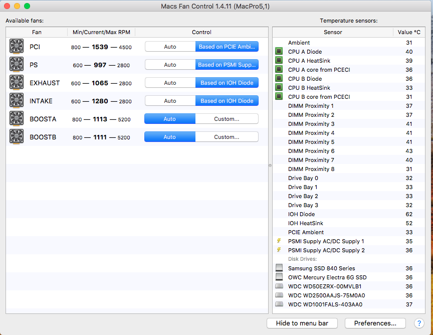

I thought IOH diode temperature was affected by the proximity of the GPU card. CPU's I made sure to put the proper thermal paste.

You RX580's temperature is absolutely normal, as you can see, same range as mine.
The IOH is on the CPU tray, nowhere near the RX580. For 33C system ambient temperature, 76C also very normal for the dual processor cMP.

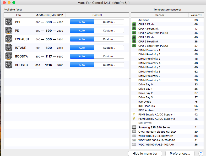

what is hot?

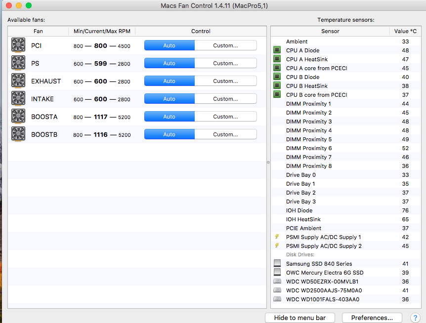

So you think it is safe to be at 76C at idle?

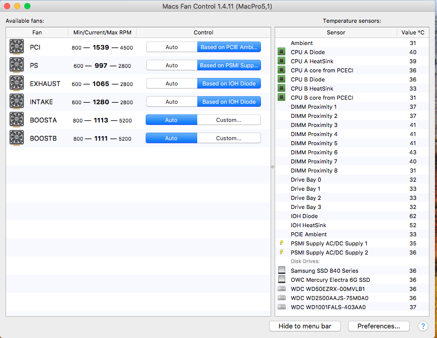

So you think it is safe to be at 76C at idle? With this fan configuration it falls to 62:
when you say 76c are you talking about the RX 580 or the IOH?
this is getting off topic now from RX 480 v 580, if your talking about the IOH may be worth doing some searches on the forum

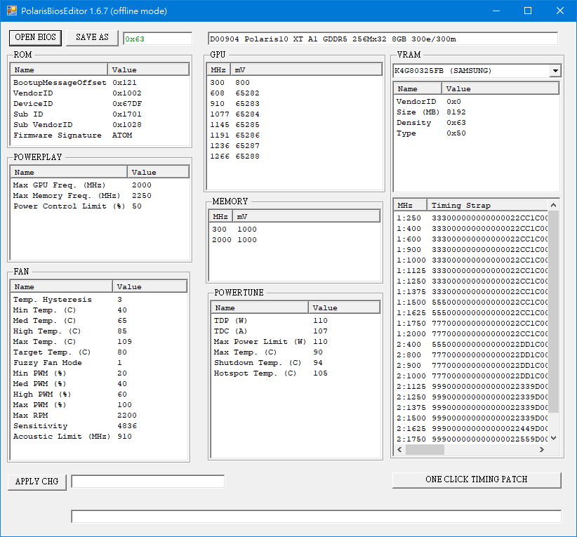

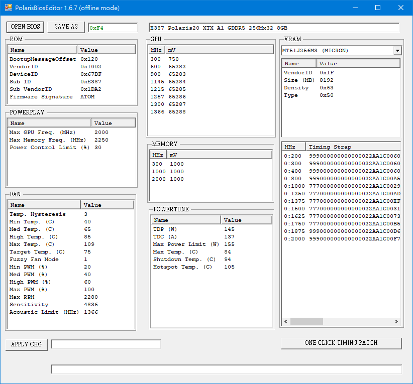

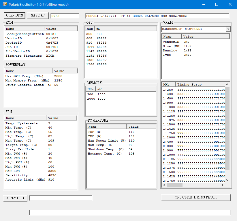

This is your RX580's setting

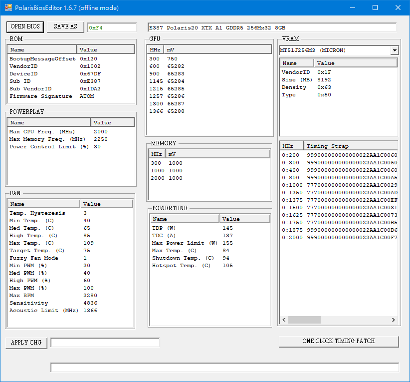

And this is my RX580's native setting.
As expected, your card's fan won't spin up until 40C, that's why you feel it's hot even at idle. That's the default setting, same as my card.
And your card's target temperature is 80C, which means, when the GPU is below 80C, the fan will only spin up a little bit (may be around 1300RPM). Until the GPU approaching 80C, then the fan will spin faster and faster to try to keep it at 80C. Once the fan speed reach 2200RPM, the GPU temperature will continue to go up, until it hit the max temperature 90C. bBut unless your ambient temperature is abnormally high. The card should not able to reach 90C due to its power draw is limited. But it should stabilise somewhere between 80C and 90C.
Your card shows that its default max power draw is 110W, however, with 50% "flexibility". In my observation, it means the card can draw up to 110x1.5 = ~180W in macOS. I am not 100% sure if there is any other constrain in the VBIOS to limit the card not to draw more than 75W from the slot or the 6pin (I bet NO, that's why the RX480 suffer from the power draw gate when it launched). In general, you should not able to reach this power draw in any real world applications, but if you run Furmark, I expect you can see 180W. In any case, you better run some reasonable benchmarks (e.g. Luxmark, Unigine Heaven, etc), and monitor if the card draw too much.
Anyway, your card ident itself as Polaris 10 in the ROM, I bet this is why macOS ident it as RX480. But since its Device ID is 67DF, it will use the same kext as any other RX580 does.

On auto with ambient at 30C my IOH sits at 76C. So yeah, that's pretty normal. If you wanna see the IOH drop you should setup the boosta fan. It's a bit quieter than ramping intake and exhaust from my experience. I personally setup my fans with the exhaust and intake set to ramp on memory temps and boosta to IOH. Your memory looks pretty cool so you could probably stick with just the boosta and keep the rest on auto.
Reactions: h9826790
Thanks a lot for your help. It looks like mine is running at 50C (while yours is at 40C) at Idle due to the single small fan onboard. And is limited to 110W. Nevertheless I have connected it to the 2 6pin connectors which should give me around 120W in theory from each plus 75W from the PCI slot which is plenty of power. My real concern is the temperature not only in the card but also the overall temperature, because all internal temperatures depend on each other as well as on the air flow.
Yes they do, but in the case of cMP, the PCIe compartment can hardly affect the CPU cage's temperature. Warm air is very hard to go down, plus the CPU cage is almost separated from the PCIe compartment. The GPU is really really had to warm up the CPU or IOH. Even my open fan type 1080Ti can't do that. Your blower type RX580 should be quite impossible to make any noticeable difference to the CPU cage's component temperature.
