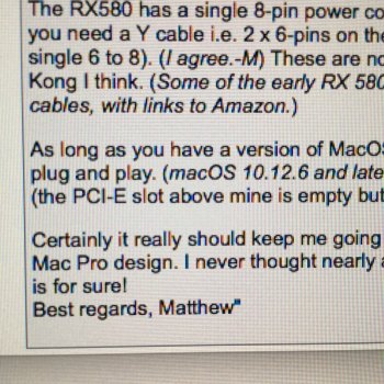

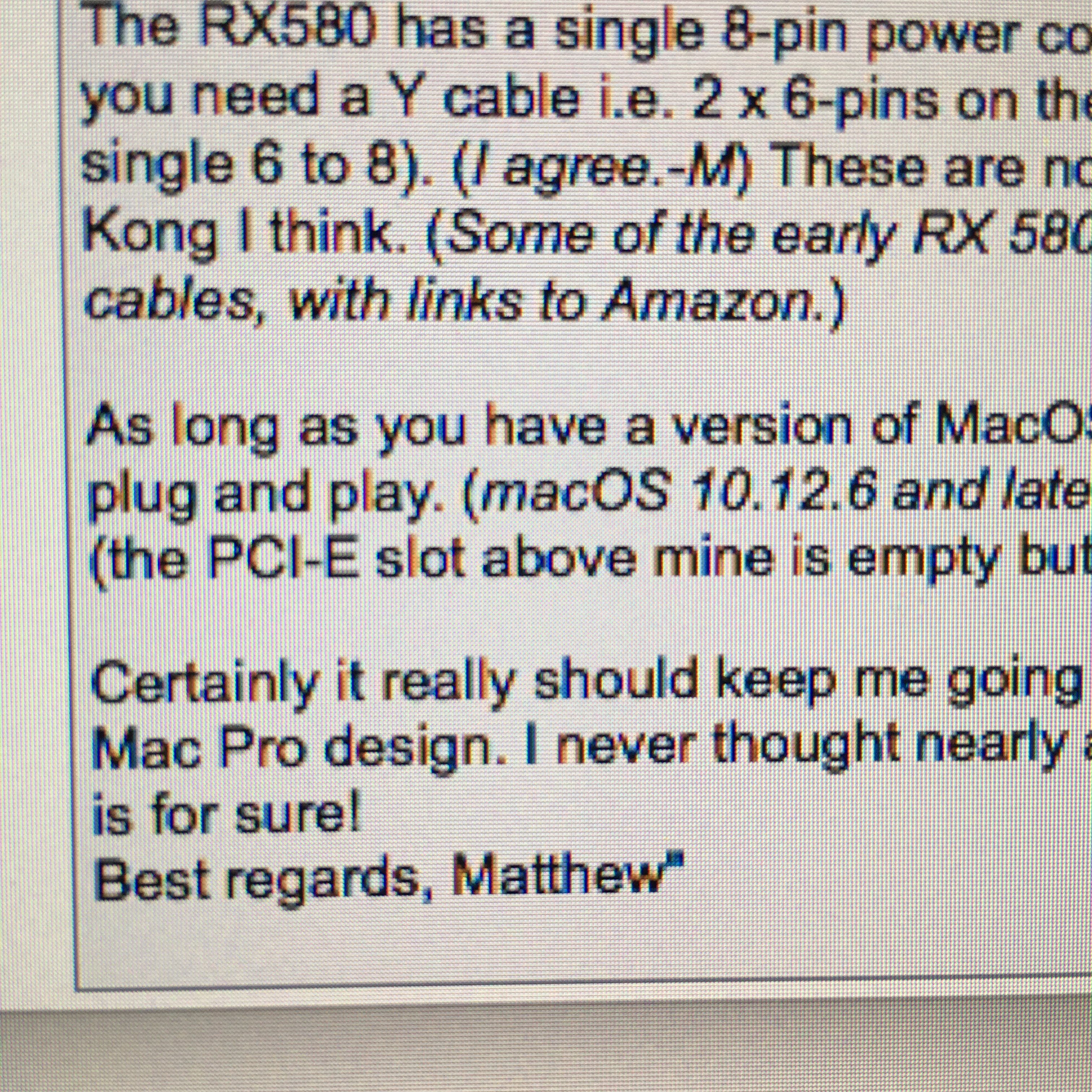

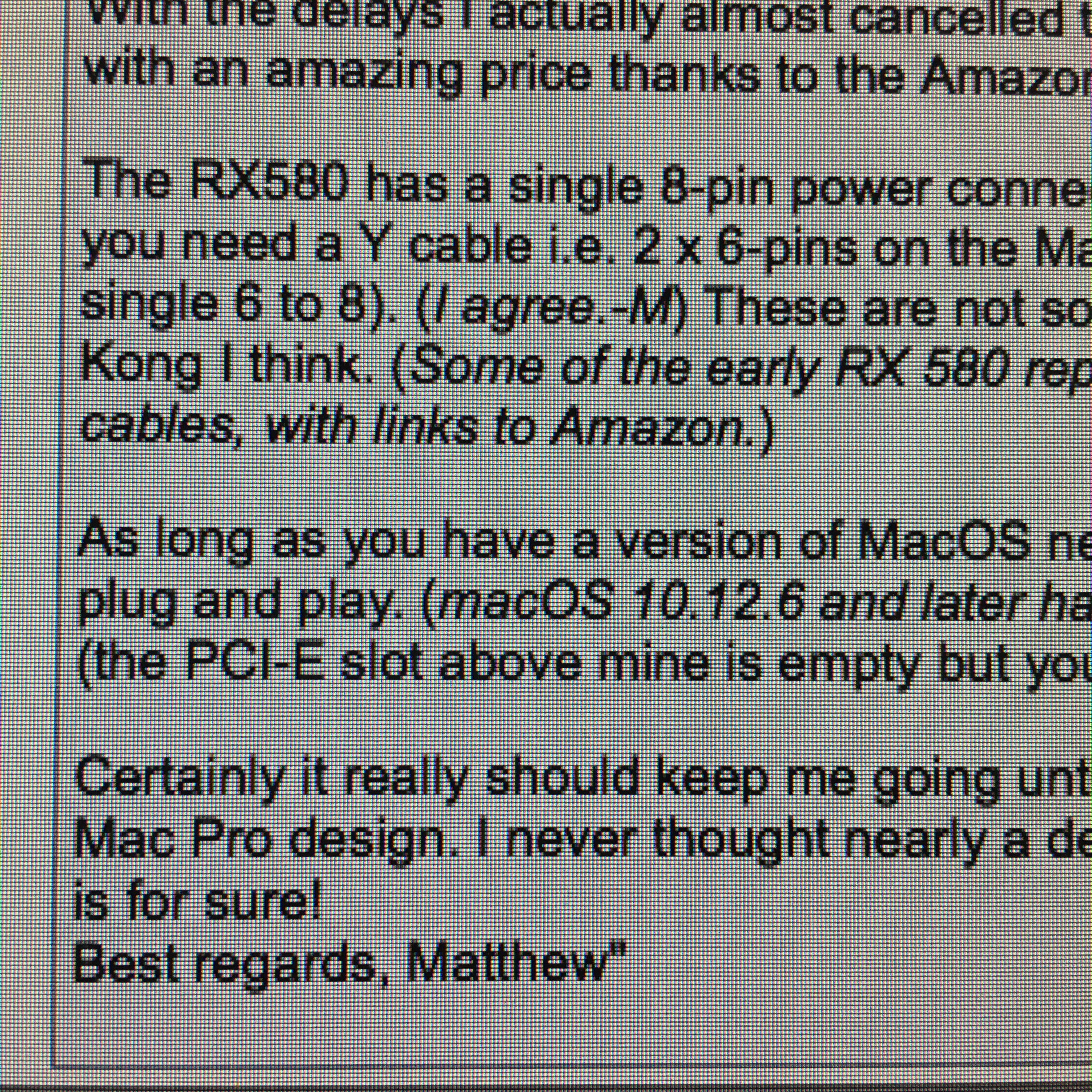

The problem: on the Dell monitors there's a strange pixel shift happening on small text as per the attached picture. This happens on any small text whatever the colour. As you'll see, this isn't happening on the Apple display.

To me, that looks kinda like the aliasing you get when not running an LCD at its native resolution. Can you try changing the resolution around to different settings in System Prefs and see if the behavior changes (or goes away)?

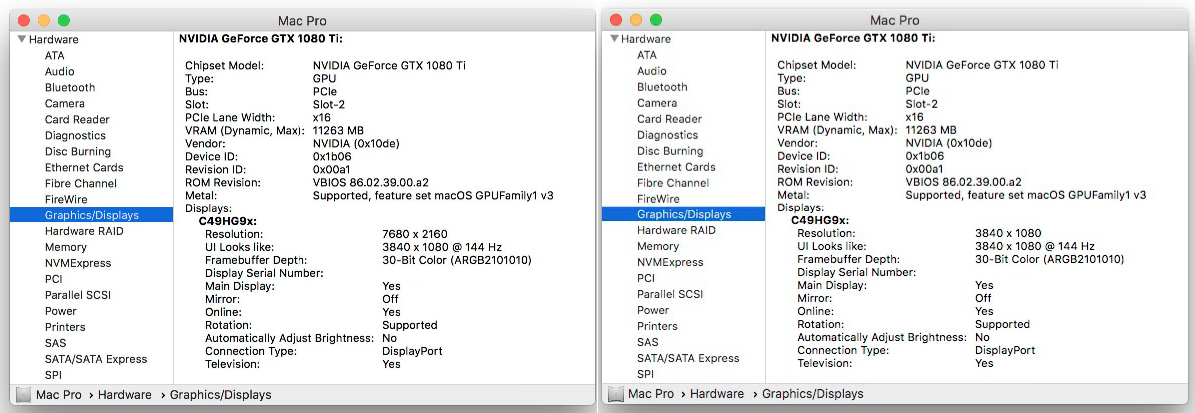

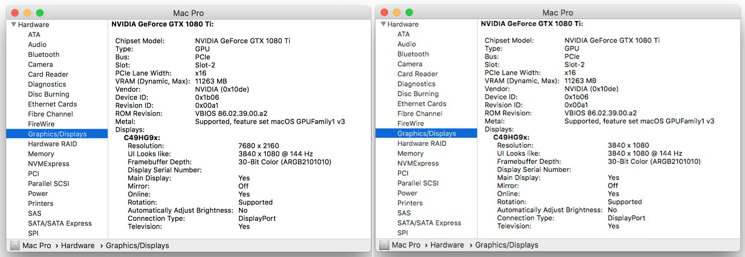

I force the UI to render at HiDPI to "fix" this issue. And it's nothing about RX580. Same thing happen on my 1080Ti. So, it's definitely how the OS designed to render the text (under that particular condition).
As you can see in the comparison. For the same monitor, same size, The forced HiDPI one produce much clearer text.
Even the front smoothing is better in Mojave. But still not as clear as Forced HiDPI rendering, and then scale back down to the native resolution. This is actually the same concept as High Dynamic Resolution in gaming.
