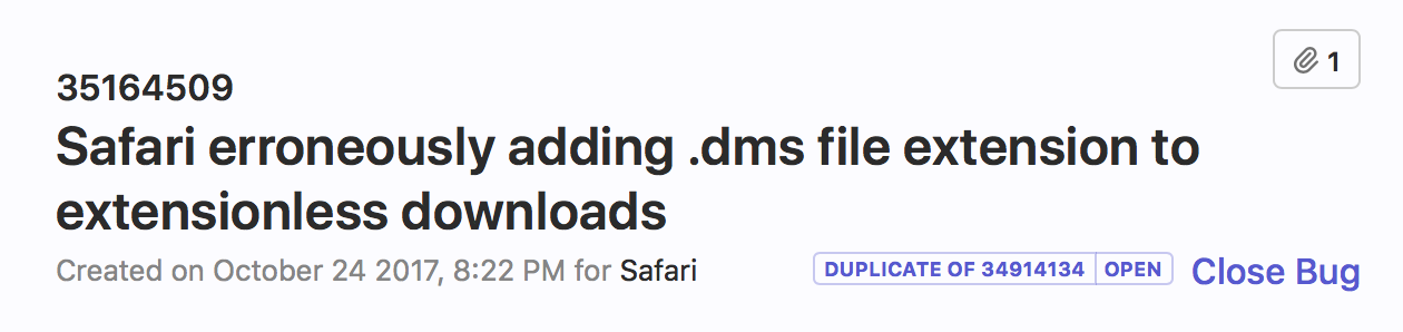

For anyone curious, Apple are aware of the issue. The bug I opened has been tagged as a duplicate.
