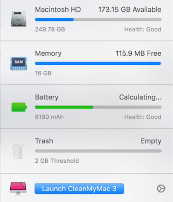

I'm thinking something happened when I used CleanMyMac 3. Also right now, the CleanMyMac 3 app is telling me I only have 2.57GB memory left out of 16. I can't figure out what is eating up all this memory! Nothing is running except Safari.

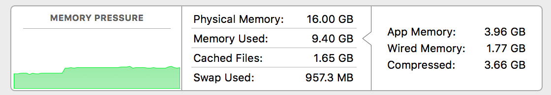

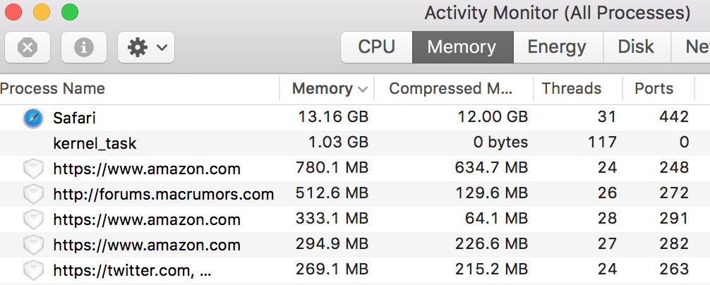

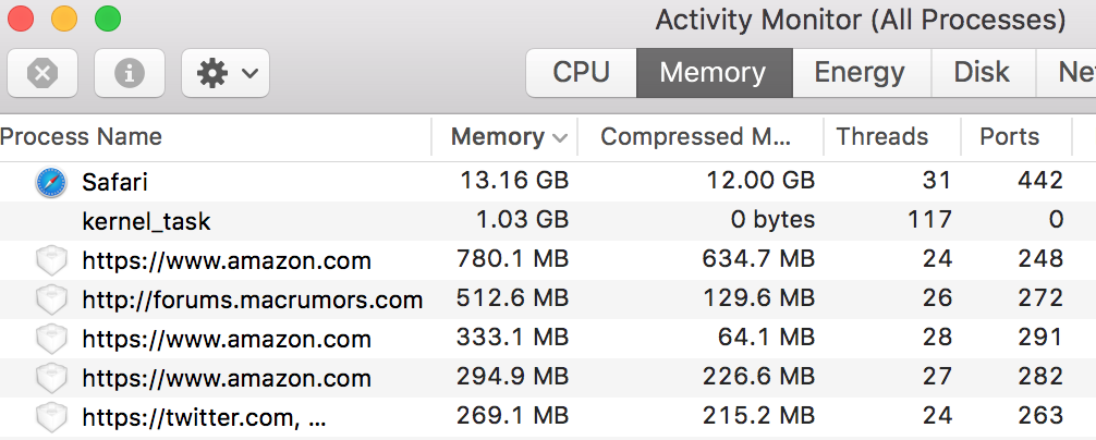

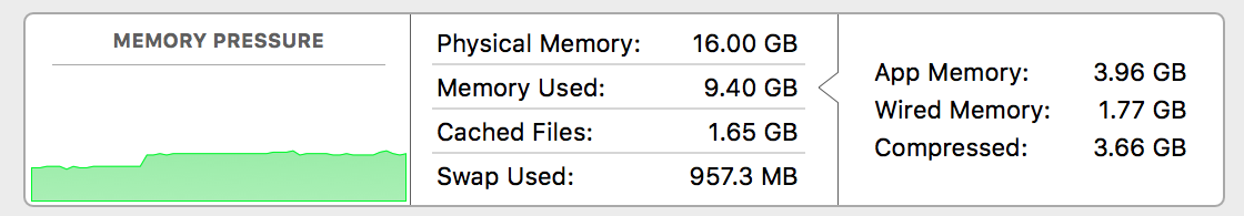

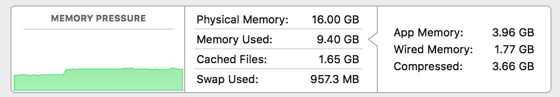

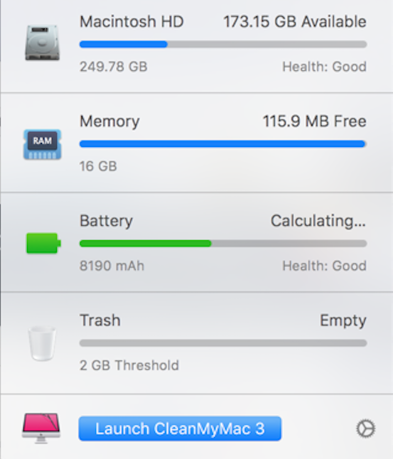

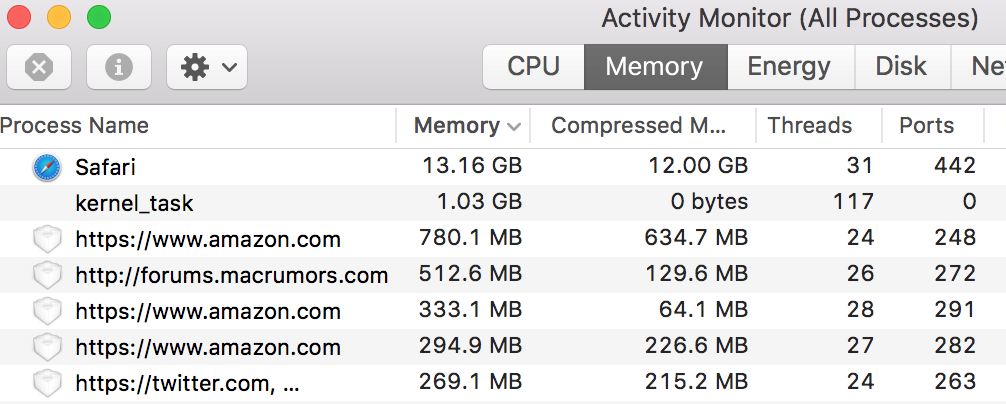

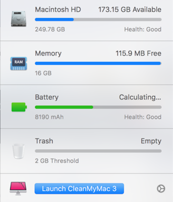

UDPATE: I left the computer idle and then came back and the memory went up even further than 7GB, right now these are the stats:
View attachment 681859 View attachment 681858 View attachment 681860
You definitely have a problem with Safari that's for sure. CPU usage by Safari, should not be around 100. That's eating an entire core on your system. And 13 gigs of RAM just for Safari is ludicrous. Would you try using Safari for a while with a guest account on the computer, and see if the issue is persistent? If it is, it's sort of a deeper issue - if it isn't, it's a preference issue that we can probably fix by deleting the right file, and having macOS replace it
