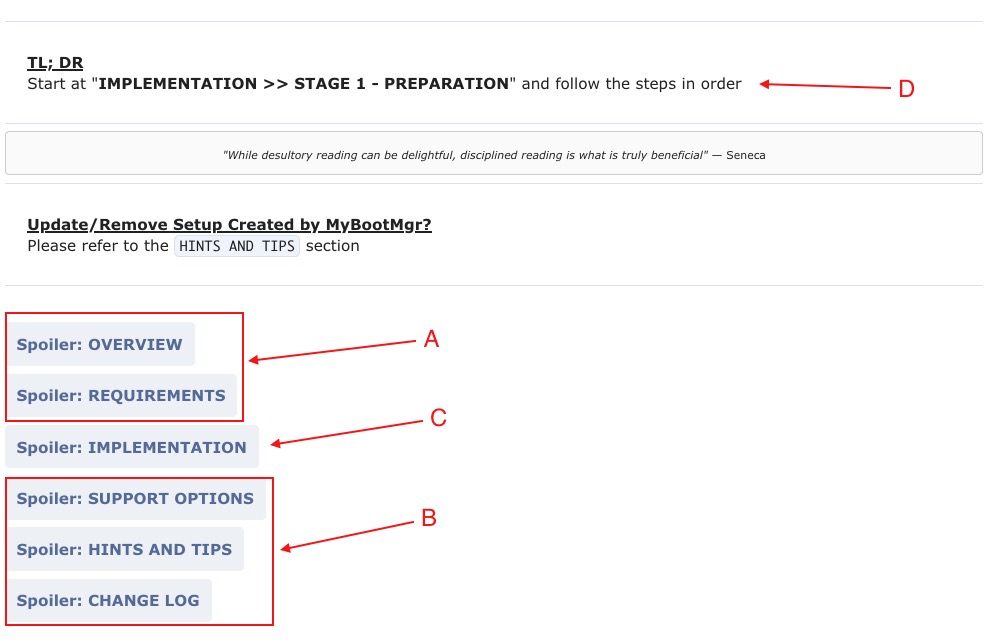

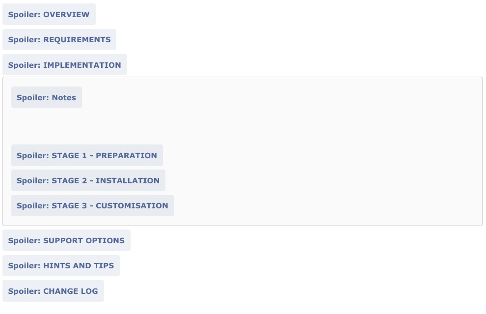

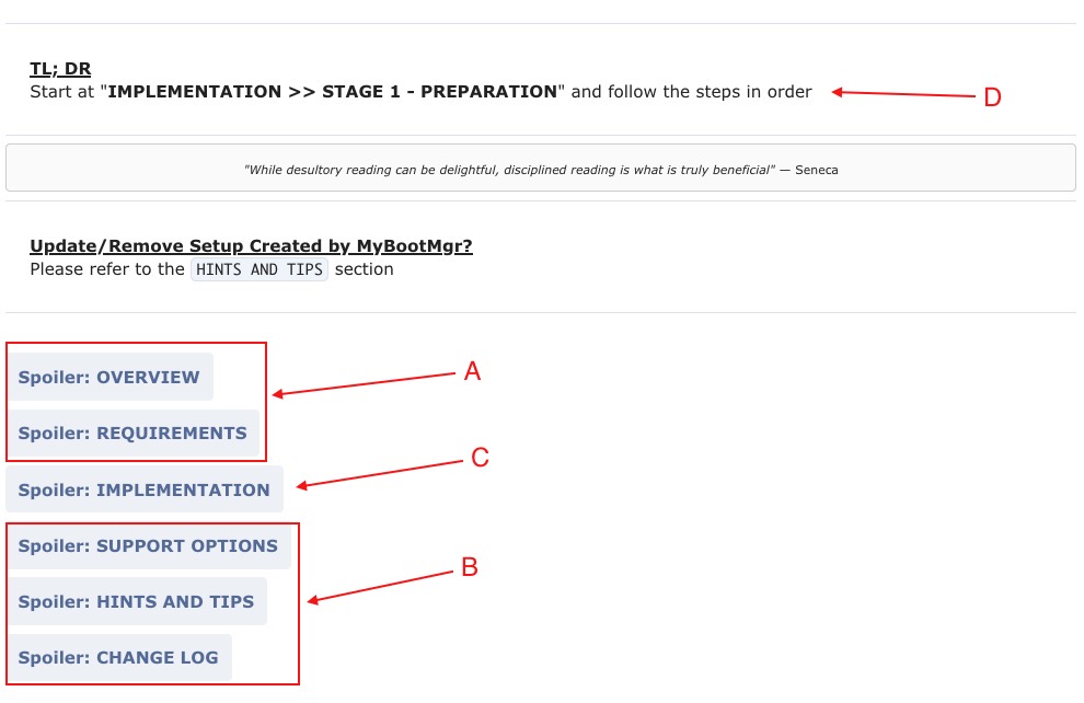

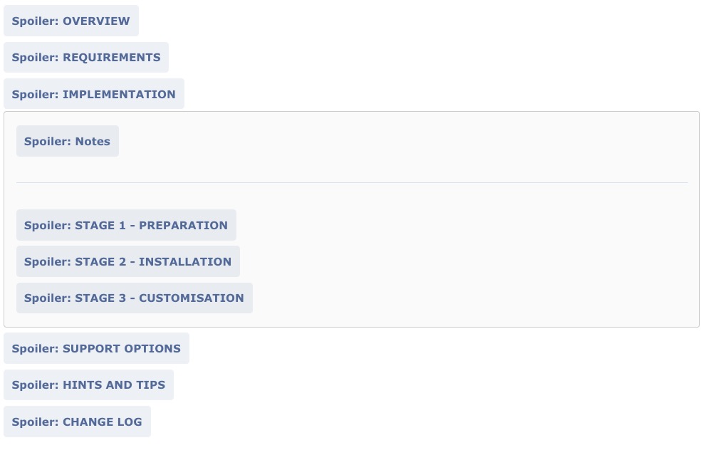

You have gotten some good advice on options you can follow to proceed but I assume you actually mean RefindPlus by "Refind+" and are referring to the MyBootMgr instructions.
If so, I have gotten a bit of feedback over time that the instructions are complicated indeed. However, most are not able to articulate what they actually find complicated. It could be that things were poisoned in the thread by the first response and fits with those not inclined to read anything in the first place but I might be wrong.
When you look at the page there you will find this:

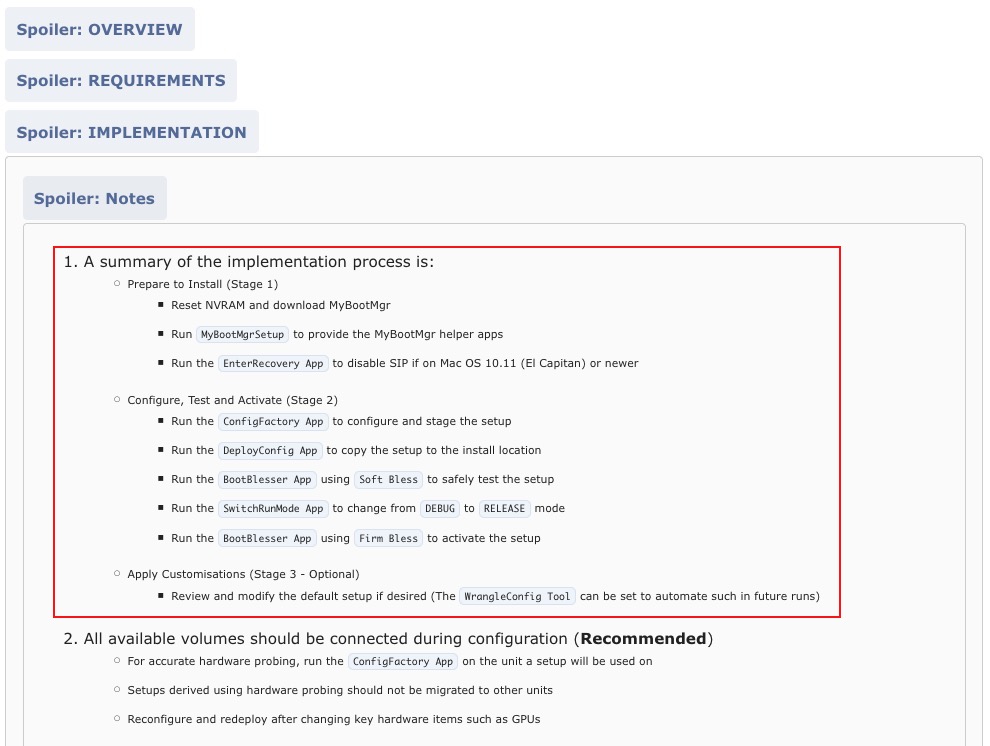

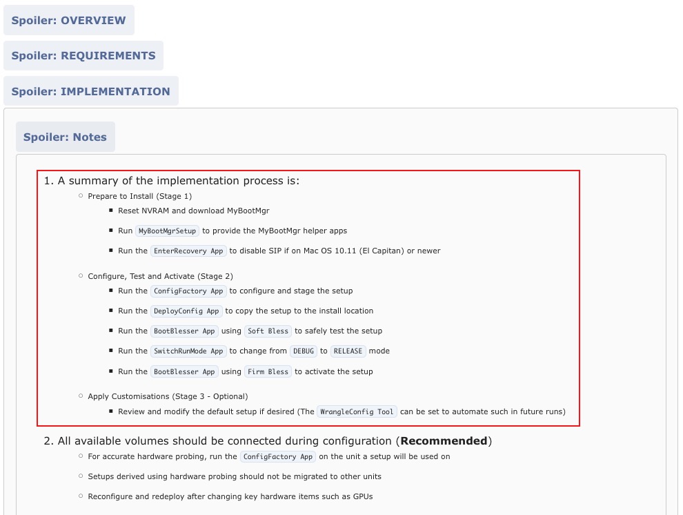

I would have thought it would be clear that "A" and "B" are giving background information and that "C" is where to focus on for what to do but it has apparently not been the case. I then added "D" but some have (hopefully) gone where it points but then apparently got totally lost on encountering this:
I therefore added this summary under Notes:
Given the above, and assuming you actually did read the guide, can you help with how you ended up here:

Nothing wrong with critiques as all the improvements have come out of such.
When things are described as "complicated" and leaving a reader "not knowing where to start", a lack of clarity is poisonously implied and I need to try to get to the bottom of it. In every case so far however, including this one, it turns out that the issue is not a lack of clarity and that something else is the case.
Anyway, was only interested in seeing whether there was in fact a lack of clarity or undue complexity this time and there is no reason why you should not be able to get things up and running via your preferred option.
you're right (-:
i confirm you that, it's not an issue of clarity, instead me feeling nervous and anxious to render things havoc.
