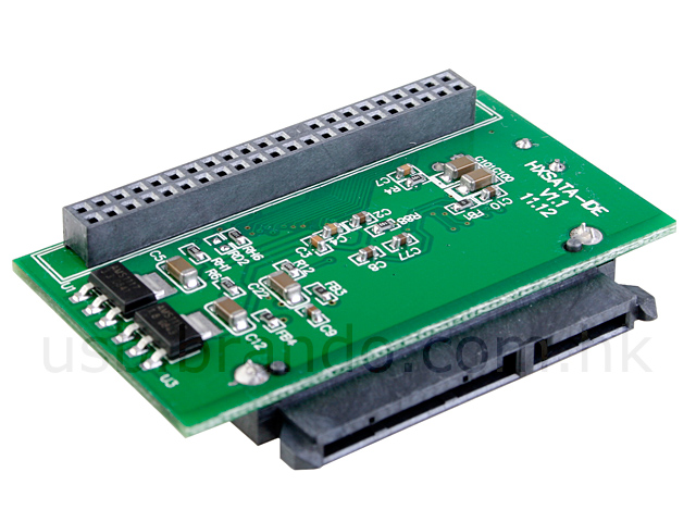

1) Make sure you wrap electrical insulation tape (or a suitable alternative) around the circuitry of the SATA adapter, it can (and has with me) touched other components within your Apple TV enclosure and caused the drive to stop working
2) Do the above to the drive itself...I had an incident a few months ago, where my Apple TV froze..As soon as I took my drive out of the Apple TV enclosure it burst into life again, so all I could assume was, it was some of the circuitry on the bottom of the drive that was shorting out. I insulated it using tape, and have never had the problem again

I'm a bit concerned about the whole "wrap the hard drive in tape" solution. Can anyone think of a more elegant solution? Is there a non-conductive material that could simply be placed between the harddrive and the guts of the AppleTV?

I managed to get everything in there in such a way that the topside bulge is at a minimum. One thing I discovered: wire ties won't fit. There's truly no room to spare with this adapter. And as a matter of fact, the SATA/Power cable proves to be more problematic than the adapter.
Someone noted earlier in this thread that the adapter needs to be wrapped in a non-conductive tape to avoid shorting things out. I did this and it worked. But after about 15 minutes the Apple TV froze and upon rebooting it flashed the question mark graphic. After a great deal of methodic testing, I determined that the adapter had failed! Being the boyscout that I am (actually, I never was), however, I had a spare adapter on hand (purchased two for just this scenario) and replaced the defective one. This time, rather than wrapping the adapter in tape, I simply used the tape to secure it in place; providing a thin, non-conductive film between the adapter and the metal bottom of the Apple TV. I've been stress testing the system all day with the installed 640GB drive and all is well. I'll be watching a high-def movie tomorrow to ensure heat doesn't throw a wrench into things.
One little note (and question): The adapter purchased from Brando had an extra pin tht doesn't fit in the IDE cable. IDE doesn't seem to utilize that lead, so I broke it off. Is that what others have done? It seemed to work!
Hey Nathan. Glad to hear you got everything working! Couple of questions...Is it necessary to break this pin off? Which pin was it?

Is it necessary? That's a fantastic question! I can tell you this...There's no way to make it fit otherwise (though it did make me question whether or not I had purchased the correct adapter). Check it out...
Or you could punch a pin hole in the IDE socket in the same place that the pin is going to fit in. That's the way I went, saves potentially damaging the adapter.
I think I may take this approach. An IDE cable is much easier to replace if it gets messed up than the adapter. =) What did you use to punch the hole in the cable if you don't mind my asking.

Question: What material (specifically) are people using to insulate the SATA adapter in order to prevent it from shorting out when in contact with the AppleTV's aluminum bottom? I used a nylon electrical tape that's supposedly rated for high heat. I ran three thin strips of tape between the power supply and CPU fan (is that what that is?) securing and insulating the SATA adapter between (right on top of the wireless card). Any other ideas?
Is this the 90 degree SATA adapter others have mentioned in the past? What prevents it from being a possible solution for PATA to SATA inside the AppleTV?
Maybe just the orientation of the cables when they're plugged in?
BTW...my adapter arrived this afternoon. I'm going to see what I can do with it tonight!
The power supply is elevated above the 44-pin connector on the ATV, so this adapter would only fit if it protruded in the correct direction. If it goes the other way, then the PS would be in the way and it wouldn't seat. I can't tell from the photo which direction it would need to go. Even if it fit, there's still the possibility that it wouldn't permit booting.
I too am unable to determine the correct orientation of this adapter in relation to the AppleTV's PATA connector. The power supply would indeed prohibit installation in one direction.
If, however, the adapter is to sit the other way, it seems as though it might work. I'm willing to purchase it and give it a try, but I'm curious as to what might happen if inserted "backwards." There's obviously some power running through these wires...Any chance of causing permanent damage to the AppleTV power supply?
