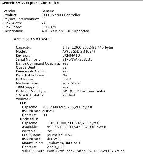

So I got the Apple 512GB PCIe SSD installed, and the one thing that I noticed is that it refers to the disk as an external removable disk. The icon for it is yellowish/orange. Is this just something that happens, or can it be set to know that it's an internal disk? Does it make any difference at all?
It is external in that it's not using the internal SATA controller. It will always display as external. There is nothing you can do to change that, but it doesn't make any difference.
I don't remember what product exactly it was, but some backup software refused to backup the data because it recognized the disk as an external one. rare, but it can make a difference. I didn't experience any negative effects with my XP941 or Apple/SAMSUNG SSDs because of this.
Yes I remember that thread/post and it turned out to be user error in that the user didn't go into the preferences menu and select the settings to use the correct disc/SSD. The OP corrected his error and it worked well afterwards. Who ever heard of a modern backup product that can't use external drives. Even archaic software backed up to external tape drives.
What I meant by it makes no difference, is that it's not a detriment to normal booting/use. It's not a trade-off, it's an enhancement.

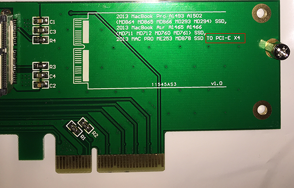

How long did it take to receive your Sintech card from China?
It took 21 days in my case. Received yesterday.

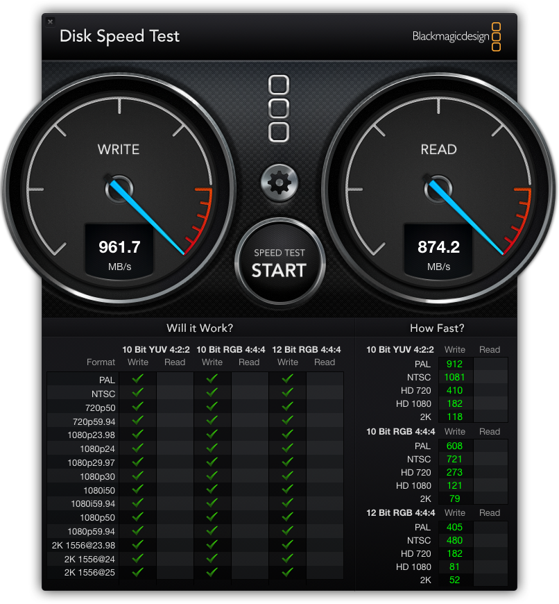

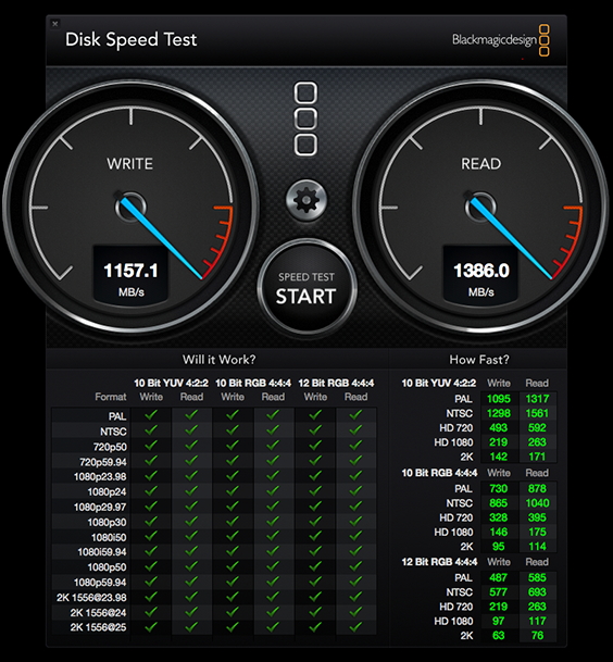

I can confirm that the Apple 1 TB SSD performs great in cMac Pro (4,1/5,1), in Slot 2 (as recommended), all 4 lanes active, as expected.
Blackmagic Disk Speed Test:
1157 MB/s Write
1386 MB/s Read
1157 MB/s Write
1386 MB/s Read

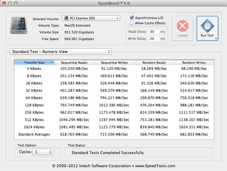

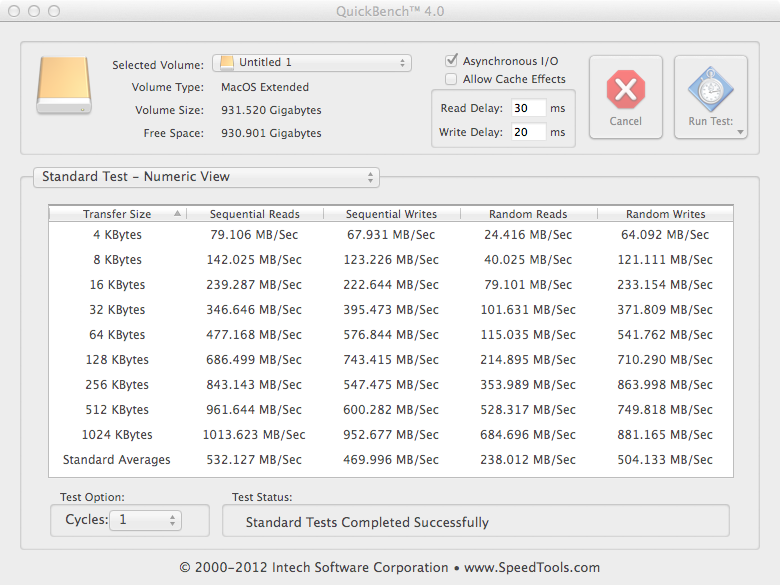

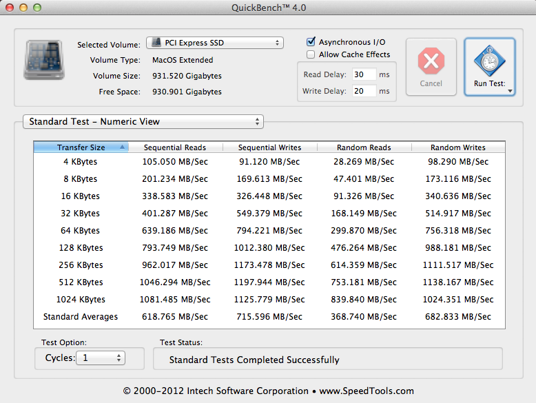

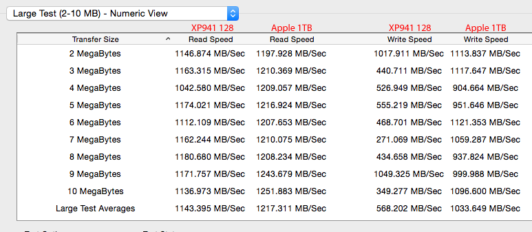

Here is a snapshot from Quickbench 4.0 1TB rev A01 Performance is on par with the XP941. Higher performance seems to be coming from REV A02. DOH!!!

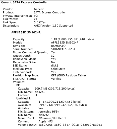

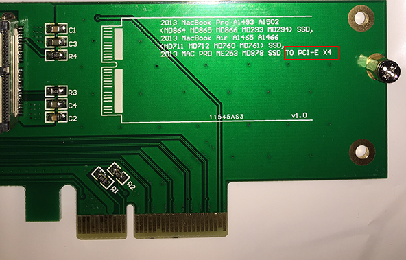

This seller of the Adapter-card: http://eshop.sintech.cn/2013-macbook-pro-air-ssd-to-pcie-4x-adapter-card-p-1026.html

don't worry, just test the bigger block sizes with QuickBench and you shall see more or less the same speeds.

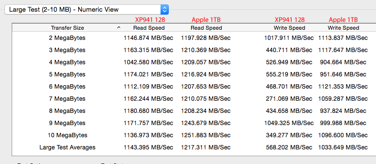

Thx for the tip. In Quickbench on Yosemite The SSD scales correctly in comparison to my existing XP941 128 I picked up in December of last year. Just not in black magic compared to Synchro3's post. In AJA System Test, performance matches the XP941 512GB as reported by barefeats.com . Samsung may be using their new 3D band in some of these.

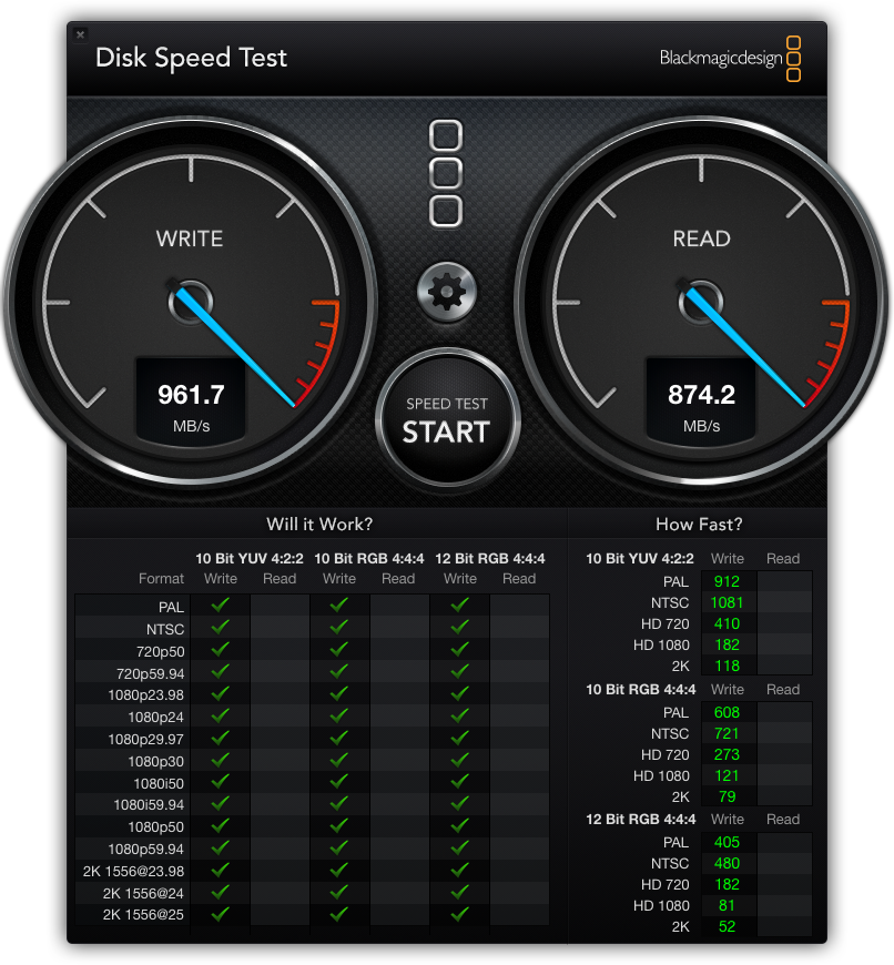

Strange read/write speeds after Yosemite upgrade?
Hello there
With this being my first post i'd like to start off by saying thank you for all the helpful threads and posts you guys come up with - i've been following the forum for a while and I couldn't have made the upgrades I did without your help.
Has anyone else but me noticed strange read/write speeds in yosemite?
Im using a XP941 256gb connected in slot 3 with the DT-120 adapter, and im only getting write speeds at around 360mb/s, and read around 380mb/s. On mavericks i was able to get read speed peaking at 1140mb/s.
Hope any of you can provide me with some info around this issue.
Thank you 🙂
Attachment below:
SI83m0u
http://imgur.com/SI83m0u
Is trim enabled? The only time I ever saw performance drop on the XP941 is after TRIM was disabled.
(screenshot from from MacPaulli)

Thank you for the fast answer.
TRIM is enabled With TRIM enabler, and even showing as so within "about this Mac".
I'm not really sure what could've made the read/writes drop like that, considering the Update to yosemite went flawless.

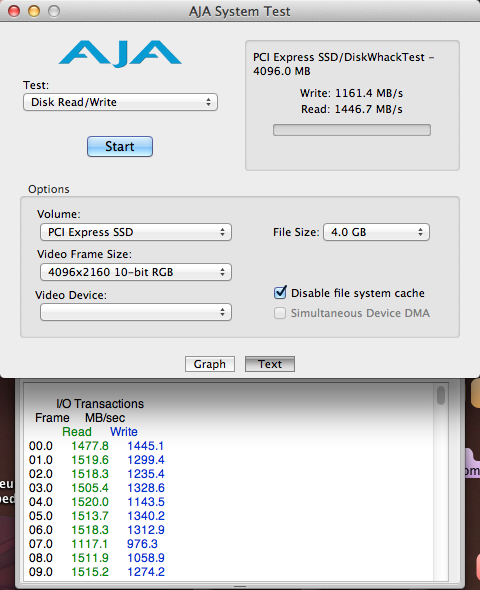

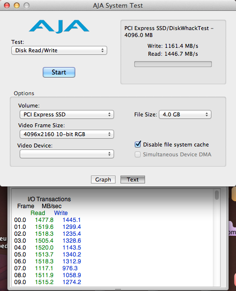

Now tested with AJA System Test 10.3.3, pls see attached pics

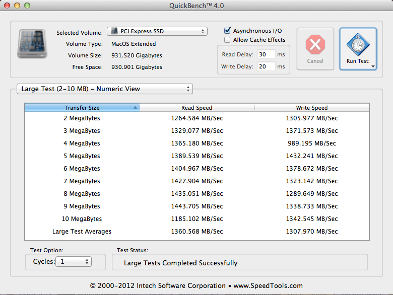

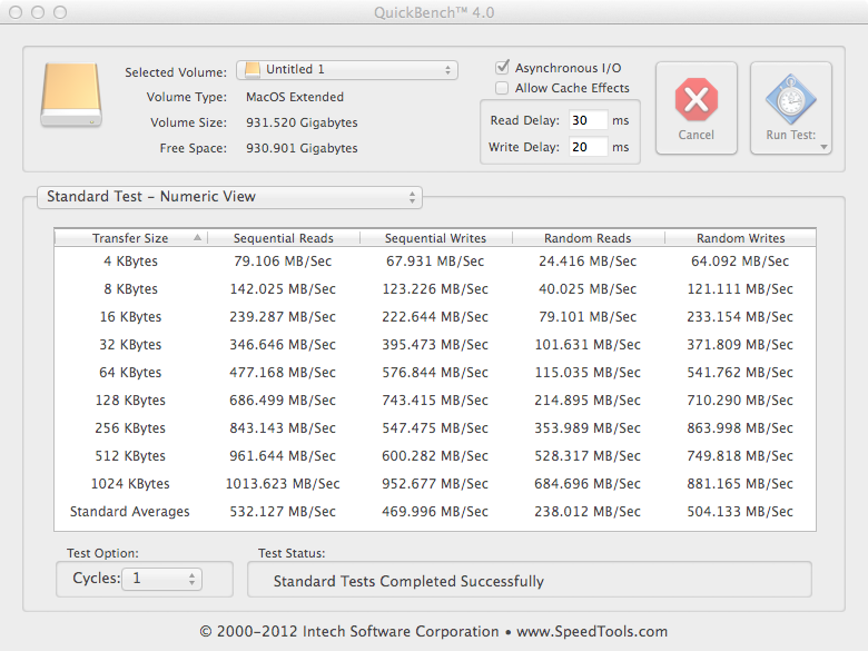

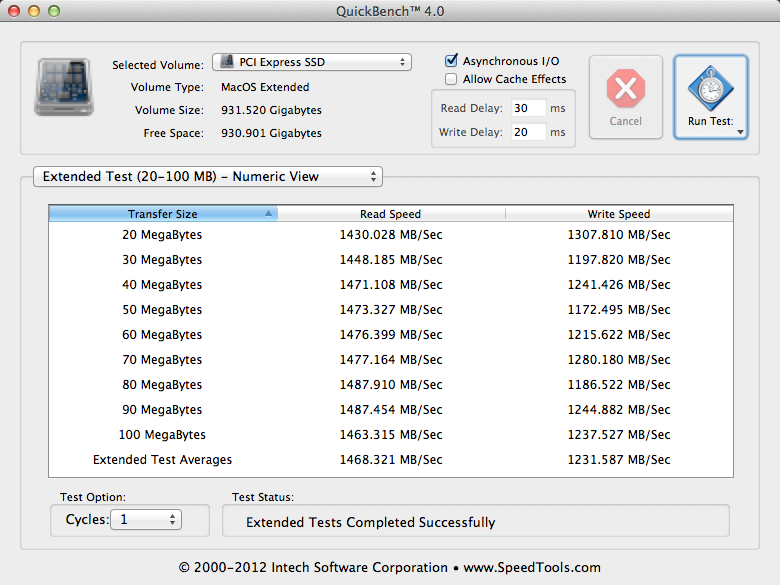

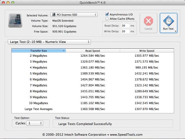

And Quick Bench. Pls see attached pics.

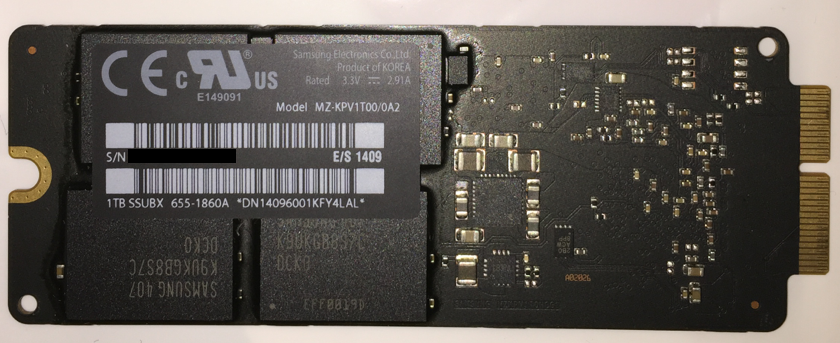

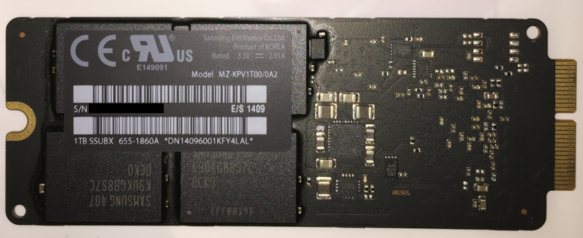

I (for one) am curious about these subtle differences in model numbers for the 1Tb Apple/Samsung drives and wonder what they mean? Could one (as u/handheldgames speculated) be faster than another? Here's what I've gleaned so far (correct me if I'm wrong).
-MZ-KPV1T0T/0A1 - comes with a heatsink and is sold by seller Sputnik.
-MZ-KPV1T0T/0A2 - I spoke with seller chrisdildilio and he indicated that the /02 is what he sells and that the only difference he was aware of between it and the /01 was that the /02 does not have the heatsink.
-MZ-KPV1T0T/0A6 - sold by seller mcko10 from South Korea. He indicated the same as chrisdildilio that the only difference he was aware of between it and the /01 was that the /06 does not have the heatsink. I have one on on the way and I believe u/mikeboss has this one as well?
-MZ-KPV1T00/0A2 - u/Synchro3's model number (bought form chrisdildilio?). Never seen this T00/0A2 number before your photo of it posted.

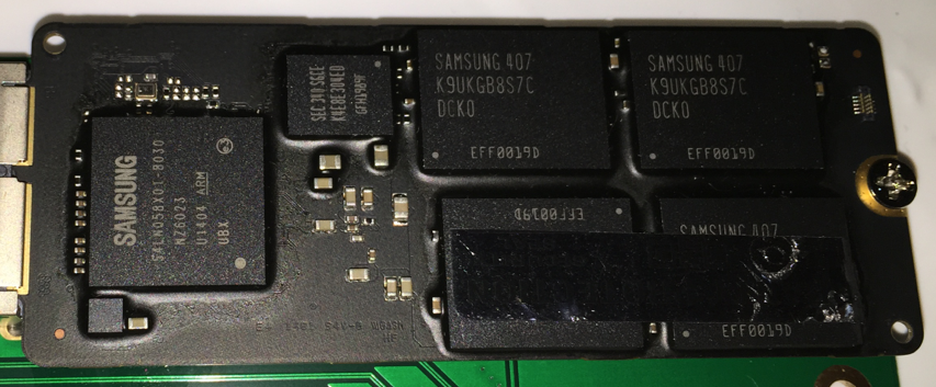

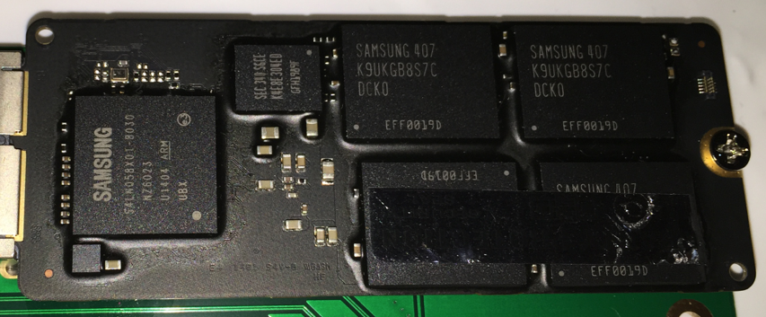

Now here's a really dumb question. The heatsink ones are for the nMP. Does that heat sink make a difference? Does it interfere with mounting in the Sintech adapter? Does leaving it on or taking it off make a difference to running temps when mounted in the cMP?
I would guess no. The Apple SSD idles at 34-36 degrees, 40 degrees when in use. Without heatsink.
