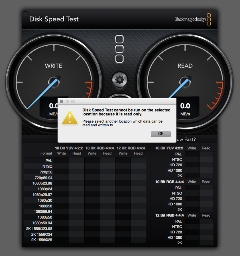

Just installed My new 256GB XP941. I wonder, with Blackmagic and Stress 1GB test I get only a read spead of 120 MB/s. Write speed is up to 740MB/s. Even with my SSD I'm getting 200MB/s read. I'm using 10.9.5 and a x4 adapter in slot 3.
Is that a correct (max) value?
That is far from its best performance. You should get 800 read / 1100 write. Leave the test running and it should climb to peak values.

It climbs after some time. I just wonder, because my SSD is showing directly 200MB/s write speed even connected as a normal HD.

No way. Write speed looks about right. Read should be over 1000MB/s. My copy of Blackmagic has decided to get messed up so I can't show you my score. I get this
