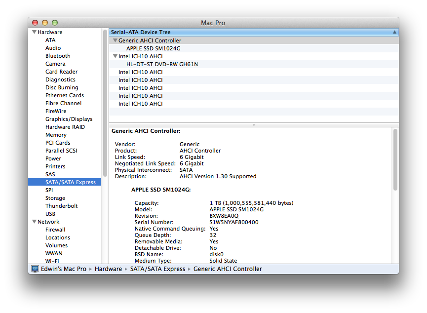

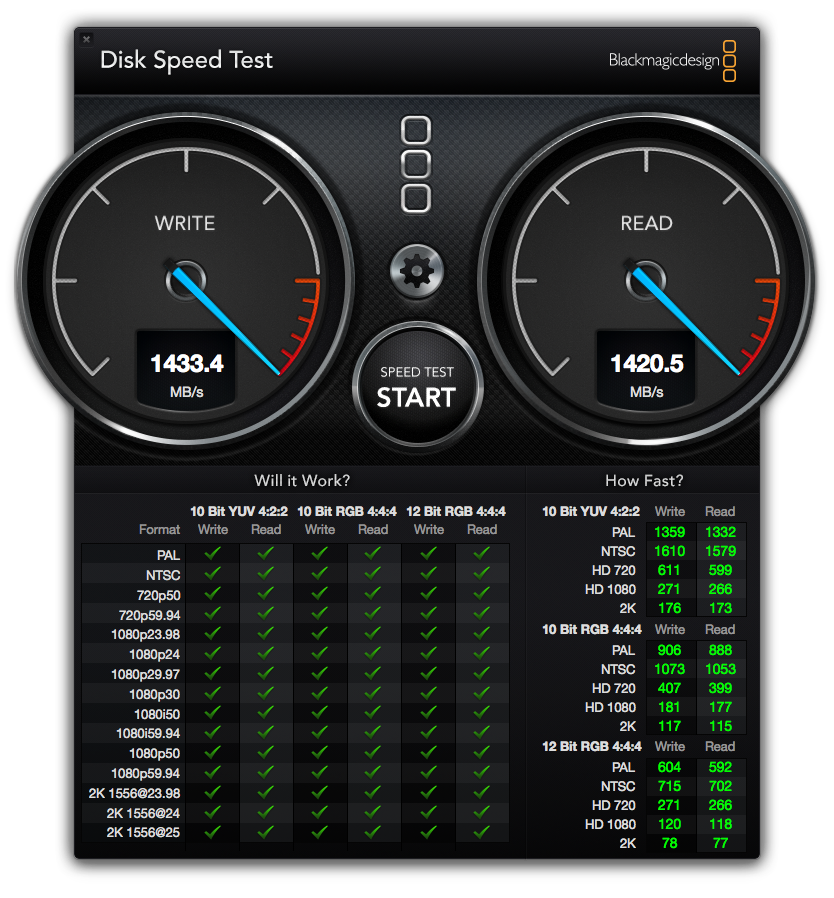

Finally I was able to test the MZ-KPV1T0R-OA2 which I received yesterday. There is nothing new here and I just wanted to share my excitement. I beleive this blade was new as advertised; it came in a factory sealed anti static bag and when I checked the smart attributes it read 0 under power on hours. Initially I did a Mavericks clean install with the blade in slot 2 just to test what others have reported about link speed of 2.5 GT/s only. Then I moved the blade to slot 3 and link speed went up to 5.0 GT/s. I didn't experience any problem with this blade and it was detected properly. With the blade in slot #2 cold and warm boot were both 14 seconds; with the blade in slot #3 cold boot was 18 seconds and warm boot was 13 seconds. I'm including snap shots of System Profiler Hardware Overview, PCI Cards with blade in slot #2 and then in slot #3 and SATA/SATA Express readings which was the same no matter where the blade was installed. The final snap shot is from Disk Speed Test.
Nice results. I guess I should have went for the 1TB model, but the truth is I don't need that much storage for my boot drive so I didn't want to spend the extra $$. I've go so many storage and scratch drives, I just wanted native trim and faster booting. Well, at least I got the native trim and very fast everything but booting 🙂. I'll live with it...

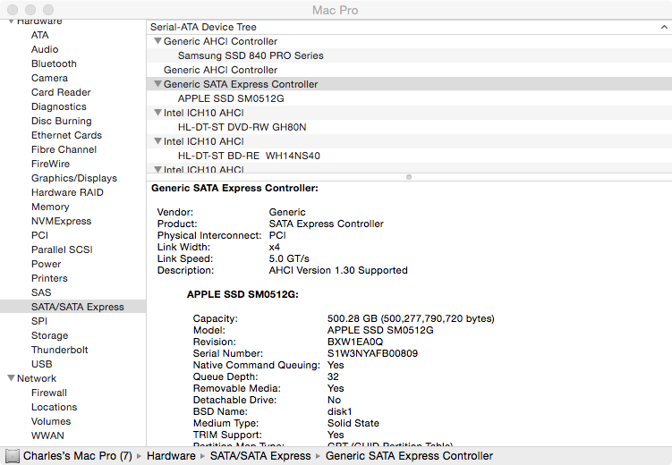

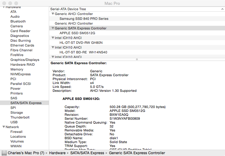

Notice the difference in controllers. Yours says Generic AHCI Controller where as mine says SATA Express Controller. The cMP firmware knows how to deal with AHCI but SATA Express seems to confuse it. I'm guessing that SATA Express didn't exist when the machine's firmware was created, so it has issues.
In my last testing with MZ-KPU1T0T/A06 (see post # 921) the controller was the SATA Express Controller but that was for that SSUAX blade. With that blade cold boot were about 25 seconds and warm ones were 11 seconds but write speed was 923 MB/s and read speed was 881 MB/s max. Would you be happier with these numbers and boot times? I was not because I knew I could achieve better performance with this last blade and I think I'm going to stick with this particular setup for as long as I can.
