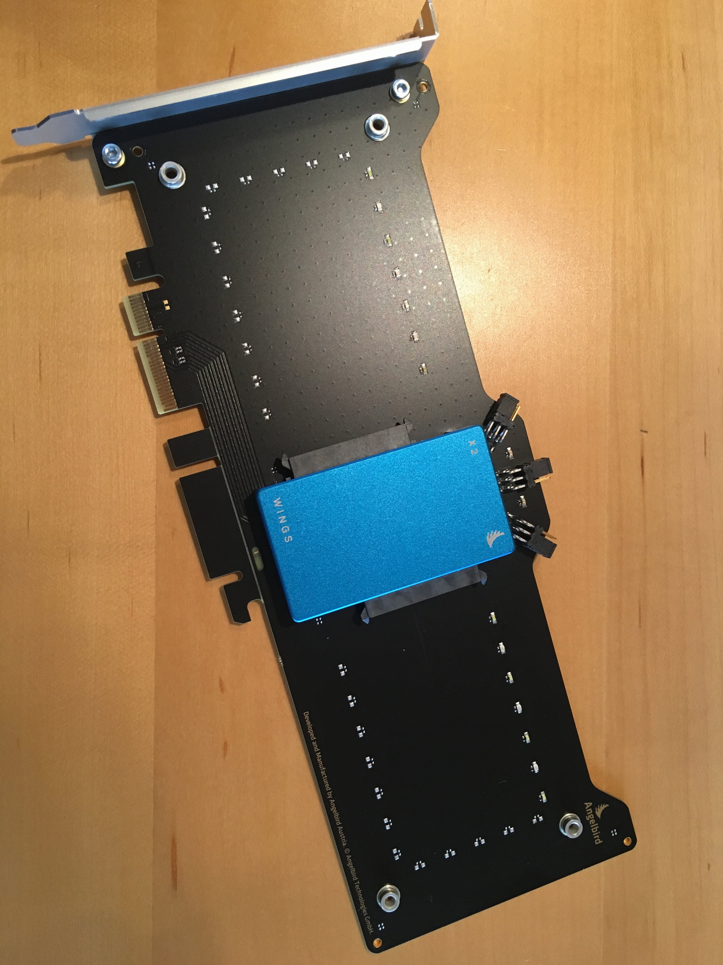

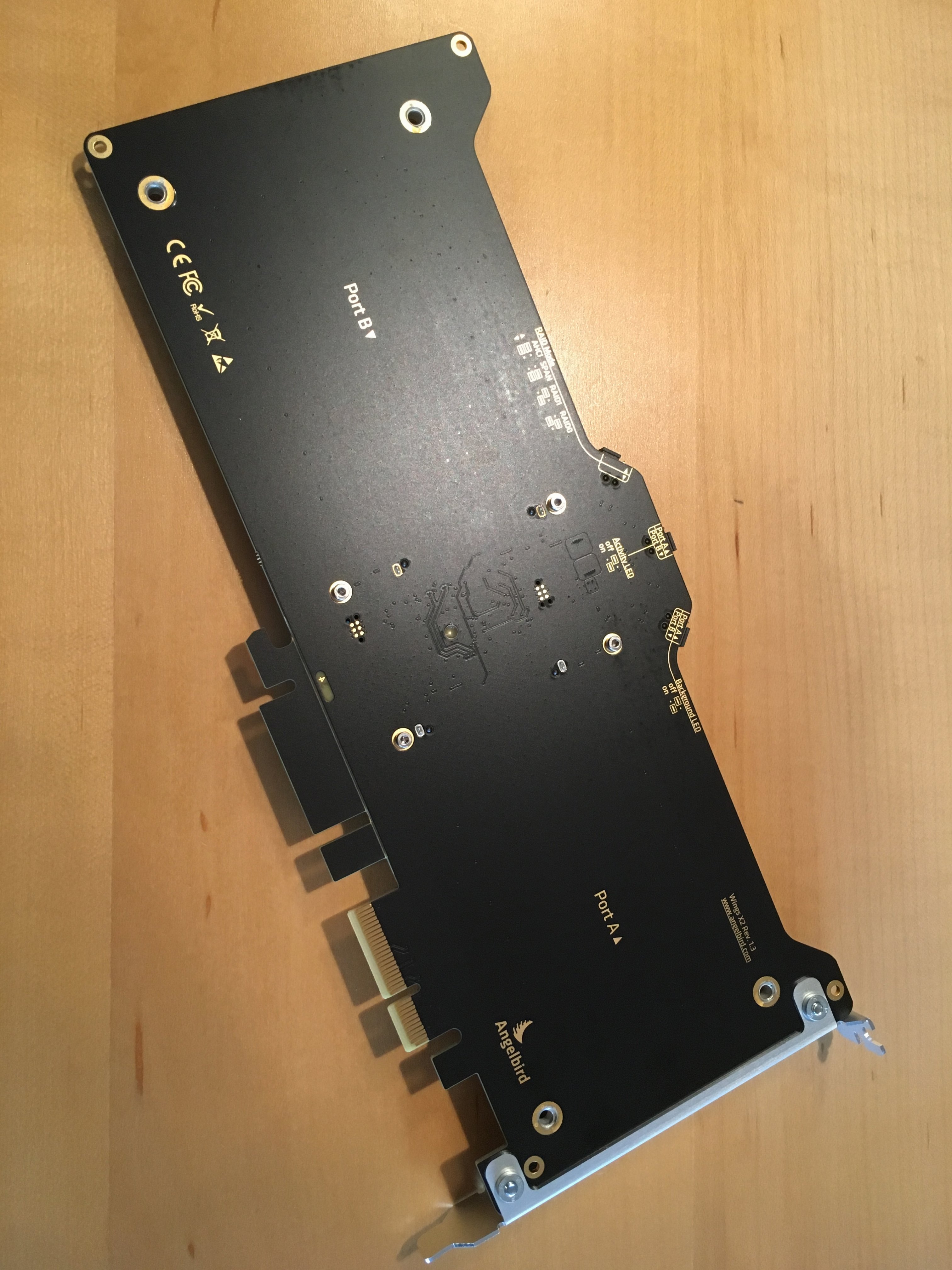

This might be of interest to some of you. I just received my Angelbird Wings X2 PCIe card. It supports several RAID modes, speeds up to 950 MB/s and is bootable. The MX2 card is also available for ordering.
View attachment 625648 View attachment 625651 View attachment 625652 View attachment 625653

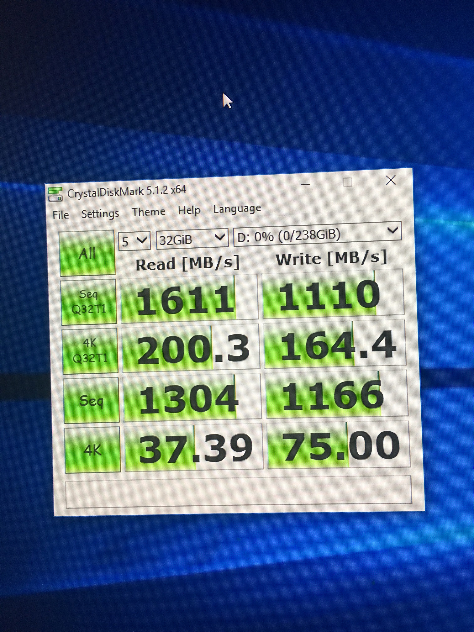

I've tested both in Windows 10 in UEFI mode and macOS and both systems and cards perform to their full capacity. AJA shows 900MB/s write, 1100MB/s read and 10GbE network transfers hit 1GB/s when pulling from the SM951 which I've now moved to my VMware server.
I also tested latency in Windows 10 using LatencyMon and found it to be very good (low).

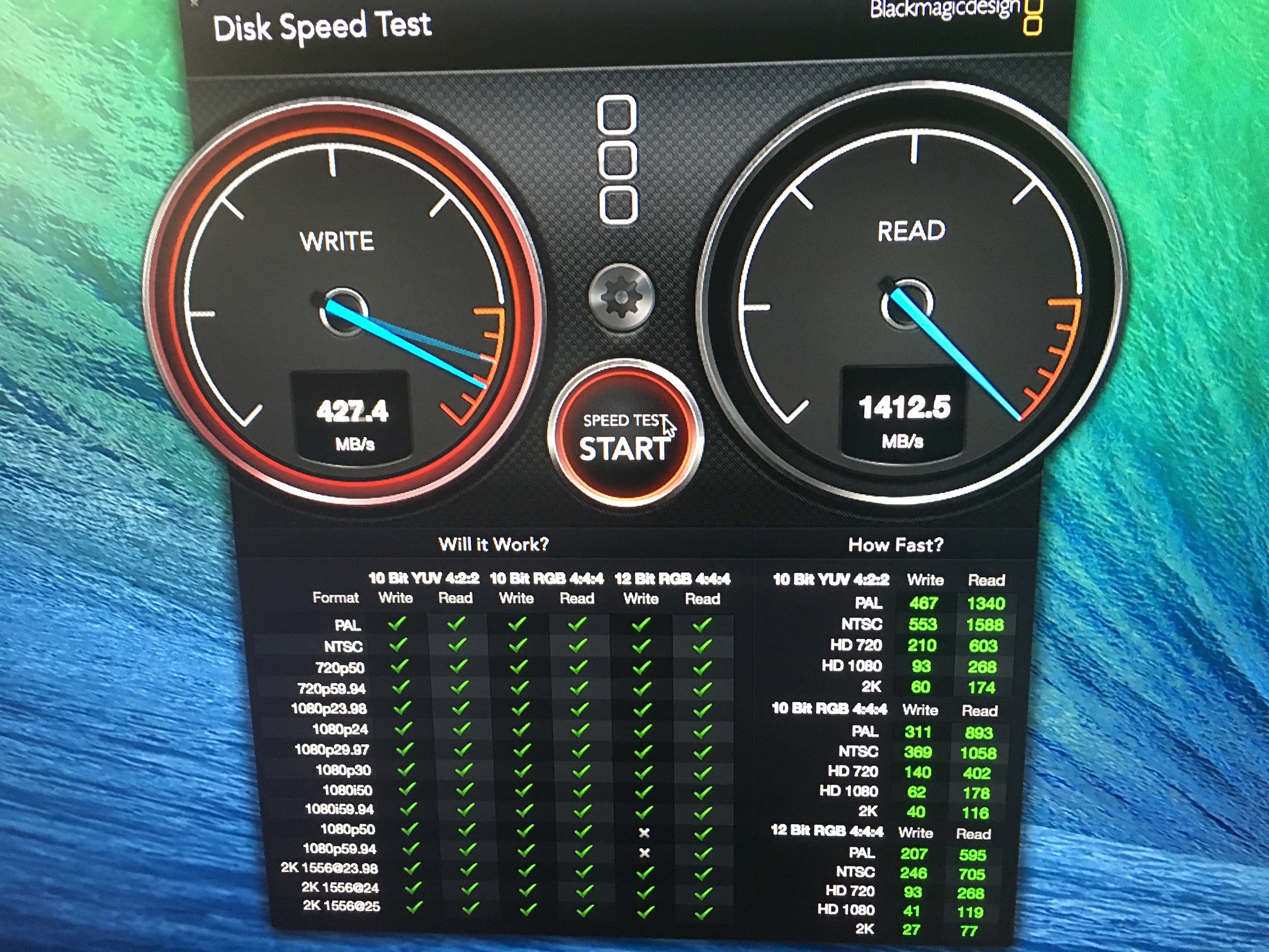

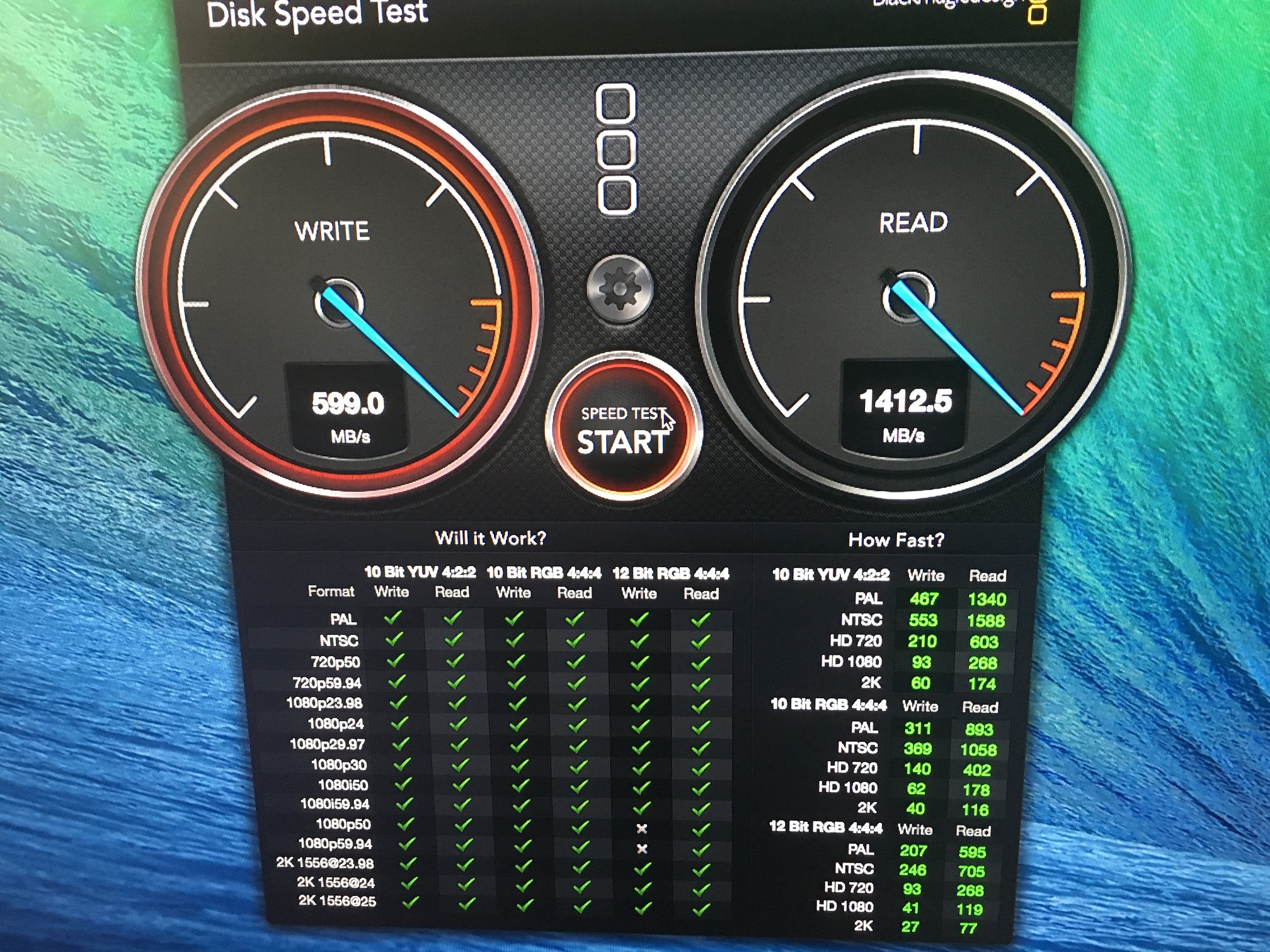

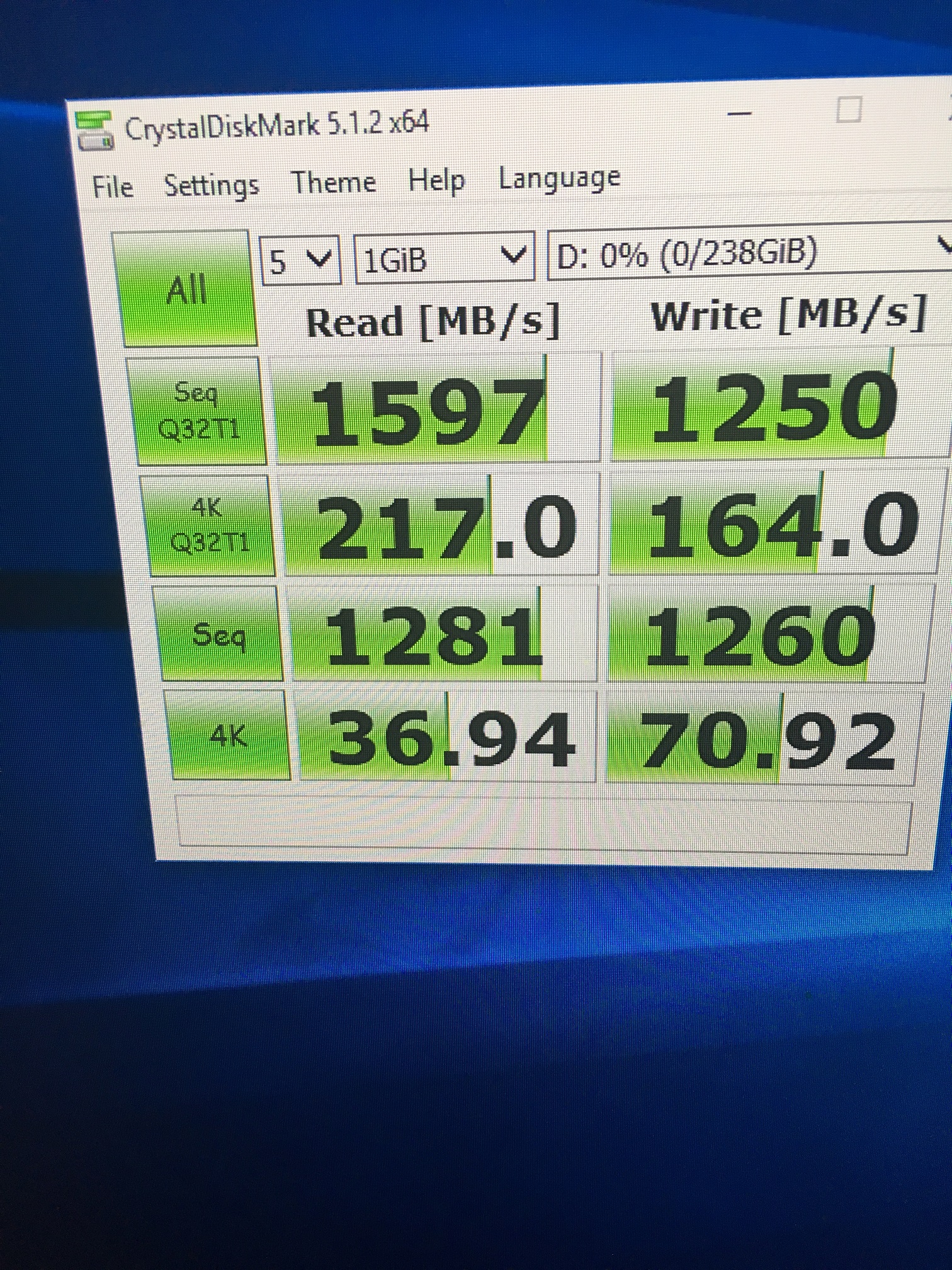

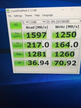

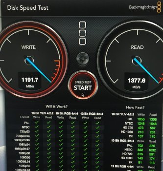

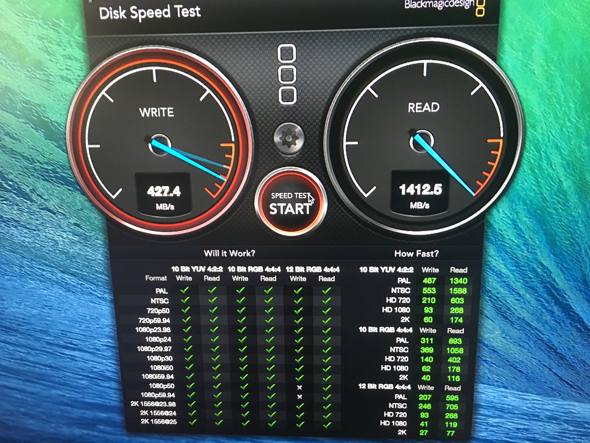

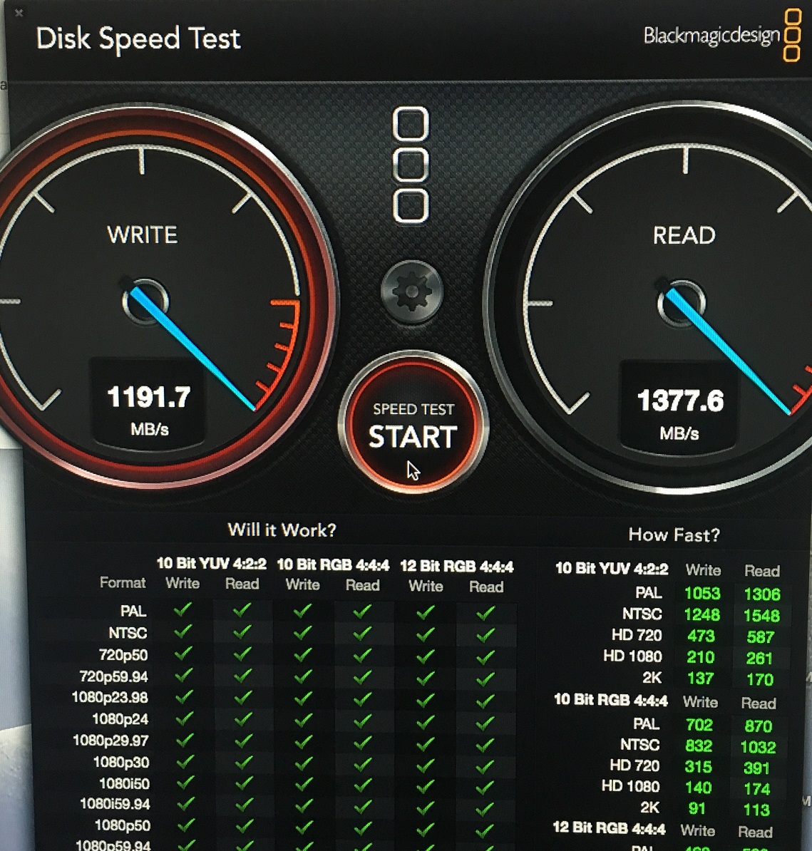

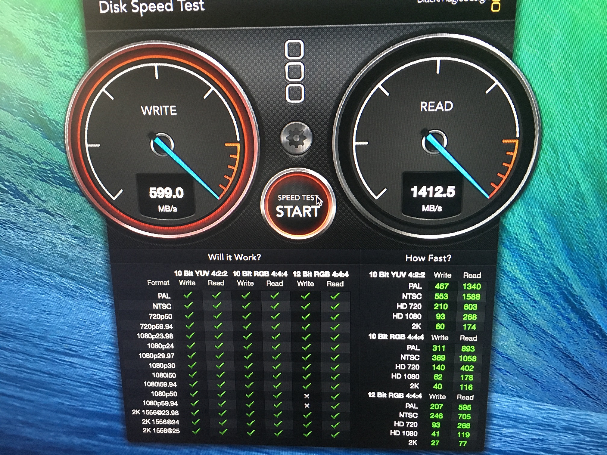

I'm having a Very strange problem with two of my mac pro 5,1 computers using sm951's. Both have a 256gb sm951 with a lycom adapter. When i first got them everything was good, they both maxed out in the 1500mbs range now when i do a speed test im getting 200mb write and 400mb read and its fluctuating alot.
At first I thought maybe the card was bad so i switched them, nothing changed. So then i swapped ports, again nothing changed. After that i moved the card to my other mac pro and again nothing changed. So then i thought maybe my card went bad. Well then i ran a test on my second sm951 in my other mac pro and it also has very bad read/write that acts the same way as the other one. Either i have two defective sm951s or two defective lycom card, or two defective mac pro motherboards.
These sm951s are have a 3 year warranty so if there bad ill have to figure out how to redeem them, but what i dont understand is that one of my mac pro's had the new drive installed and only ran for a month (then put in storage) and when i decided to use it again the hard drive is showing up real slow in black magic.
Has anyone else noticed this problem? Is there any other reliable hard drive test outside of black magic? The fluctuation is pretty high range, it gets fast and slow but my write never goes above 600mb when letting it test over and over again.
I've included some photos. These were in slot 3 and the same drive. I would post photos of the second drive on the other mac but it acts exactly the same way. I'm wondering if the lycom cards are bad or something else is going on.

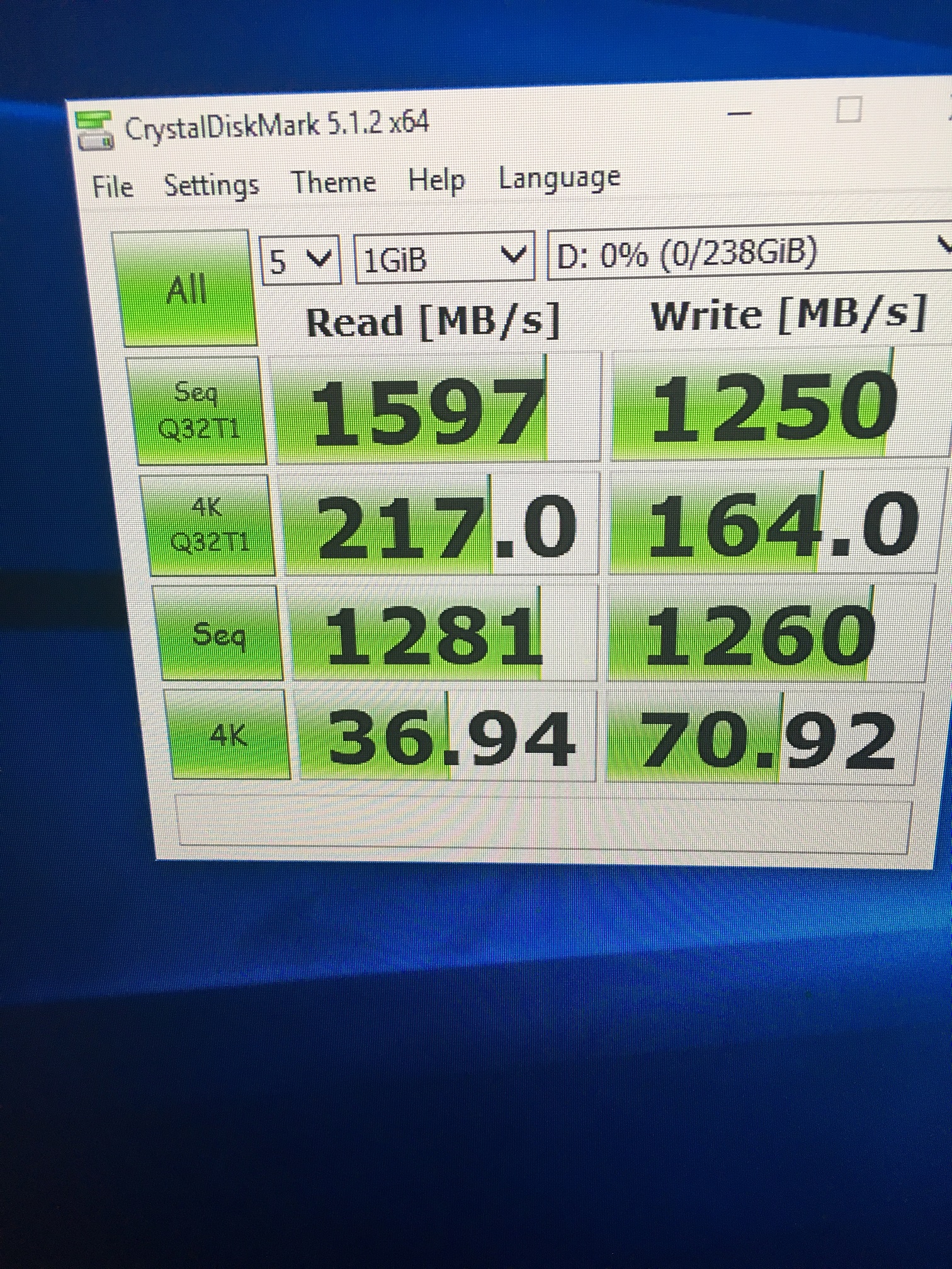

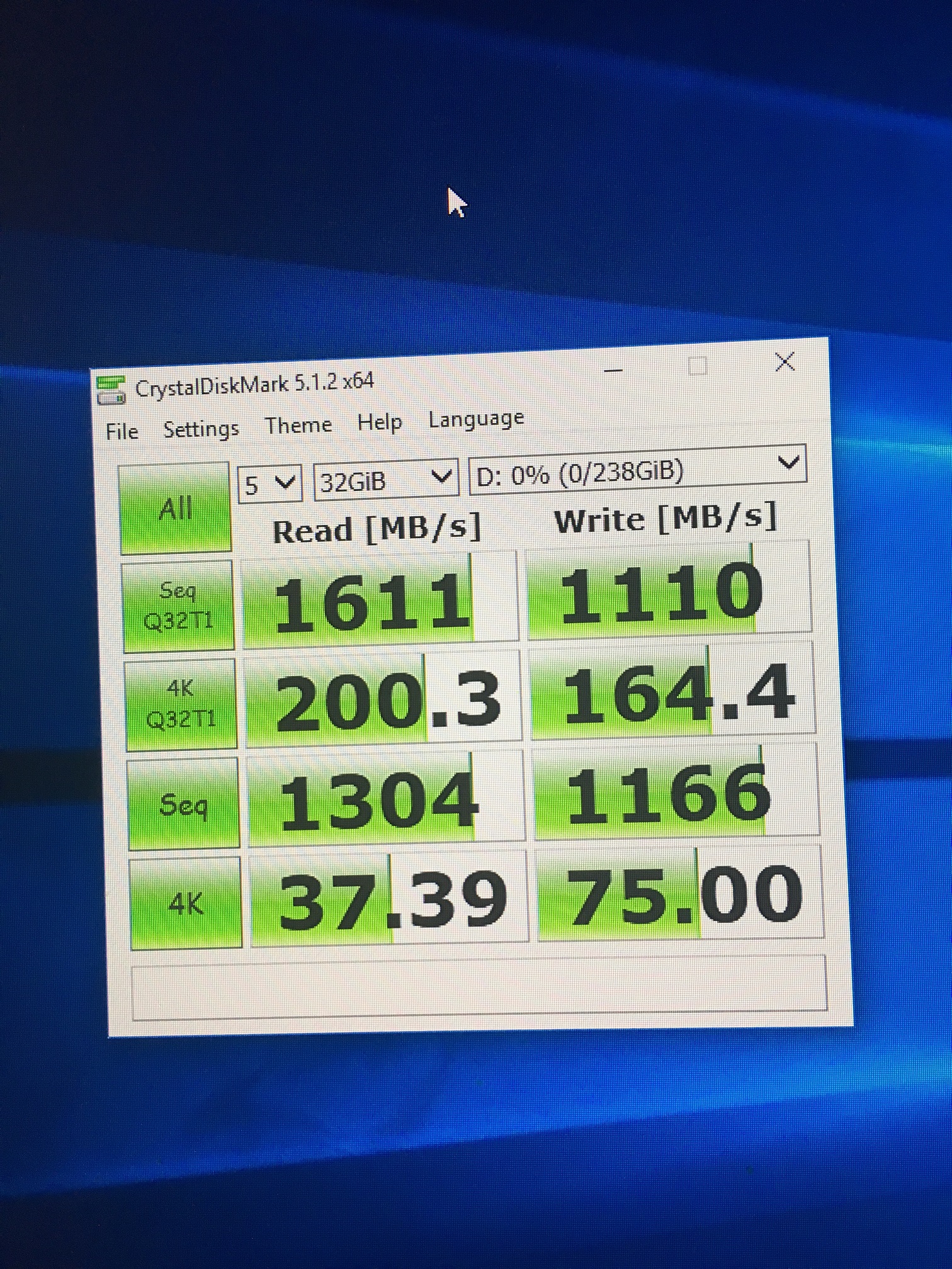

Did you pick the 5GB size for the rest?

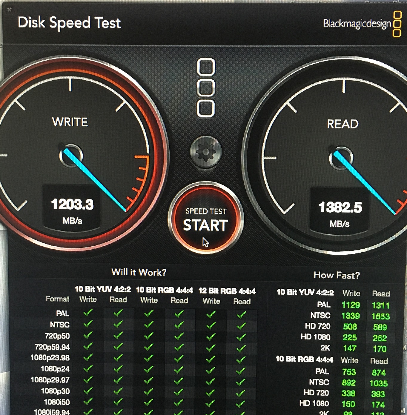

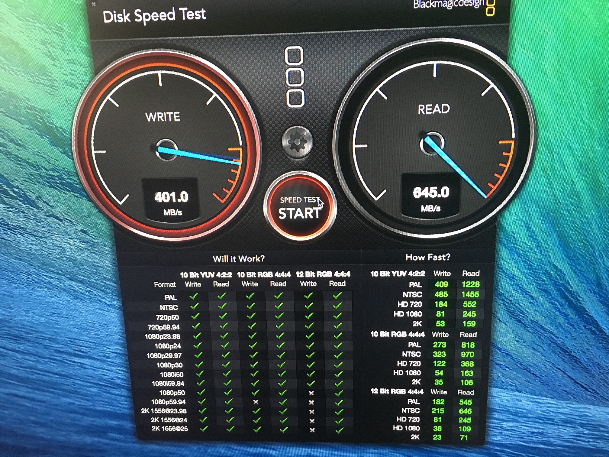

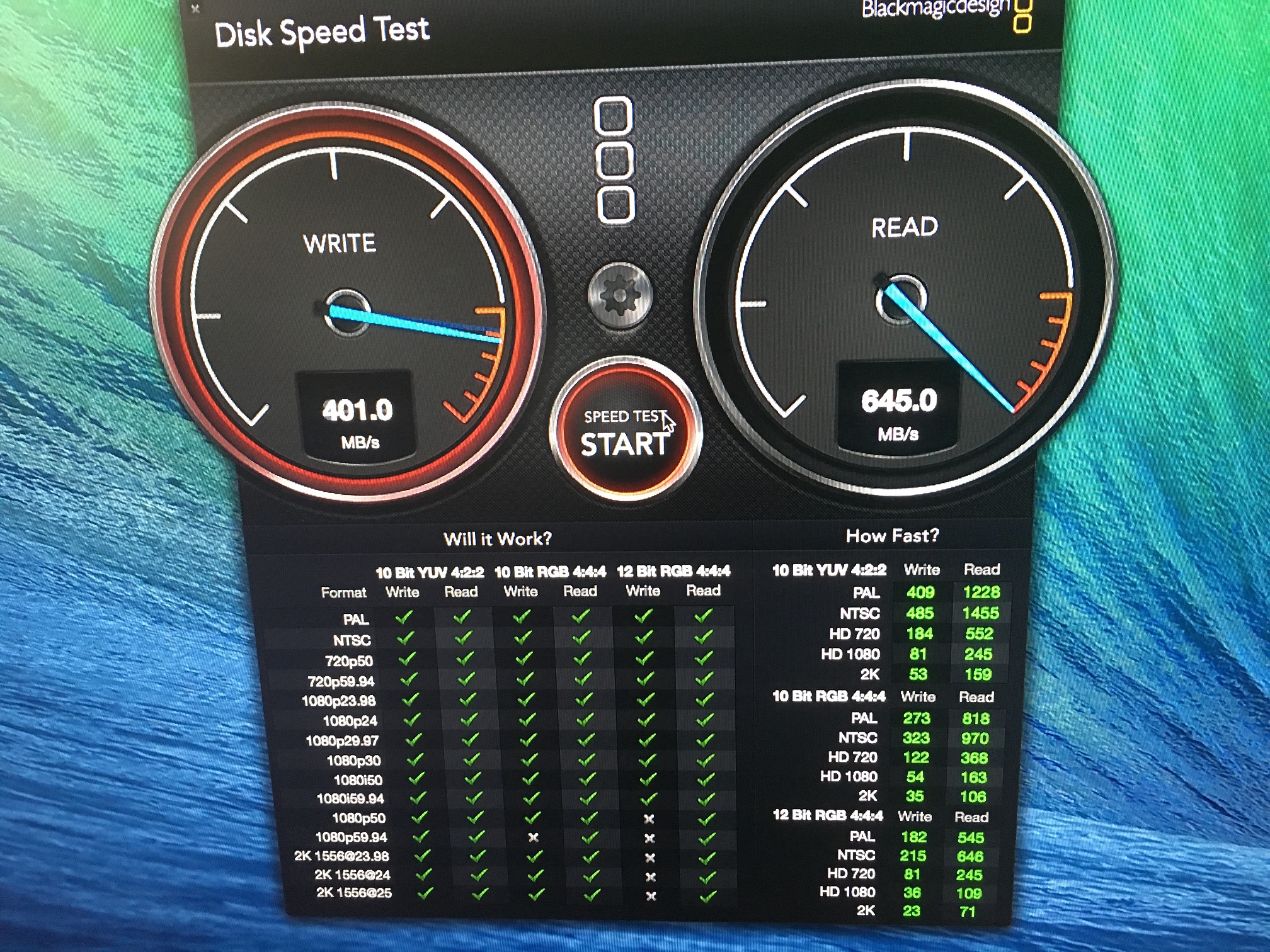

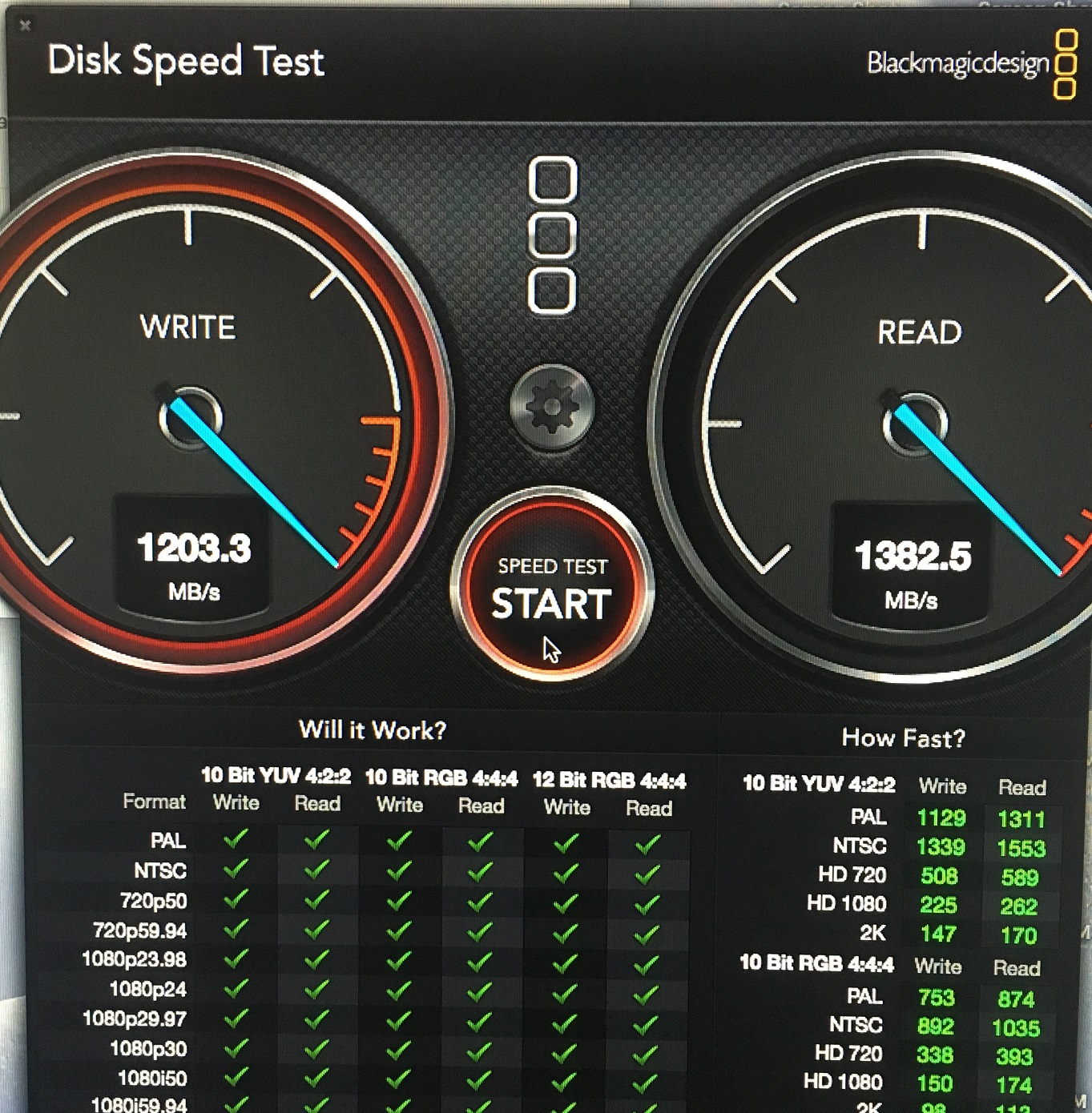

I did the 5gb test I also just got finished running some more tests. I deleted one of the drives then formatted it as ntfs for windows and ran a test with disk mark 1gb and 32gb test. I then reformated that drive as OSX journaled and now im getting full speed again. So im lost as to what the problem is outside of the disc slowing down when osx is installed on the hard drive. I also find it strange since I actually did a fresh install on the drive before i erased it to test it on windows. I'll go ahead and re-add osx and retest.
Based on the new tests its not a hardware problem.
Well i reformatted it again and its now working great. Full speed and everything. Im going to reformat my other desktop as well, i guess they slowdown overtime for some reason. Still a little confused as to why it was slow on a fresh install earlier. Maybe formatting it as ntfs fixed it. I guess ill find out when i re-do the other one.
Did you boot Windows - since Windows supports TRIM on any drive that self-identifies as supporting TRIM?
