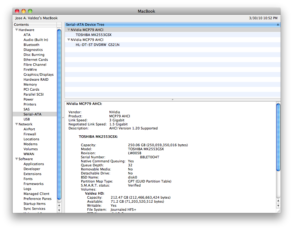

I think its funny how everyone is wishing that their 1.5 Gbps drives were still falsely showing that they were operating at 3 Gbps, while I would love to be able to force my 3 Gbps drive to operate at 1.5 Gbps, without having to run EFI 1.6! Oh, the irony...

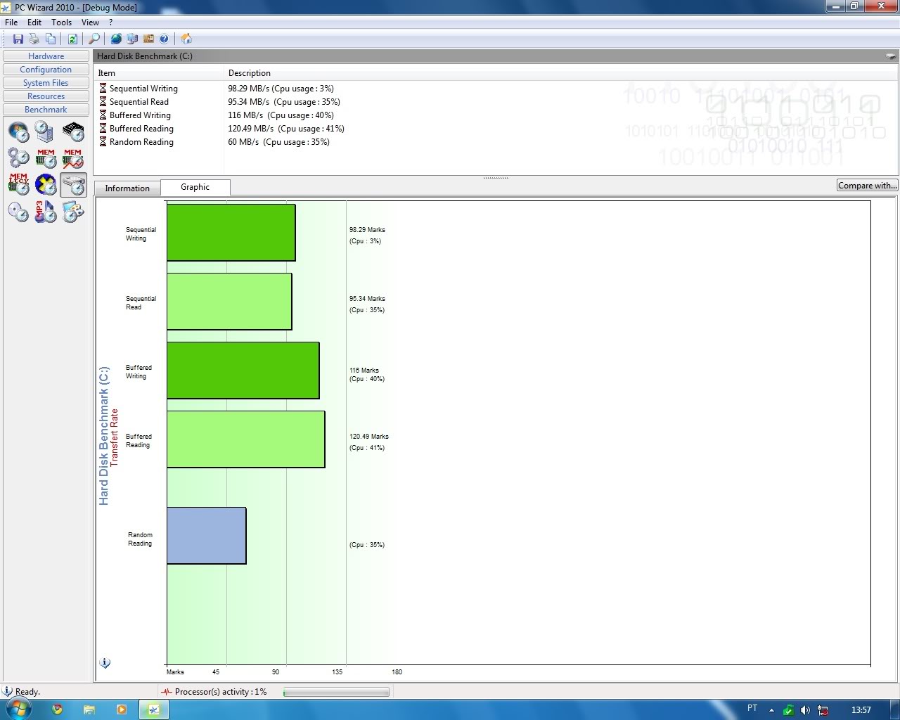

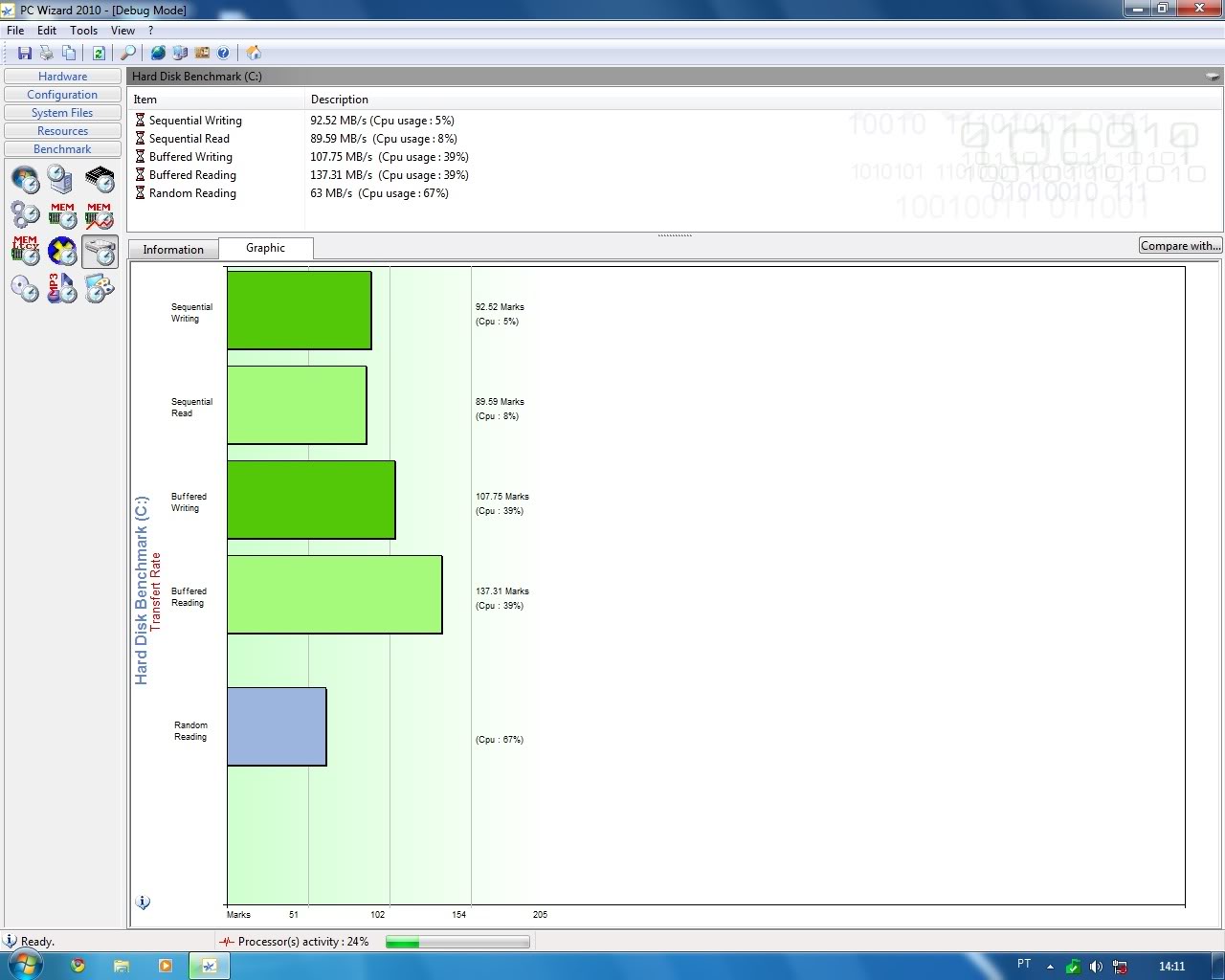

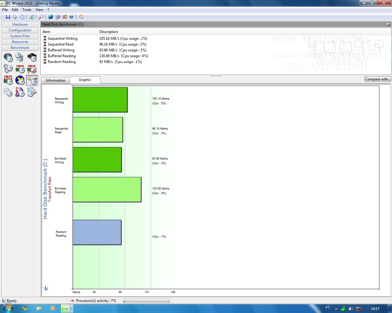

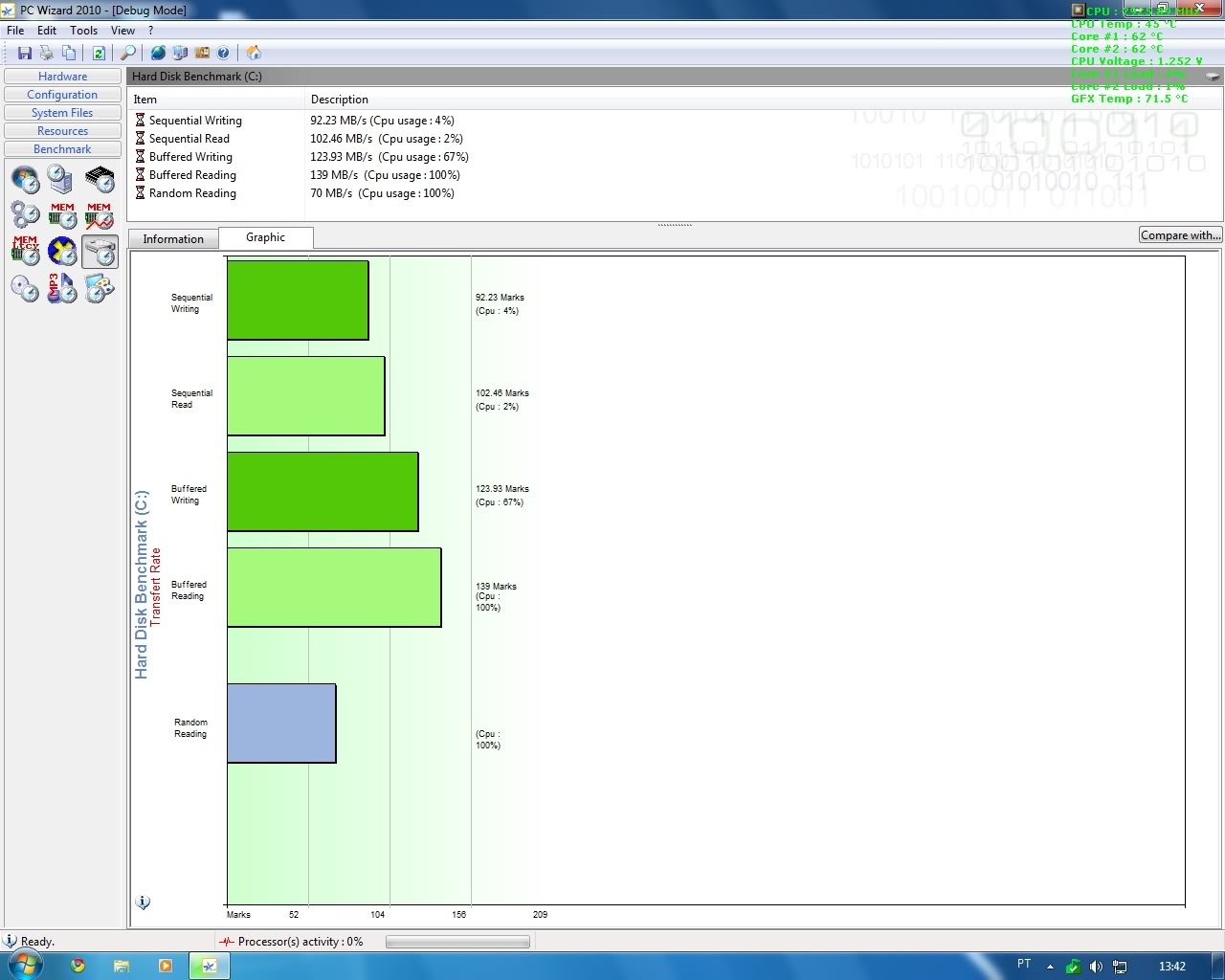

As everybody (including me) like numbers... results, i've mentioned before a benchmark, so here it is.
This benchmark was done in my desktop. It is not conclusive and as it's possible to see in the numbers, it is not reliable, it just give us an ideia of the whole thing.
It's important to pay attention in the hdd config in my pc:
2 x samsung 160gb HDD, RAID0 stripped in 64kb block size;
JMB36X RAID controller connected with 1-Lane 2.5Gbps PCI Express bus
So, as it is a pcie controller, the results in the benchmark may be affected by the max transfer rate between the raid controller and the motherboard chipset.
General results:
Sata 1 test 1
Sata 1 test 2
Sata 2 test 1
Sata 2 test 2
Sata 2 test 3
The results don't back your claim that there's a significant speed difference with the drives in use for SATA I or SATA II.
yeah, i could see that.

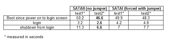

but, the best way to get more reliable results, is to benchmarch a sata 2 hdd on the macbook, an then, limit its speed using jumper to sata 1 and compare the results.

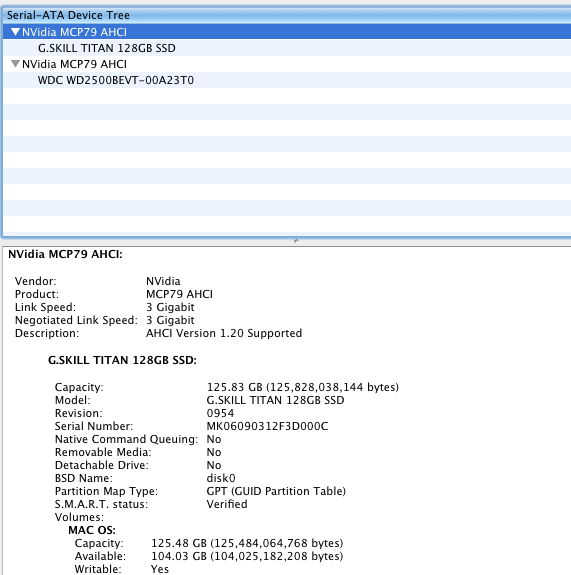

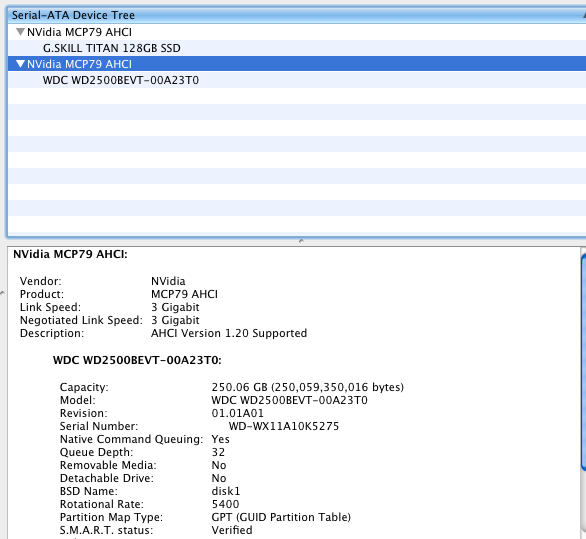

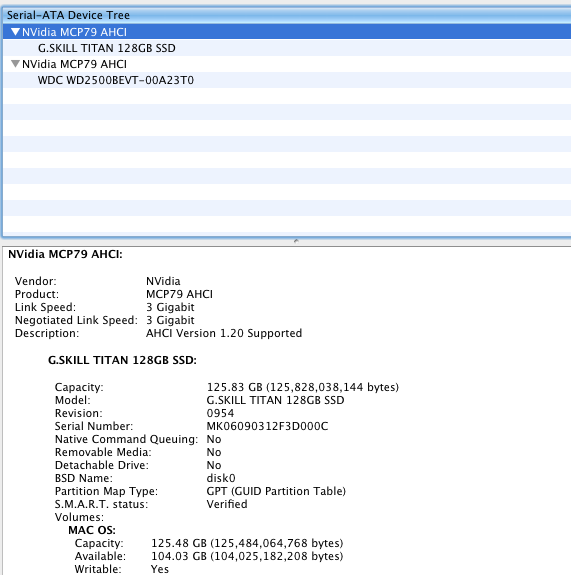

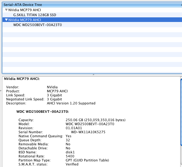

It's a nice theory, but not factually accurate. My 250GB WD Scorpio is 5400 RPM and there's no way in hell it can hit close to the 350++ MB/second it would require to saturate the interface. It can't even hit the 175+/second it would take to saturate the SATA I interface.
Yet it is linked @ 3 Gbit/second. See attachments.

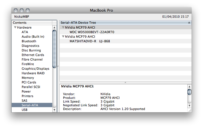

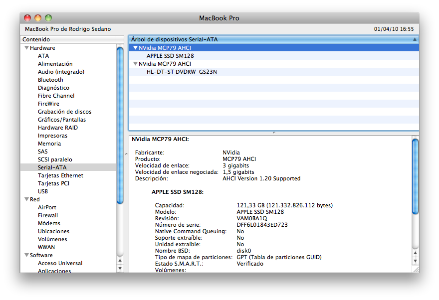

I understand what you're saying OldMike, and that makes sense -- when it comes to mechanical HDD drives. Since they can never reach above SATA I speeds, plus SATA II has reliability problems with the Nvidia chipset (why only on Mac's BTW ??), what harm is keeping it at SATA I. Idealy Apple/Nvidia would just fix the Mac firmware and Apple would not need to disable the SATA II capability of its stock HD's.
However, when it comes to Apple-supplied SSD's, why on earth would they force them to SATA I?? SSD's are the one thing that can use above SATA I speeds. And according to djrod, he has an Apple-supplied SSD (which are only Samsung SSDs last I heard), yet STILL has it forced to SATA I speeds... Why??
Screenshot of the About this mac page:

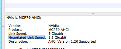

I know my drive isnt 'top of line' but it appears its running at 1.5Gbps as well.
Early-2009 MBP 17" 2.66 320GB
NVidia MCP79 AHCI:
Vendor: NVidia
Product: MCP79 AHCI
Link Speed: 3 Gigabit
Negotiated Link Speed: 1.5 Gigabit
Description: AHCI Version 1.20 Supported
FUJITSU MHZ2320BH FFS G1:
Capacity: 320.07 GB (320,072,933,376 bytes)
Model: FUJITSU MHZ2320BH FFS G1
Revision: 00810091
according to fujistu...er toshiba's website it states it may run at 1.5Gbps or 3Gbps.
http://sdd.toshiba.com/techdocs/MHZ2xxxBH.pdf
http://sdd.toshiba.com/main.aspx?Pa...MHZ2xxxBHSeries/MHZ2xxxBHSeriesSpecifications
I plan on throwing in a 640GB WD anyway...so that will probably change.
but interesting to know!
