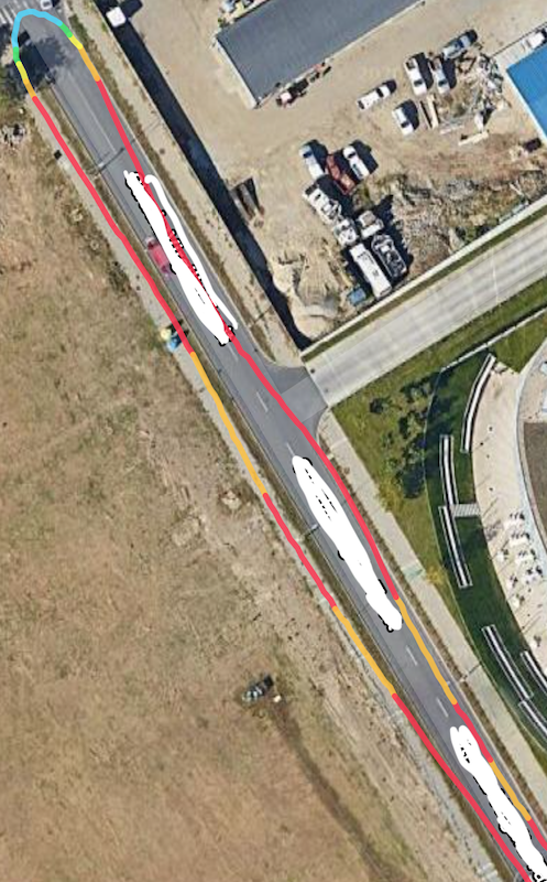

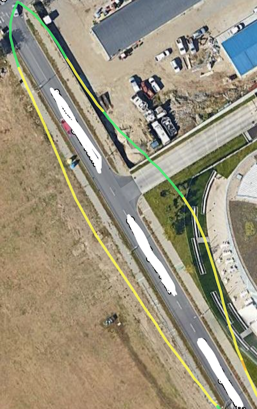

yea, well for me i wasn't really interested in checking compass app elevation accuracy, but more to have accurate GPS tracks of workouts, which i know AW6 is capable of. Well, it is, if it's not using the phone GPS, which mario-karts it and cuts corners all over the place.
So accurate, constant compass elevation values are a nice byproduct of having accurate gps tracks.
Until Apple fixes this crap, airplane mode is the way to go for me.
So in your opinion the watch if not airplaned uses the phone GPS? Are you sure of it? Have you made some tests, with and without the airplane mode on same track to see differences? Interested because if so I have to exclude the phone too...
yes.
airplane mode or without having the phone nearby yields the same effect: perfect gps track and workout metrics.
when using phone gps the track is "looser", less accurate and mario-karts around corners. Looks like it's also polling the gps less often, meaning graph is either extrapolating trajectory between less gps readings or it's simply less accurate (which i doubt).
do some outdoor walk tests yourself and see the difference.

yes.
