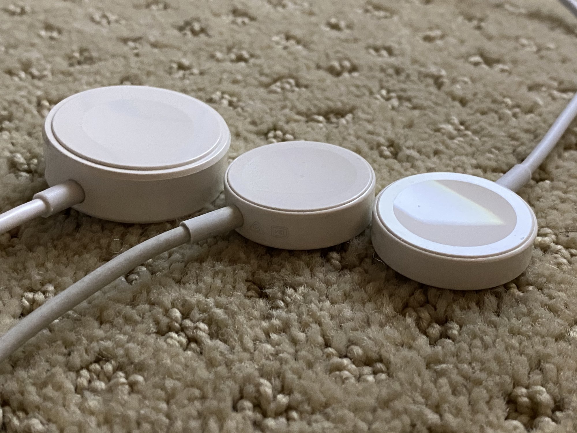

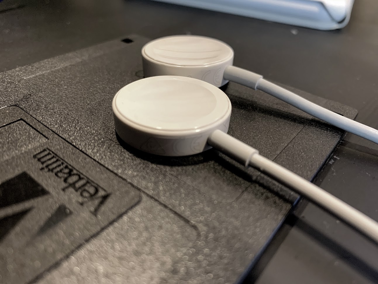

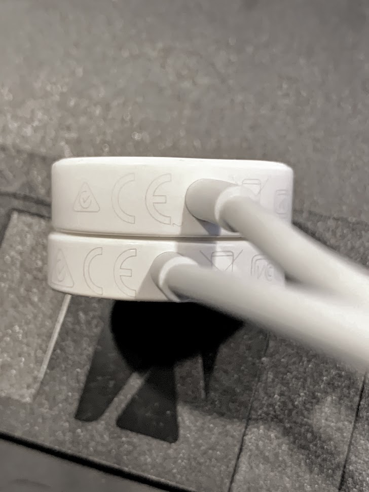

This is a comparison photo of my older fatter Series 4 charger and the new thinner Series 6 charger.

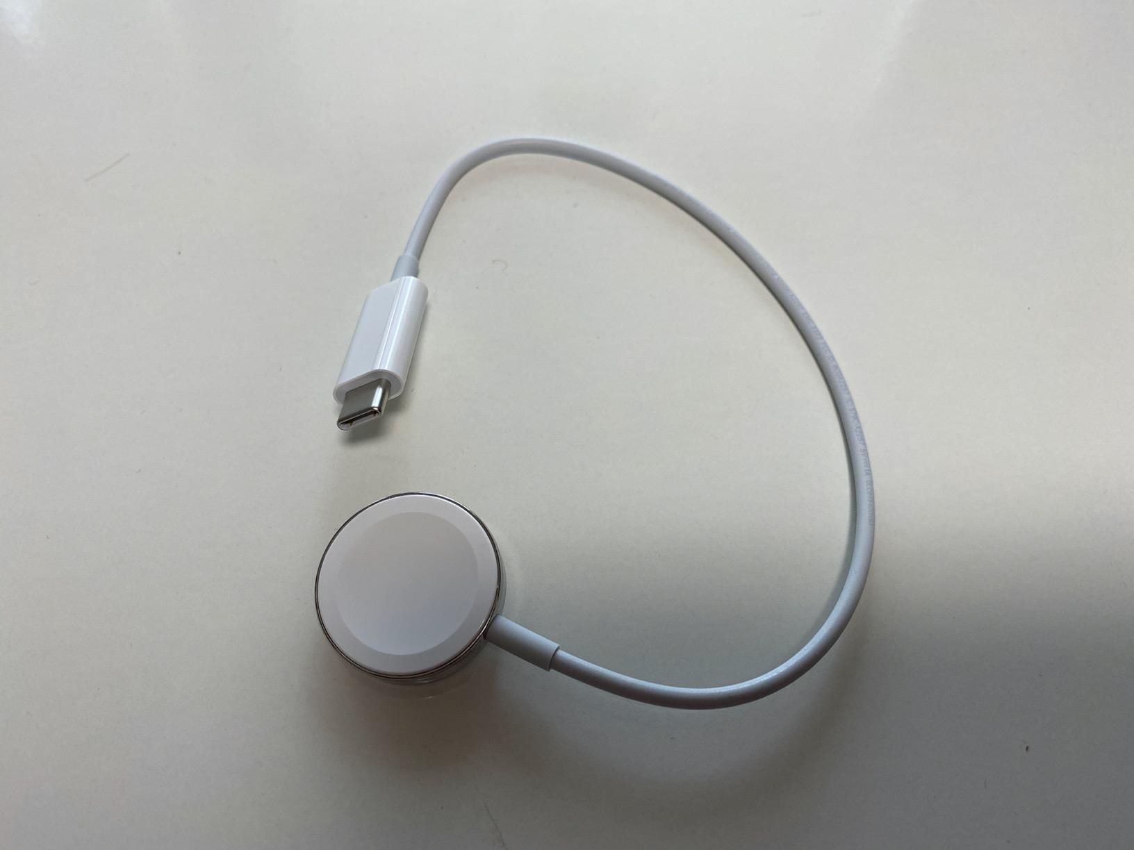

And I have just ordered two new original Apple Watch USB-C charges from Amazon (modelno. A2257). They are priced 34.10€ per cable on Amazon.de 🥴 Total 68,2€ ($80,99) for two cables (1m and 0.3m)

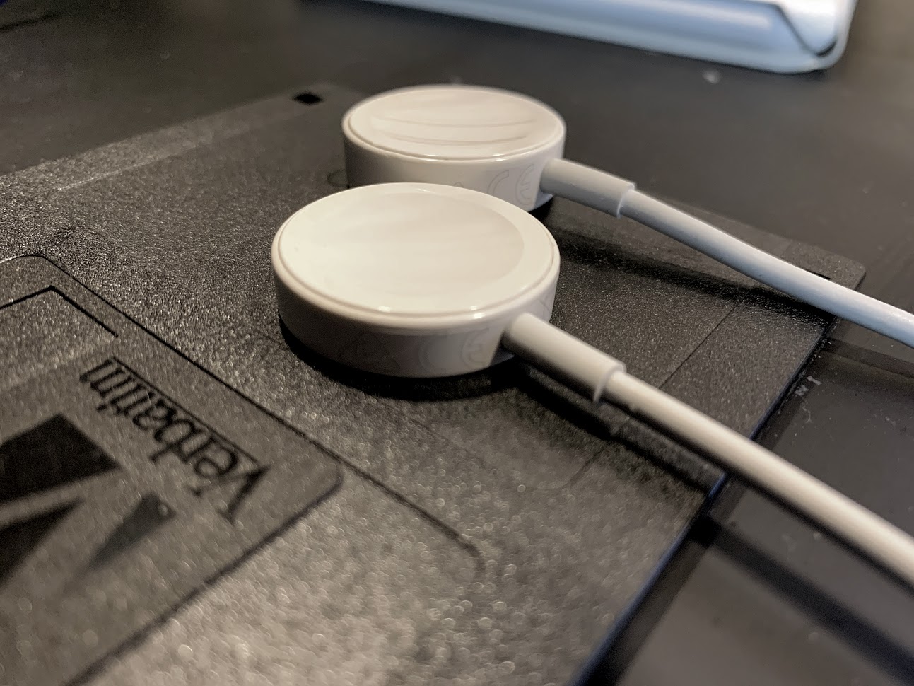

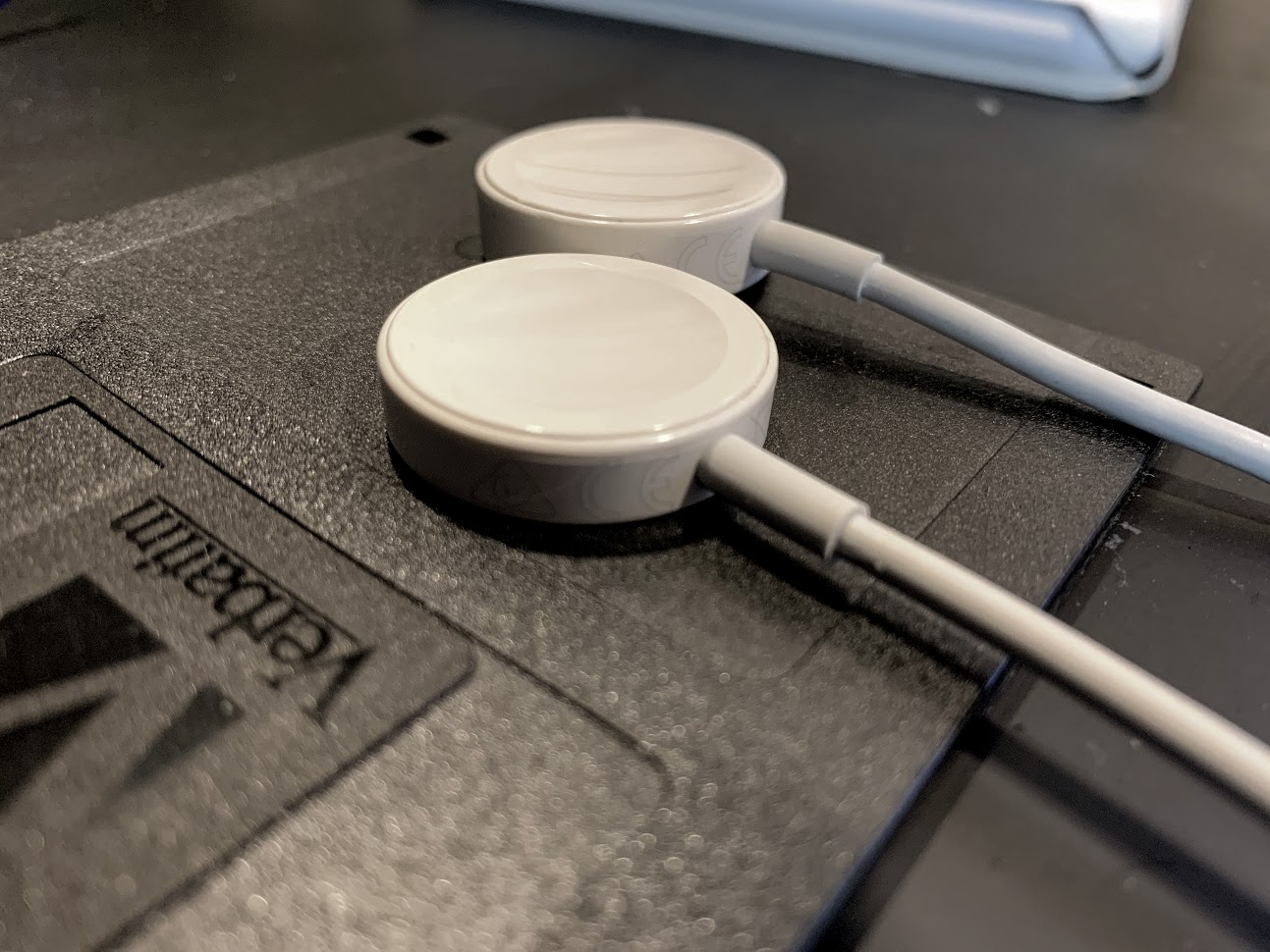

View attachment 959704 View attachment 959705

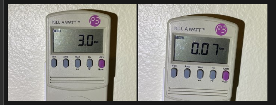

The Apple Watch won't pull more than .07 amps and 3 watts. At least in my tests - plugged into chargers that can do 2.4a and 12w+. I tried 3 different charging cables.
Is that 0.07A at 120VAC I presume?
... because 3W at 5VDC is more like 0.6A -- which would translate to lower amperage on the 120V side. Though I get 0.025A @ 120VAC on a basic calculation, so there must be a bit of inefficiency in the 120VAC to 5VDC adapter.

Yeah USA California - 120VAC.
I had it plugged into a 6 port Anker 60w adapter. It registered 0 watts and 0 amps when watch was off the puck. Pop it on the puck, it took 20-30 seconds to get up to .07a and 3 watts. (Slowly incremented from 1.3w to 3).

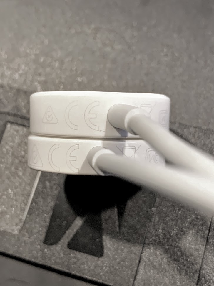

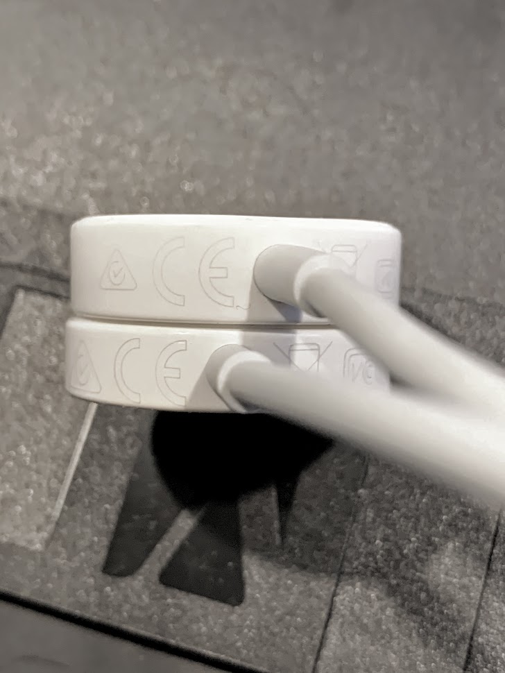

and for what it's worth, looking at my S5 and S6 charger pucks, there's no discernible visual difference.
