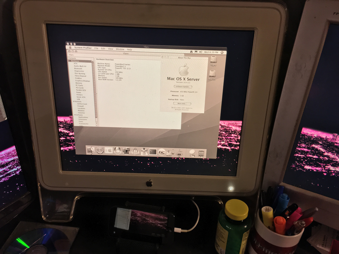

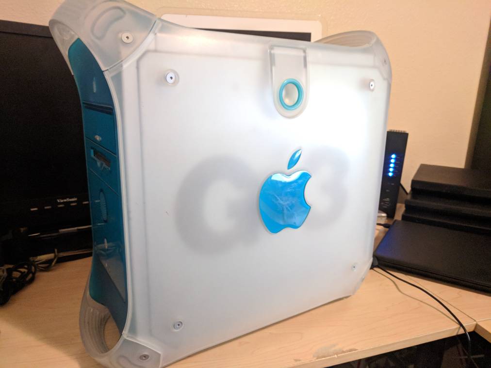

Thanks to the generosity of a forum member, I now have a 450mhz PowerMac G3 running OS X 10.4.11 Server.
I have a Firewire drive dock on the way and then this Mac will be handling my Time Machine backups as well as any other server uses I can put it to.
1GB Ram, 1x40GB HD, 1x120GB HD.
PS. I have it running headless, i.e, no video card and accessible visually only through VNC.
Yet again, OSX VNC for the win with it's ability to load VNC sharing before the login window!

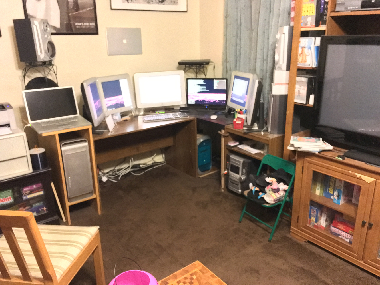

My setup goes:
> NBN modem with WiFi (5ghz) n network
> Mac Pro picks up the WiFi and reroutes it over Gigabit to a 5 port switch.
> The Gigabit switch is connected to 4 towers (Mac Pro + 3x G5s)
> the 5th port is connected to a 10/100 5 port switch, which is connected to other non-Gigabit devices (G4s, Mac mini, AppleTV or lesser machines
> I’d normally connect the laptops over WiFi unless doing time machine backups. I’ll plug a Gigabit capable PowerBook (15, 17”, TiBook) into a gigabit port, otherwise fall back on the 100mbit.
My ad-hoc setup is not perfect, but it’s fine for me and I can take advantage of GigE for high-speed local transfers where it suits me, but it has no impact or influence on the internet connection.
