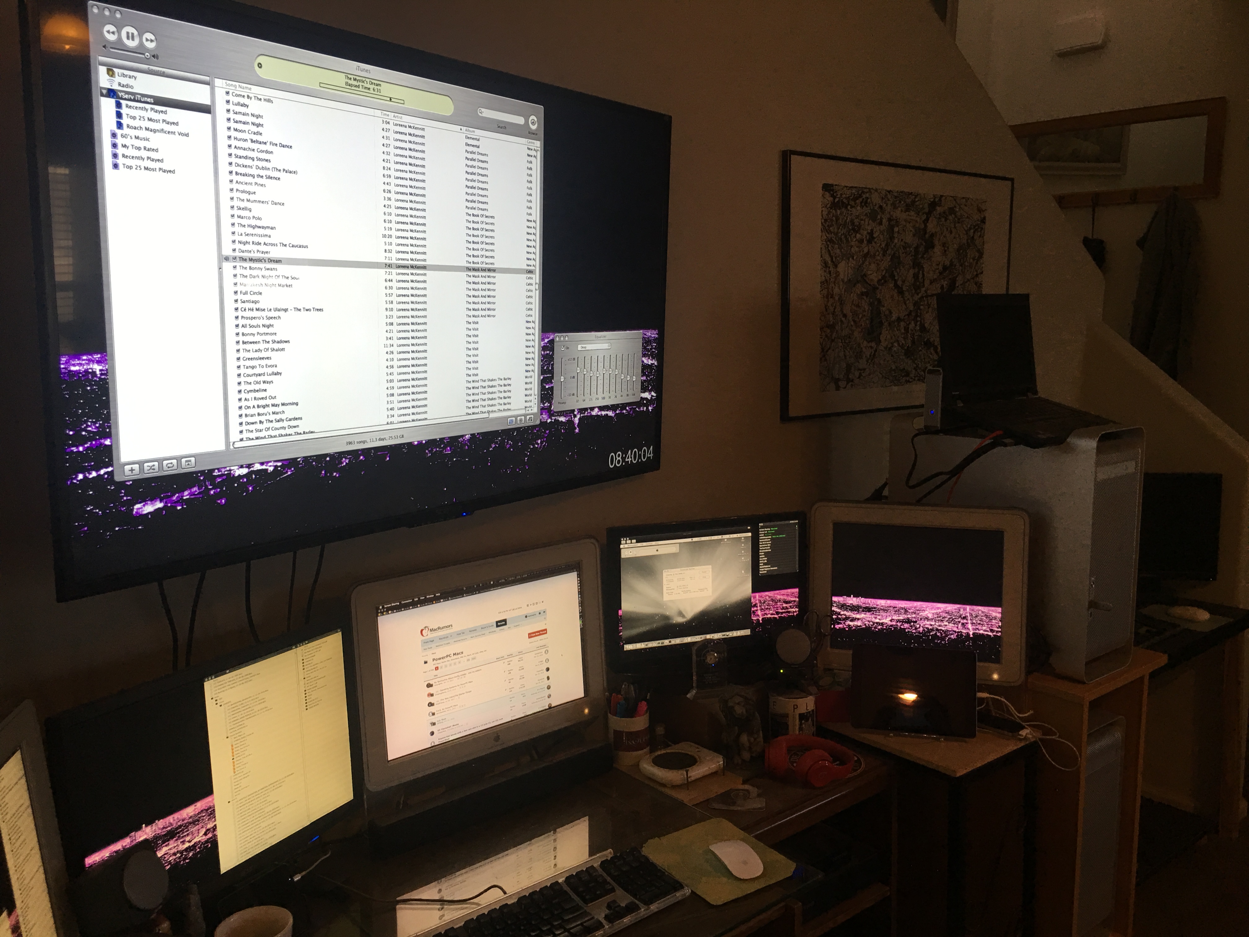

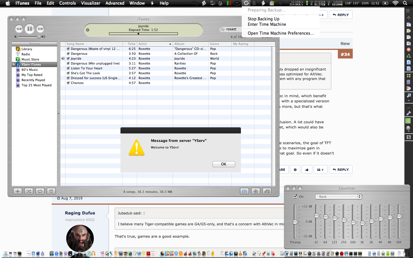

Server doing it's job. Streaming music to my Quad while executing a backup to the external drive connected to the PC.

G3 taking my 17" PowerBook TM backup while streaming the iTunes 4 library to the PowerBook. 🙂

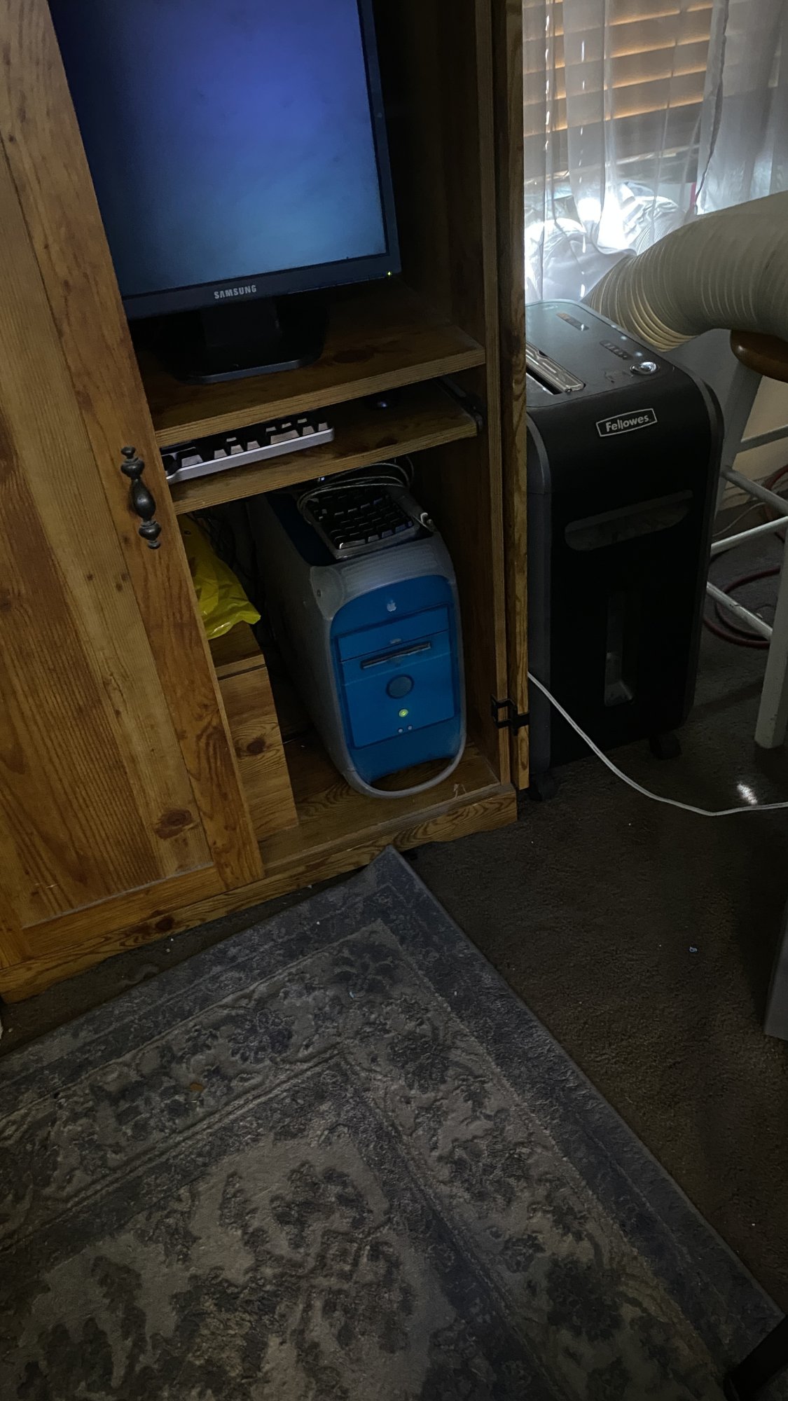

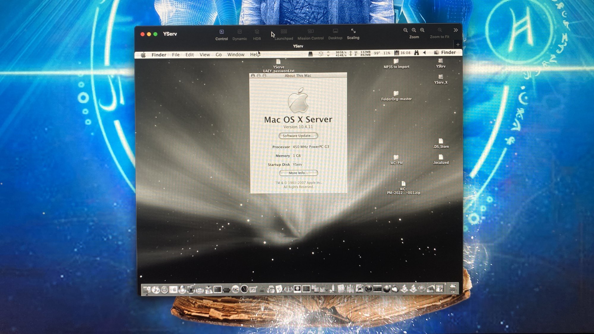

Server is back…
A couple years ago I took it down. At the suggestion of another member I had shifted PCI cards and was experiencing kernal panics when rebooting.
Today it was working fine. But the MOMENT I had a NIC reinstalled and ethernet cable plugged in I got a KP on boot. So, I shut it down and rebooted with the cable unplugged. No KP.
Hmmmmm…
So, for whatever reason this was the problem. It KPs whenever there is a boot with the network cable plugged in. After plugging the cable in AFTER it fully booted - no issue. Weird. But, well problem solved. Two years or so later.
I timed the Mac to full boot without the cable plugged in. Around 50 seconds to the desktop. If I have to reboot again, I know that I have to give the Mac at least 50 seconds minimum before plugging the cable back in.
