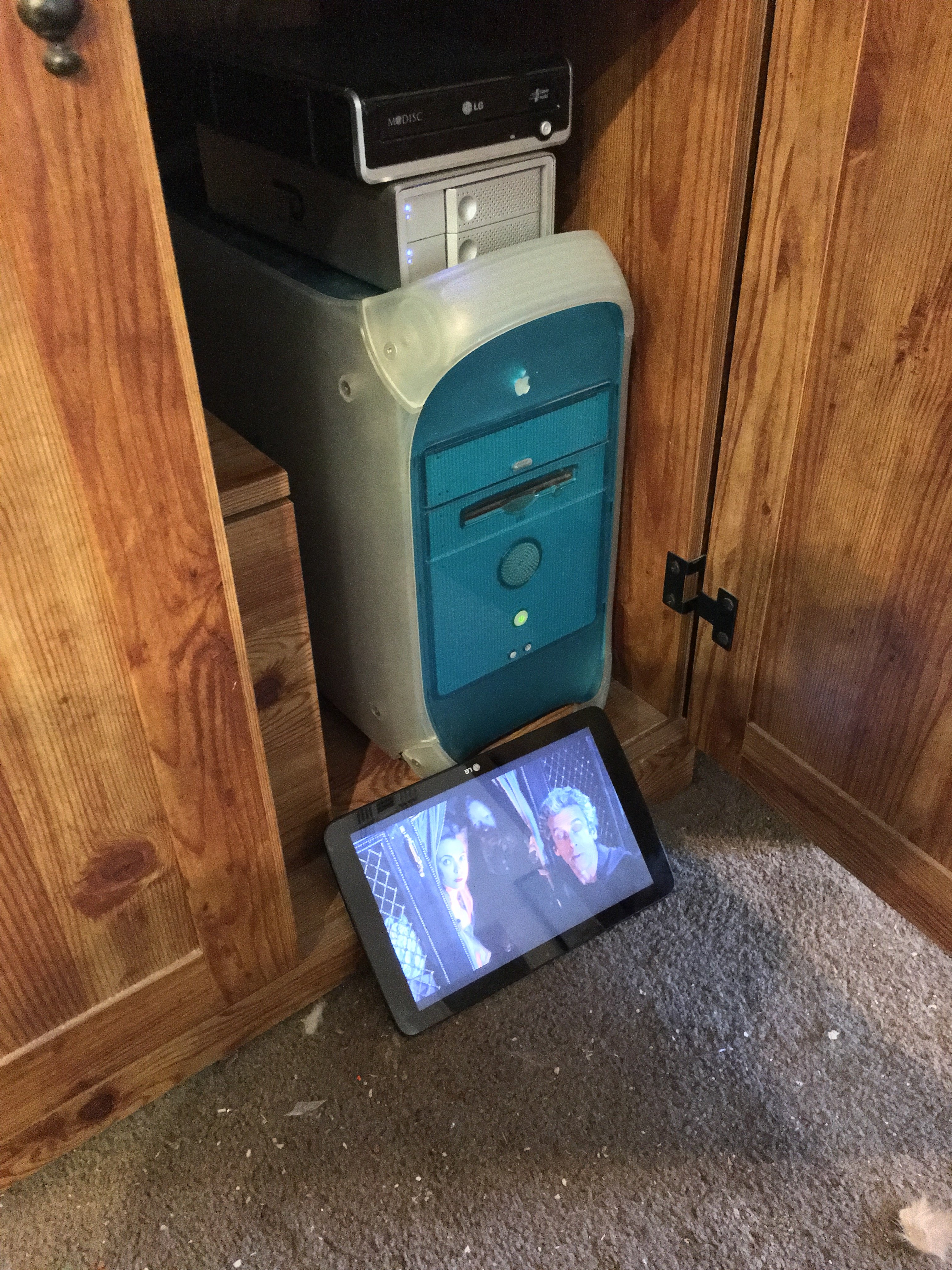

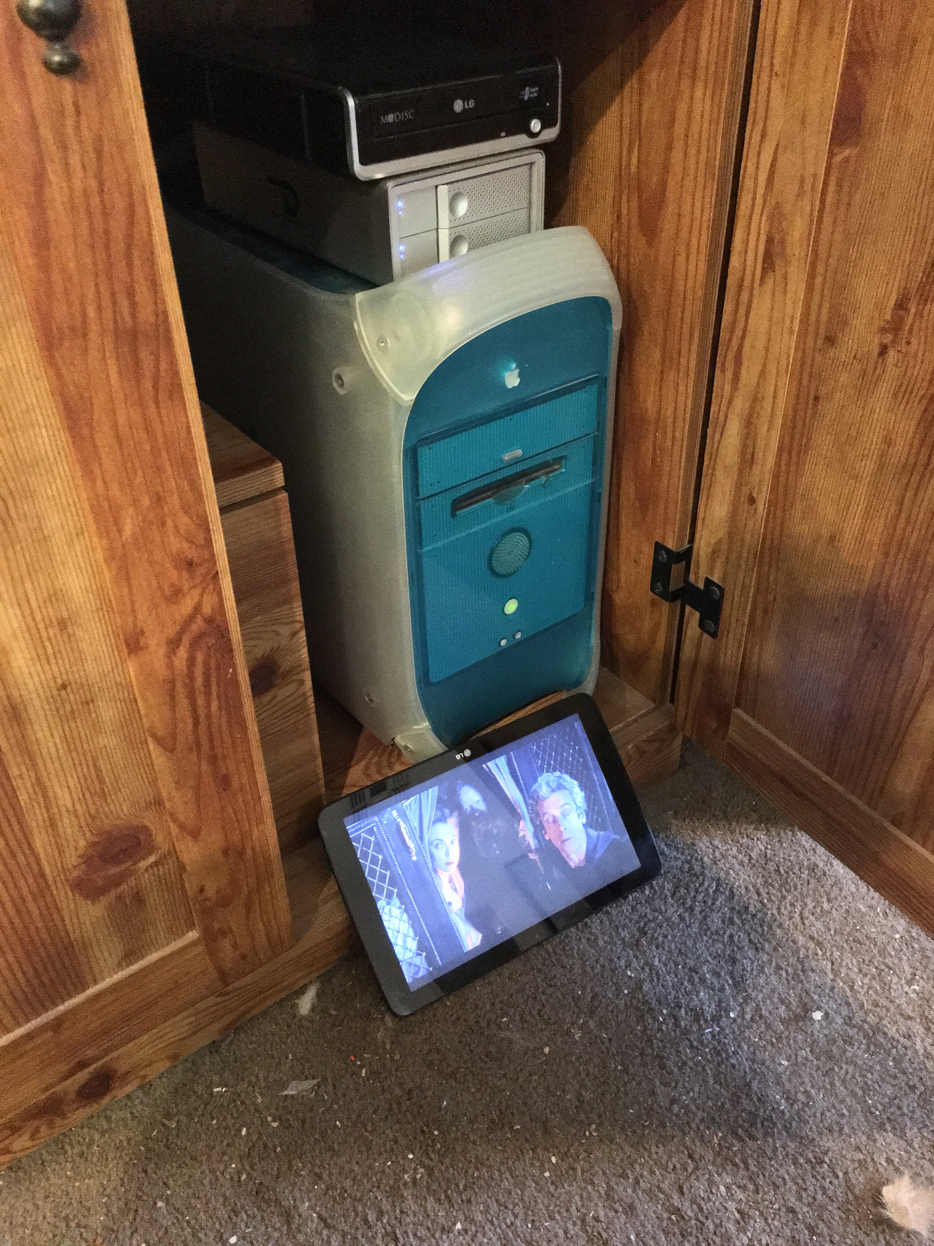

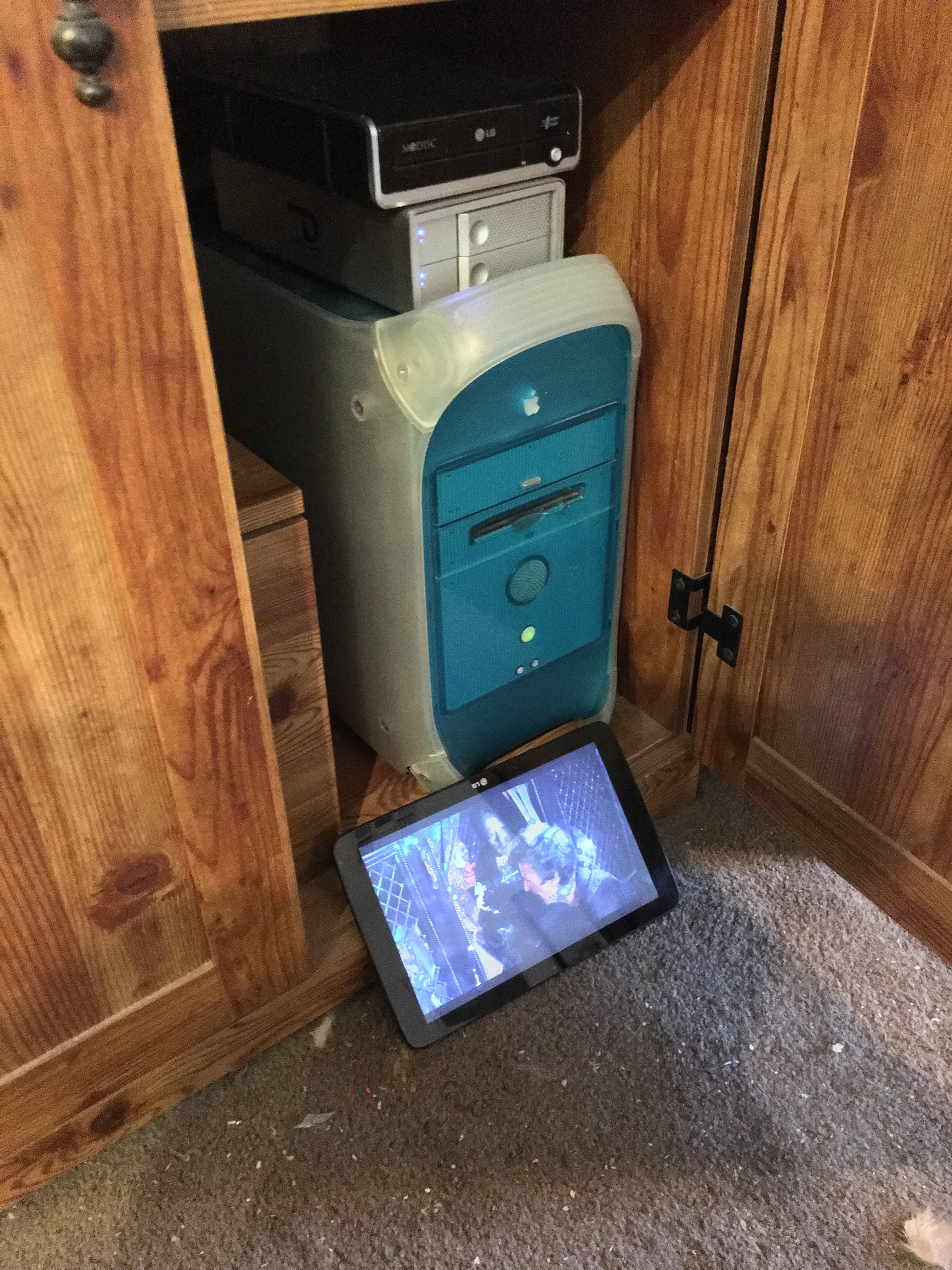

So, thought I'd poke around the possible today…and came up with another use for my G3 server.
As a test I put a MKV video file on the 2TB shared drive. This drive is a RAID enclosure (2x1TB) connected via an eSATA cable to my PCI SATA controller inside the Mac.
I have this Android crap tablet I was gifted a couple of years ago. My daughter uses it mainly, but I had cause to relocate it the other day. So, I installed an app that allows connections to SMB servers. Since my G3 is sharing this drive via SMB as well as AFP I can connect to it and access files using this tablet.
So, the test was this. What would happen if I tried to play the MKV file on the tablet?
Well, the tablet saw the file right away. And right now I am streaming Doctor Who to the tablet from the G3 - while the laptop in the room above is ALSO copying gigs of files to the same drive!
So, now I know I can use the G3 as a media server as well!

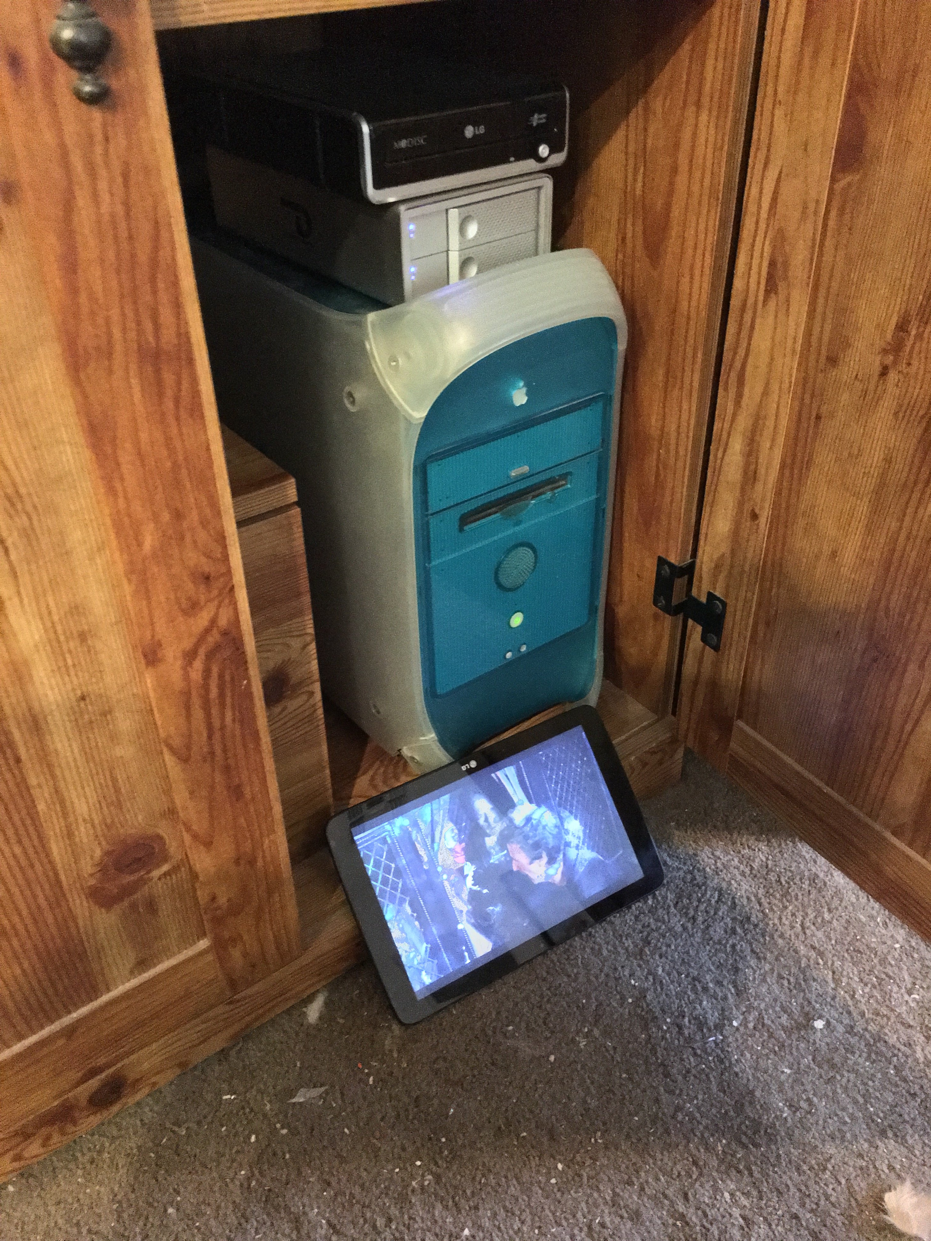

Well, the tablet saw the file right away. And right now I am streaming Doctor Who to the tablet from the G3 - while the laptop in the room above is ALSO copy gigs of files to the same drive!
View attachment 802133 View attachment 802134

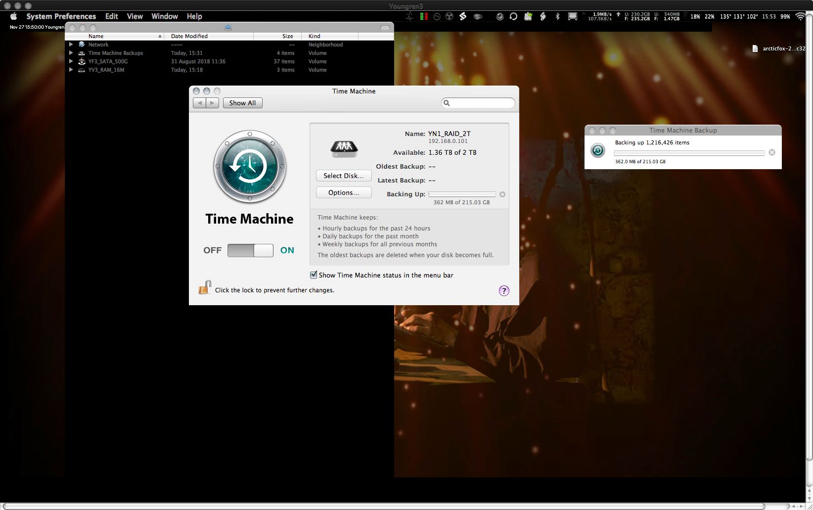

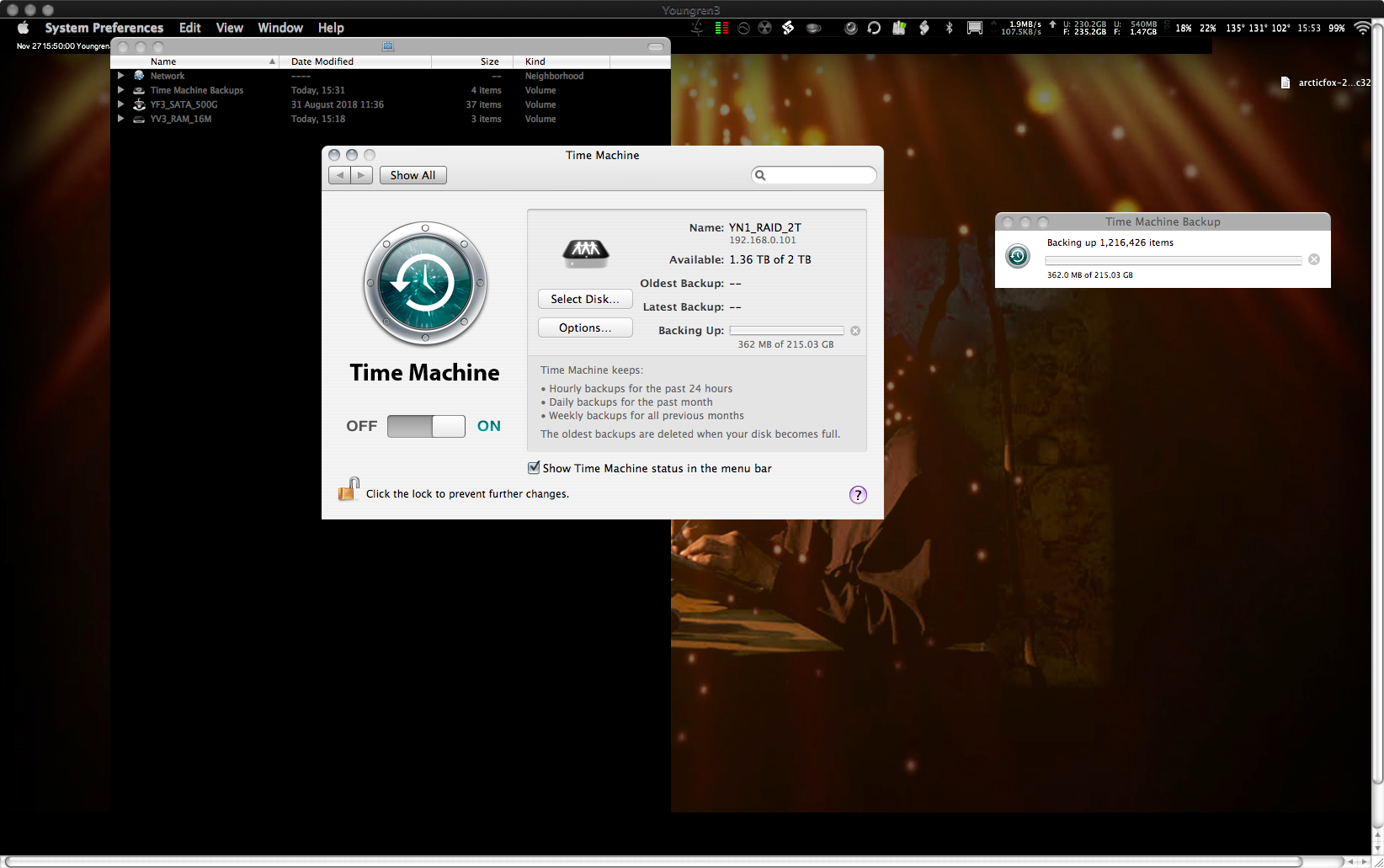

So finally got the El Capitan MBP to backup to a sparse disk image sitting on the G3's RAID drive. There's some quirks. It's not automatic for one and apparently I have to use SMB and not AFP.
But hey, an OS X 10.11 Intel Mac is backing up to a OS X 10.4 G3!
Unfortunately, the last holdout (my Snow Leopard MBP) does not have tmutil.

The last domino fell into place today. Been struggling with this for a year or more, but that's because the SIMPLE solution was the one I tried LAST!
I have been trying and trying to get my Snow Leopard MBP to backup to the RAID on my server. Every time it has failed for one reason or another. But today it occured to me…ALL those times I have been mounting the RAID over AFP (Apple File Protocol) and NOT SMB!
Now, because this RAID is attached to a 10.4 server it will not allow TM on the MBP to create the sparsebundle it needs. After going around and around with it today, it occured to me to just have the MBP start the backup to my Quad (running Leopard). That way it would create the sparsebundle. I could then quit the backup, turn off TM, move the sparsebundle over to the RAID and then connect via SMB and then select the RAID and start the backup.
Voila, it worked!
Apparently, Snow Leopard and above wants SMB and not AFP for Time Machine backups! Duh!!!!

Nice workaround. I seem to recall having a similar issue, but in reverse, when backing up my Leopard PowerPCs to a Time machine drive which is connected to my Mac Pro (El Cap).
The Leopard Macs wouldn’t allow time machine backups to the drive if I connected over SMB (or didn’t specify a protocol i.e Connect to Server: “hostname.local”). So, in the case of backing up the older machines to the more recent Mac OS, I needed to connect as “afp://hostname.local”. AFP also needed to be enabled on the El Cap client in Sharing preferences.

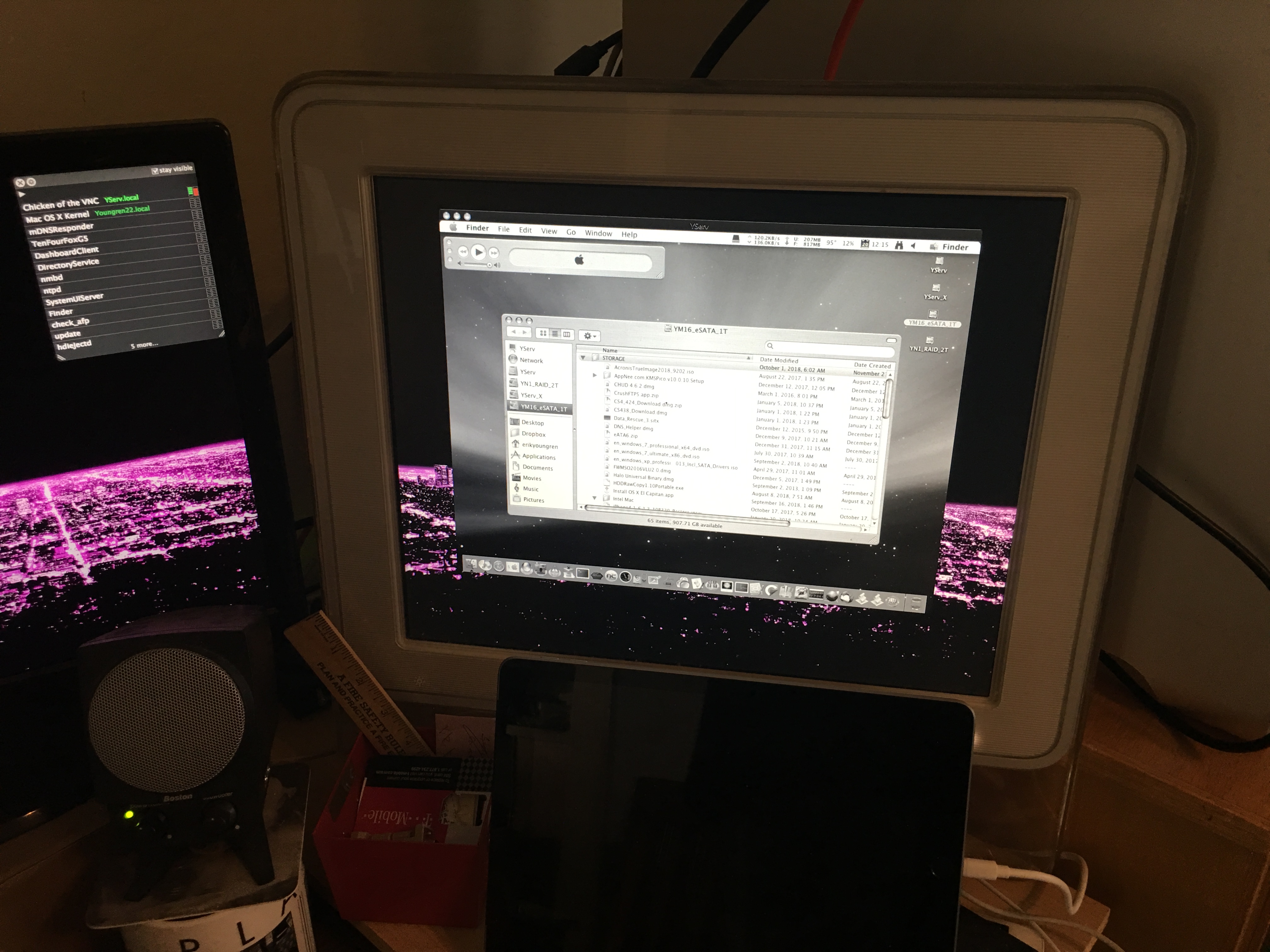

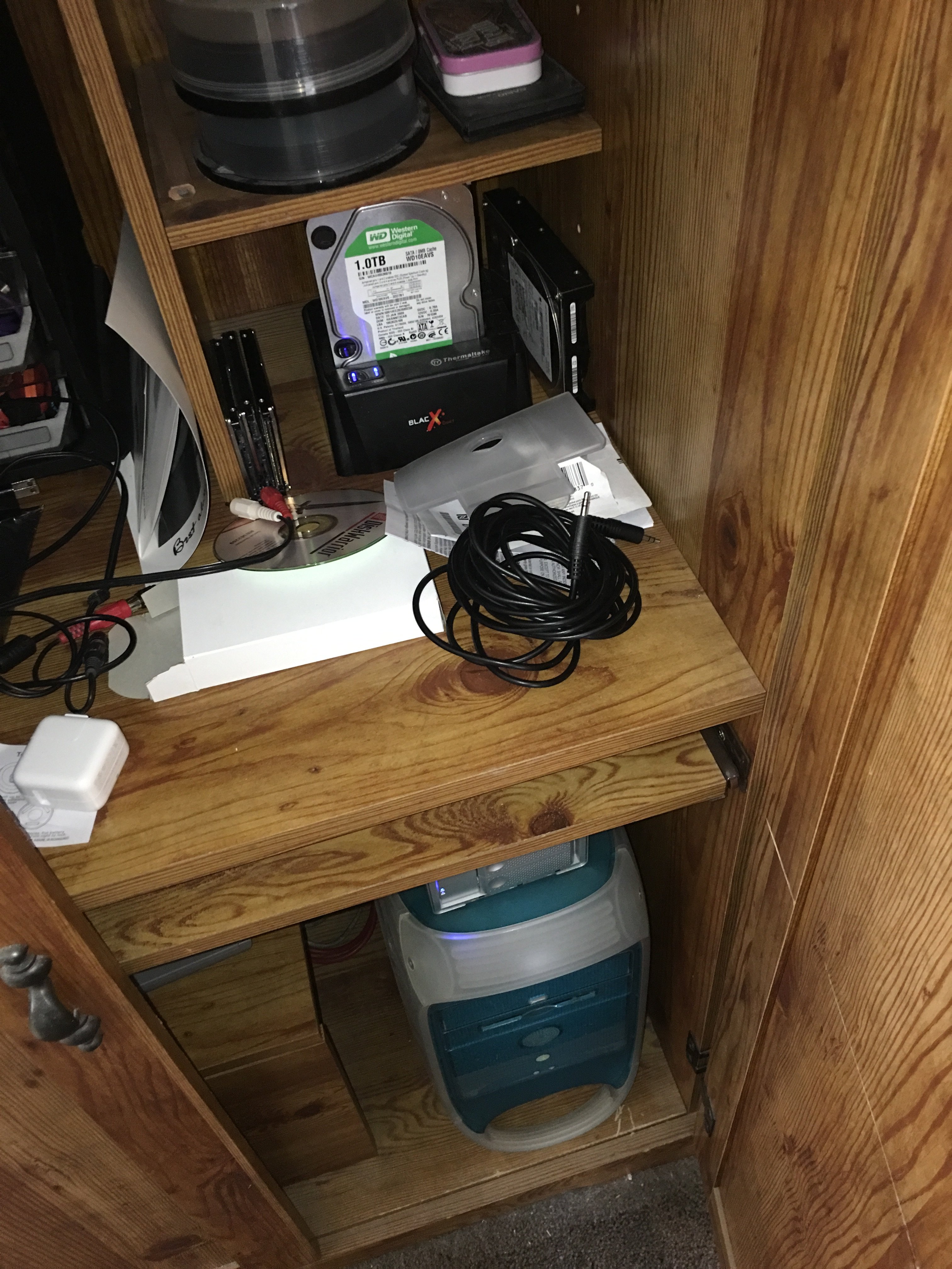

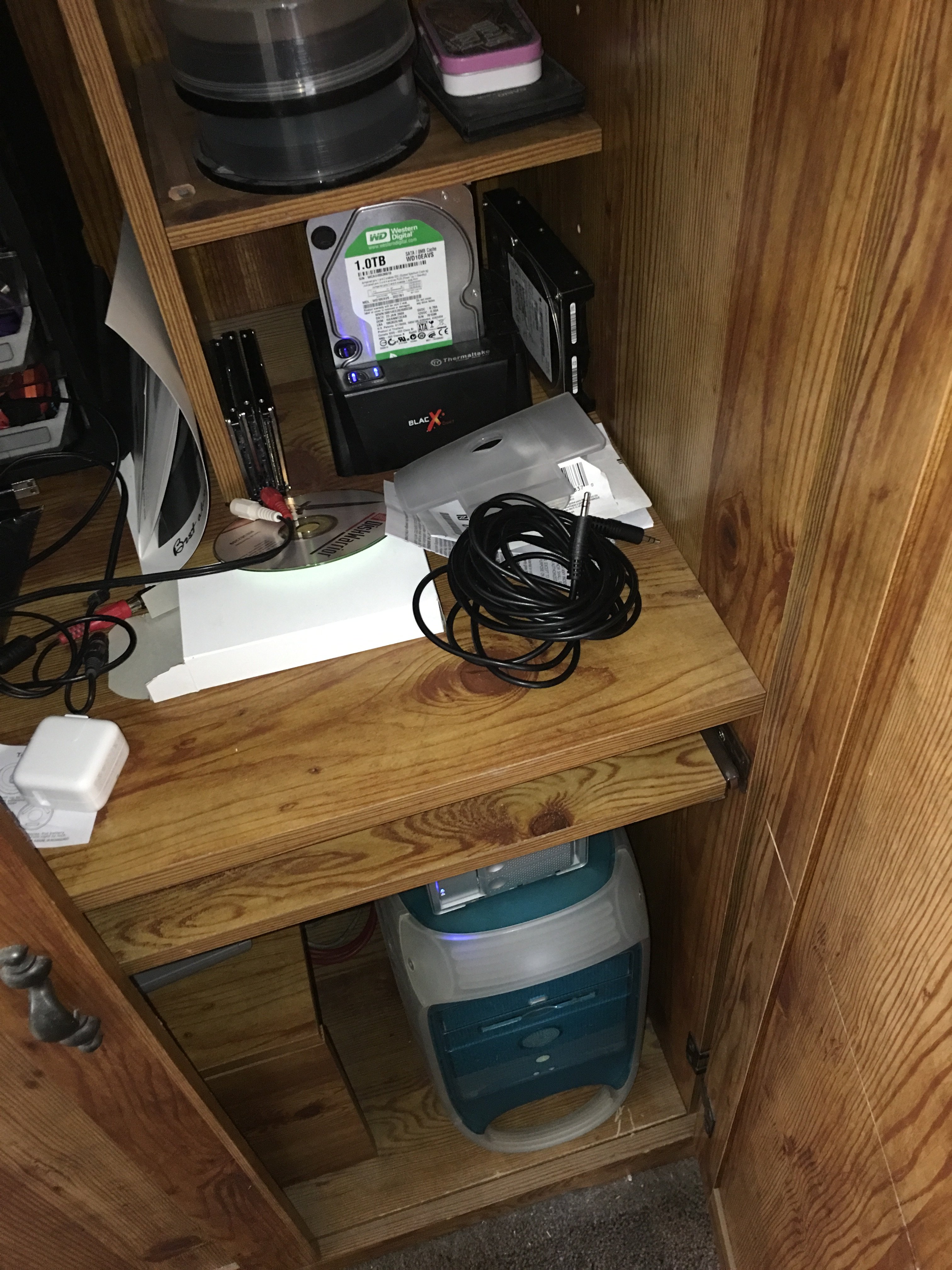

It occured to me that I failed to mention one other thing.
I have a Thermaltake BlacX dual SATA drive dock that I've used with my Quicksilver and my Quad. At some point in the last few months I got an eSATA cable for it (it has eSATA) and connected it to my server.
It has USB 2.0, but the server only has USB 1.0 and putting in a 2.0 card will be more work than I wish to take on. So eSATA with the existing SATA PCI card inside works for me. The only catch is that I only get one drive slot. The second slot does not seem to work.
In any case, here is my 1TB WD Green drive connected to my server. That makes one 2TB RAID and on 1TB storage drive.

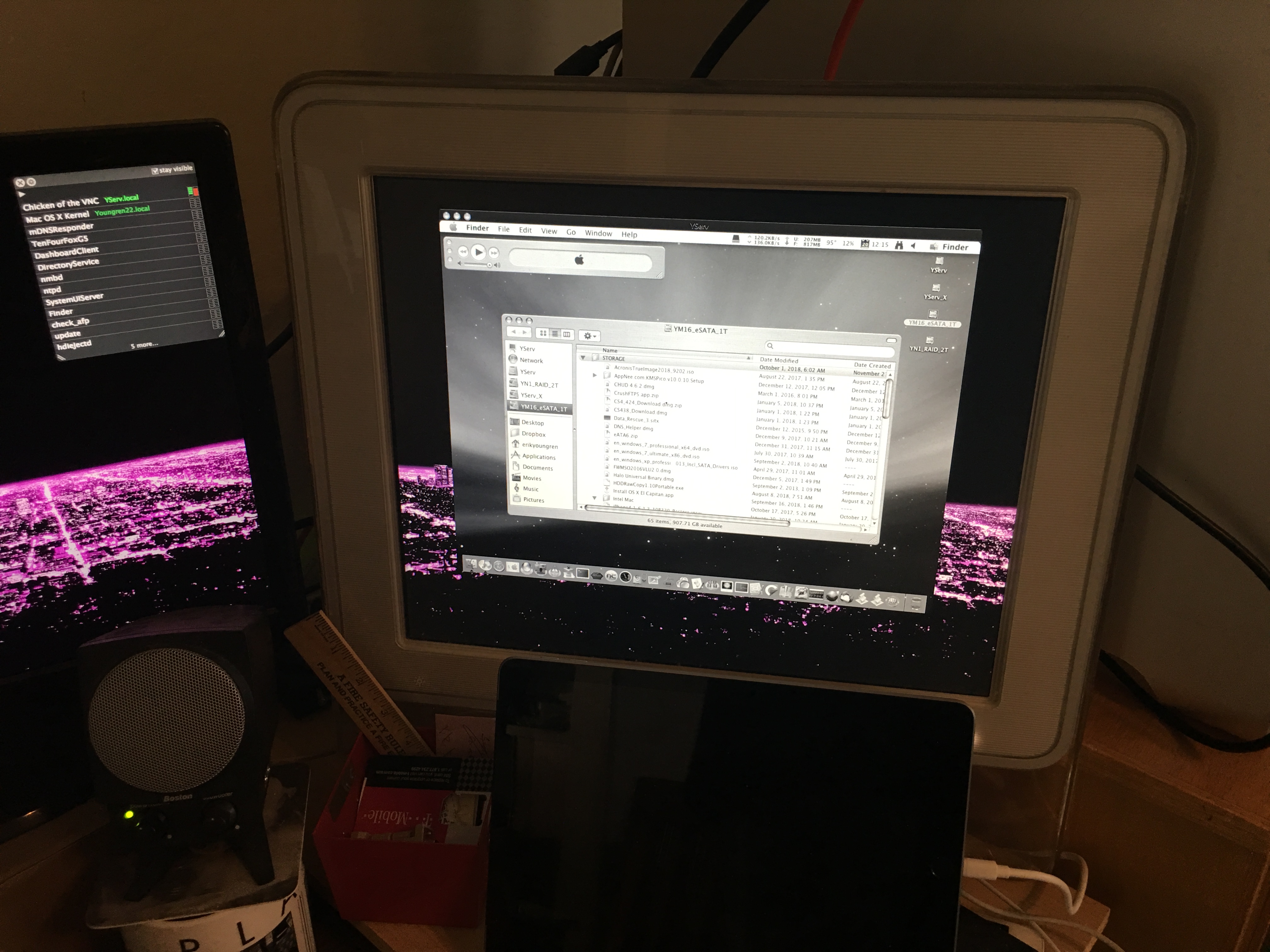

View attachment 816637 View attachment 816638

I bought mine for TM backups.
I started off with two USB 2.0 cases for spare drives. Those died. Then the replacement cases I bought for them shorted out so I had to send those back. Rather than constantly opening cases a friend mentioned one of these so I looked it up and got it cheap on eBay.
That gave me two drives connected to my QS for TM backups and so the QS was handling that from all my Macs for a while. Then the got handed off to the G5. But the major problem with these and USB is that the drives tend to disconnect.
Since USB 1.0 is too slow on the G3 and I didn't want to try and find a USB 2.0 card only to be limited by the PCI bus, I went and got an eSATA cable.
LOL! Now there are no disconnects, but I only get one drive slot! Go figure. I put my WD Green drive in it with the intention for it to store stuff I need to get to quickly but don't access constantly.
I wonder if seeing one drive only is due to the driver/kext that supports the e-sata/sata card. Iirc there's something called port multiplier mode that allows e-sata/sata to support multiple drives, without it you see one.
saw something similar with an si3132 card a few years back.

Hmm…thanks. I may have to track that down.
I stopped looking into it for some reason, but I don't recall now what that was.
