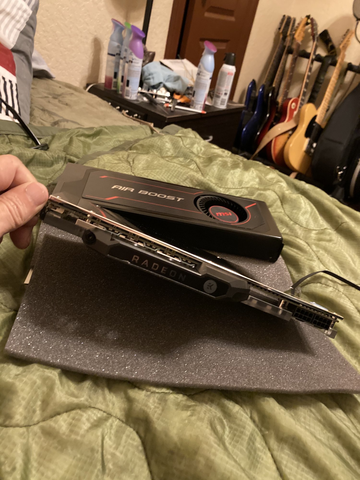

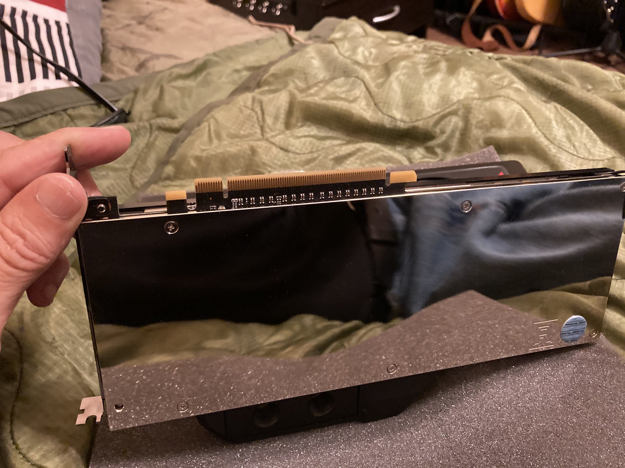

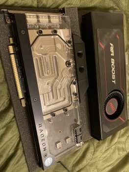

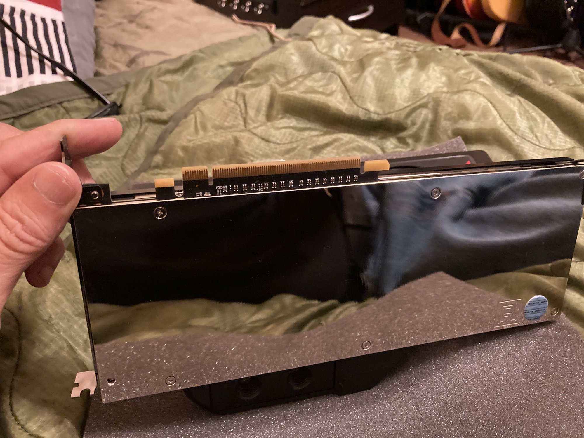

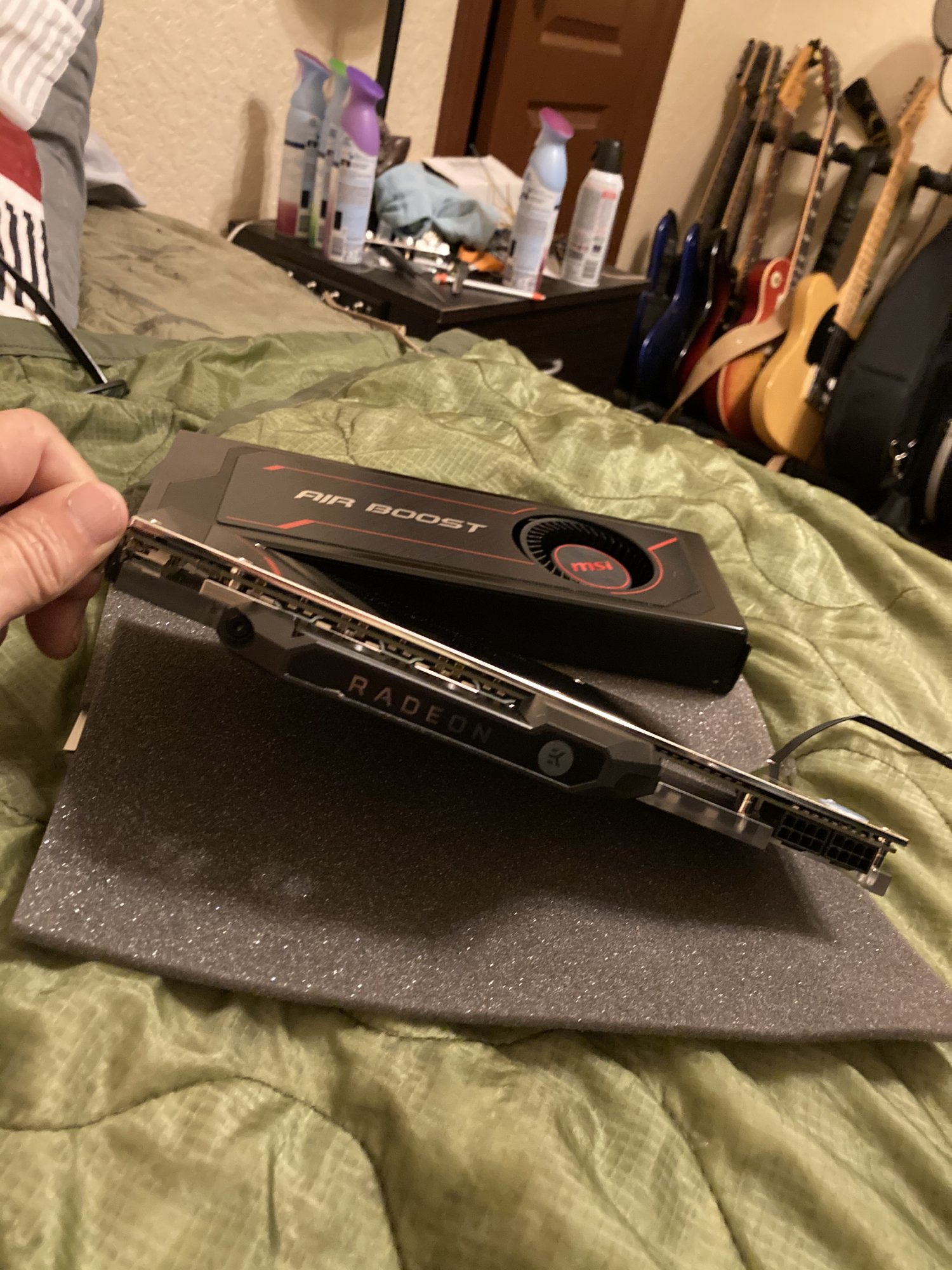

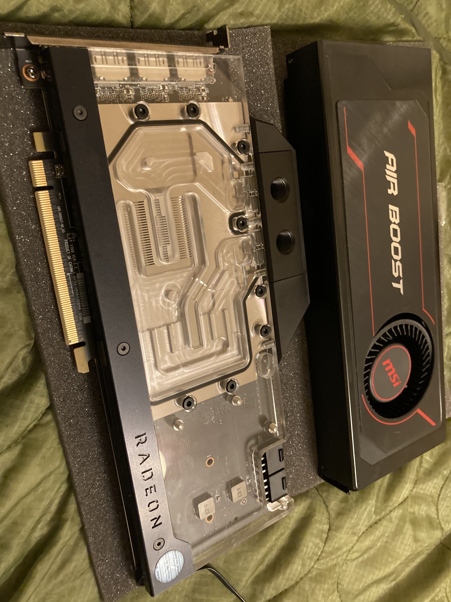

I know of one way to get cards single slot, it’s expensive, complicated, and requires maintenance.
of course I jumped in with both feet...
Putting the Vega on water...cramming a 120 radiator in, and a pump.
Not finished yet, it’s a tight fit..
