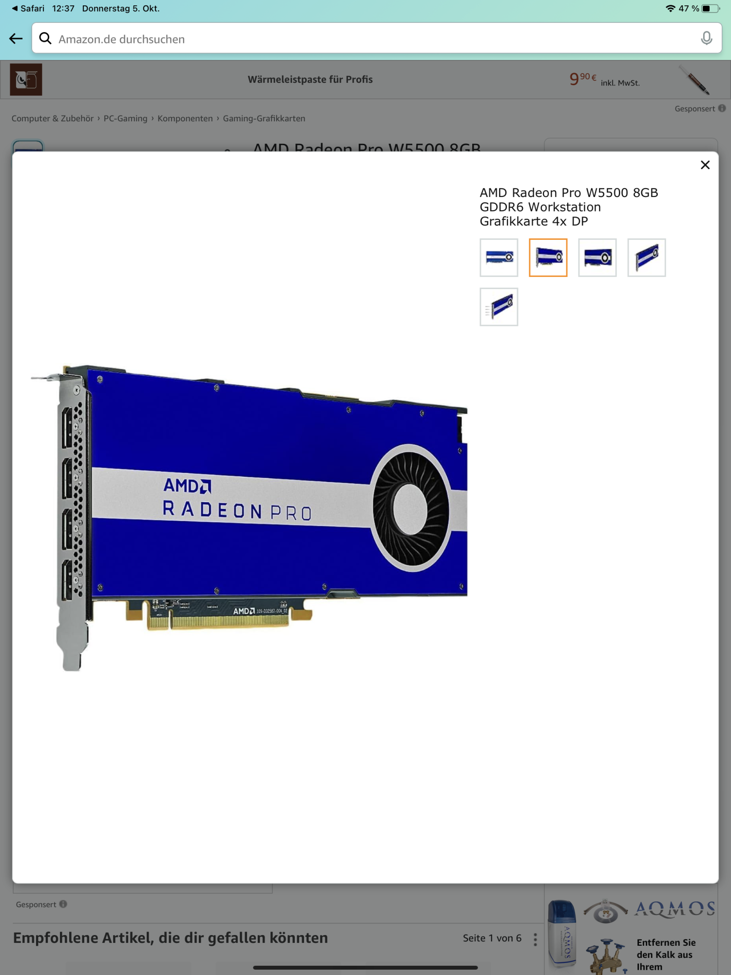

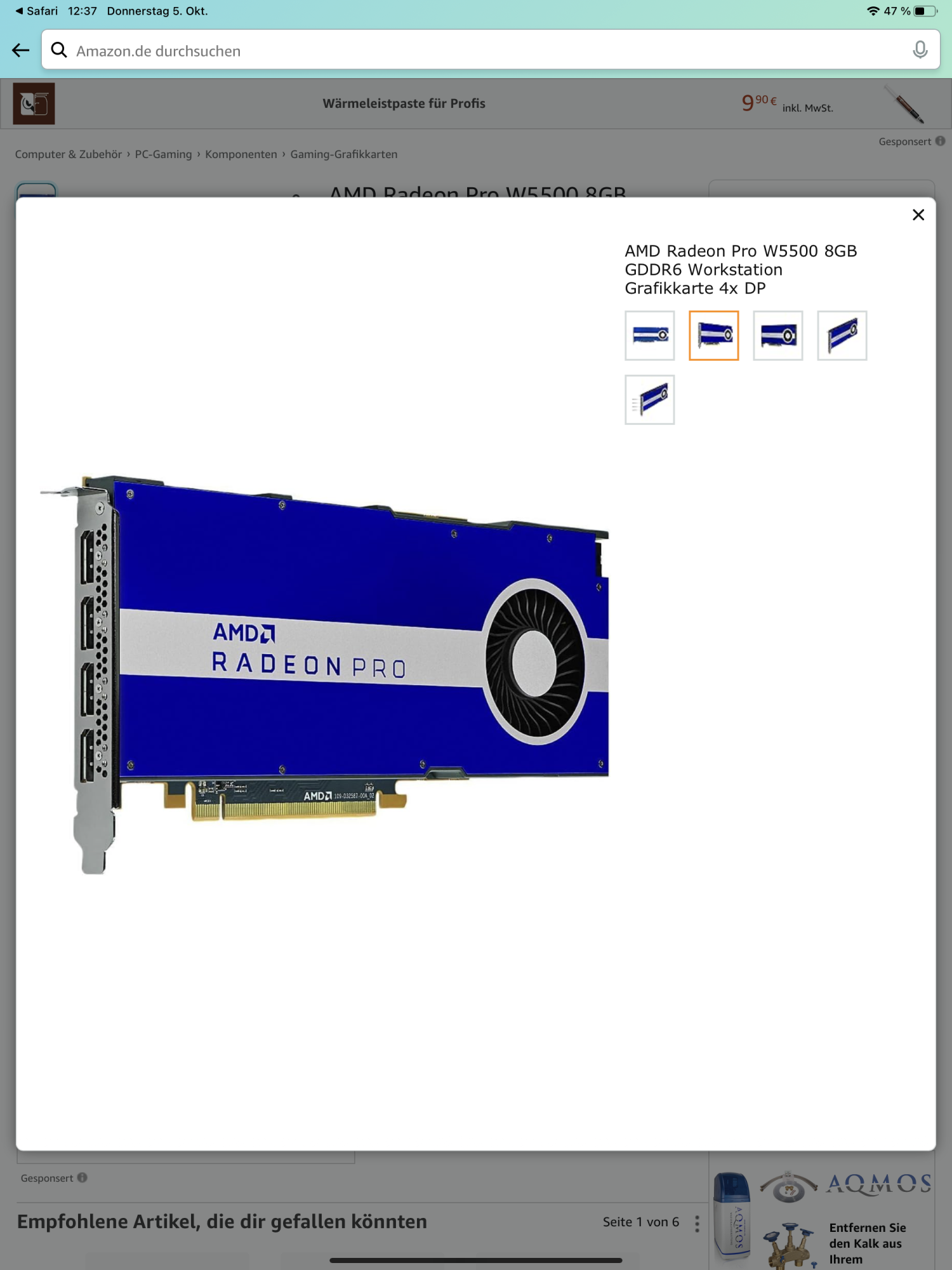

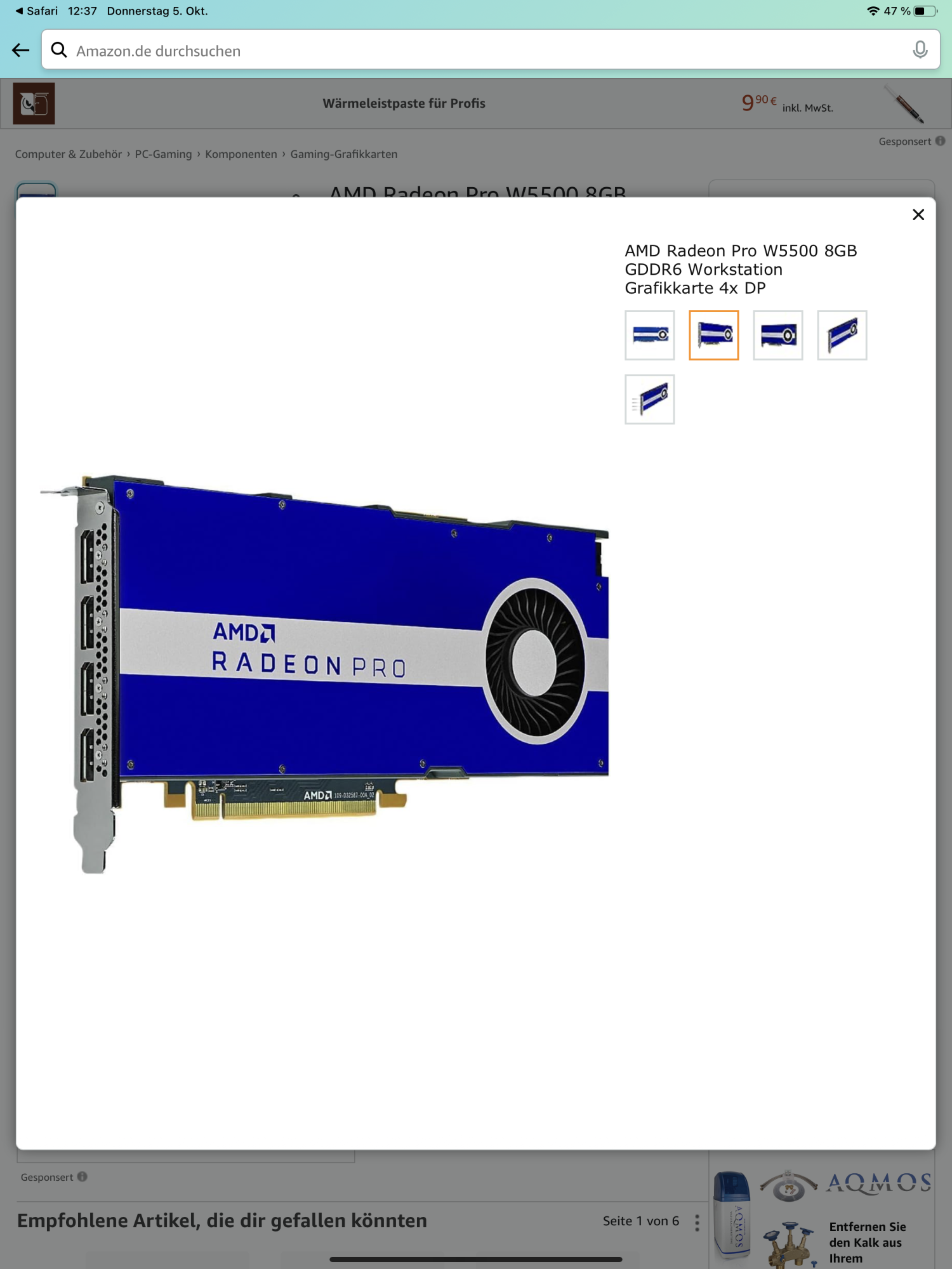

The MP7,1 came with three single slot “standard“ gpus.
1. In 2019 with the RX580
2. In 2021 with the AMD MPX 5500
3. In 2022 with the AMD MPX 6600
The original MPX Modules will be Hard to find, but you can easily go with the AMD Pro line of equivalents:
Both are single slot cards, to be found under AMD Radeon Pro W5500 or AMD Radeon Pro W6600.
That looks great! Thank you.
My Mac Pro currently has an MPX W5500X installed, so this would be (essentially) the same card.
Just to clarify, will this video card work natively out of the box or will it need to be flashed?
