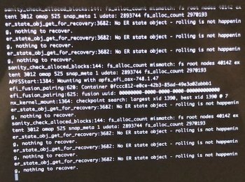

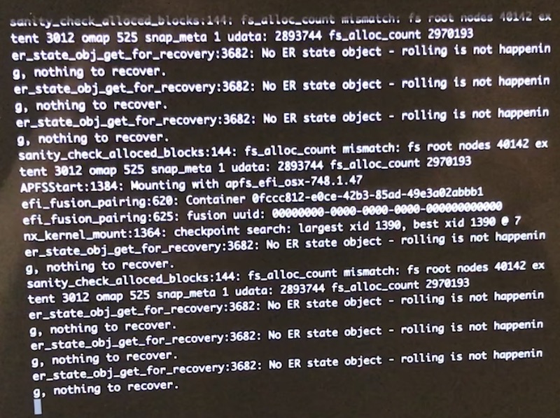

Guys I have a similar problem with different setup.
When I connect a external SSD (SanDisk, USB 3.1 Gen 1, UASP) with macOS high Sierra, it takes almost 40s to show the Apple logo. No matter if I am booting to the SSD or the internal Fusion Driver. When I unplug the SSD, everything is fine. Is it similar to what you are seeing?
After enabling verbose mode, I found the messages in the attached image right before entering the boot process. Those messages are not shown if the SSD is unplugged. Notice that after the boot, the speed of the SSD is quite good (200 MB/s / 450 MB/s, write / read). However, I cannot say how it will damage the SSD because of this behavior.
