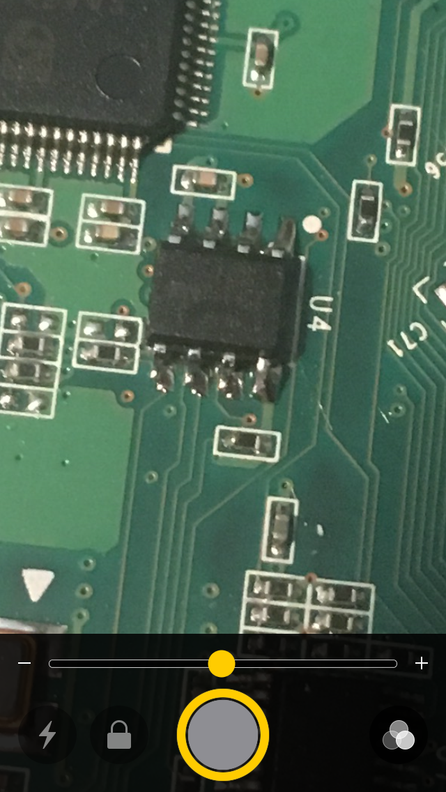

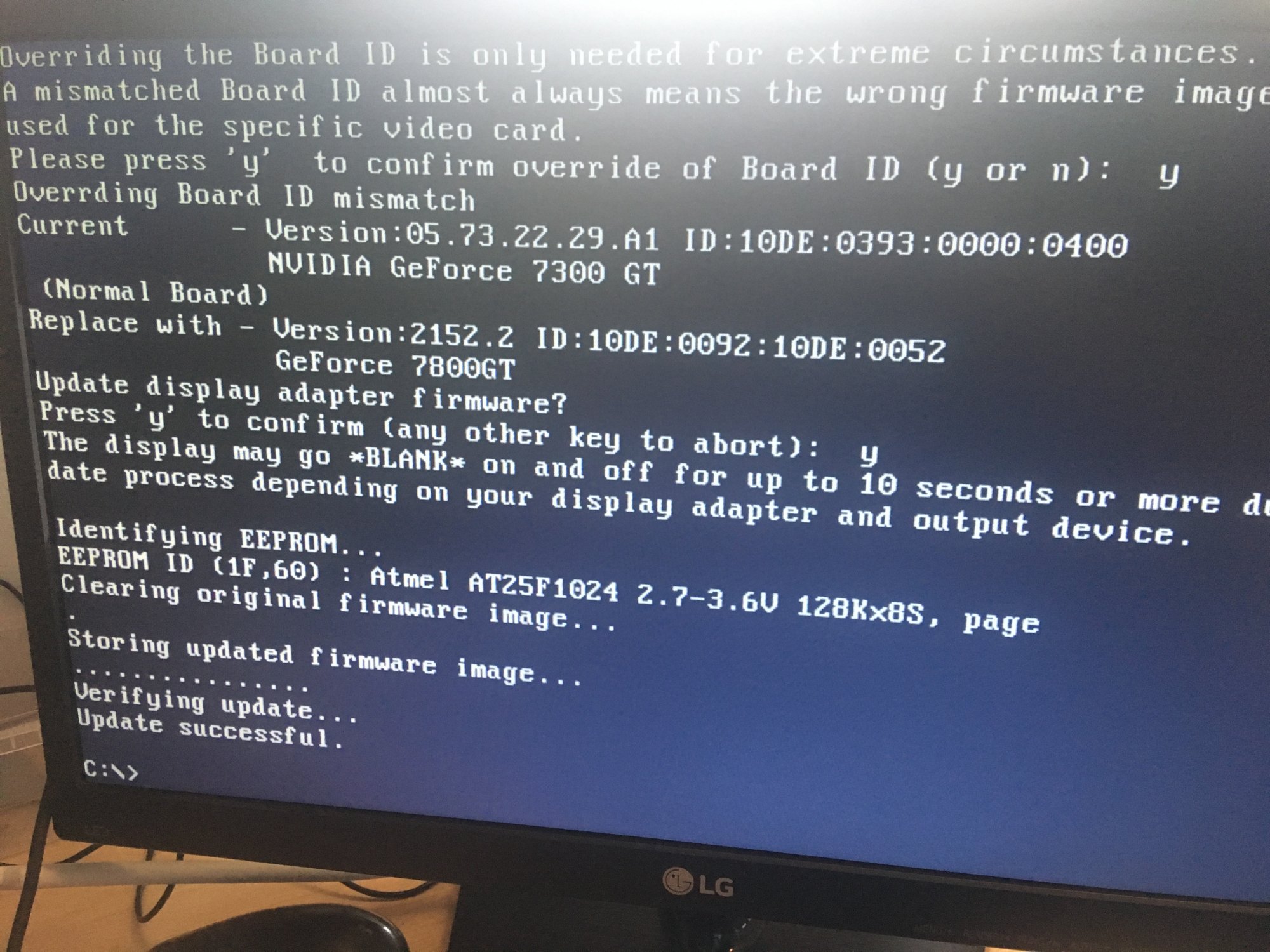

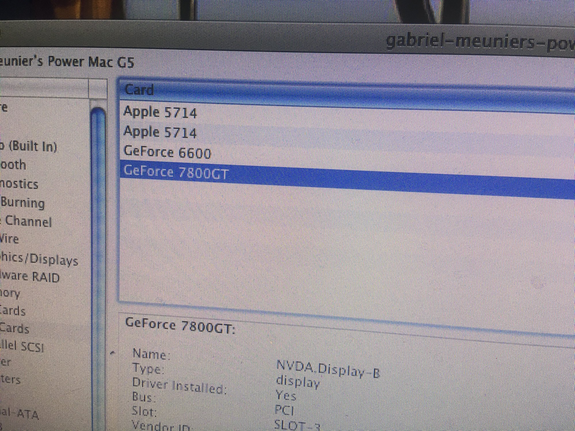

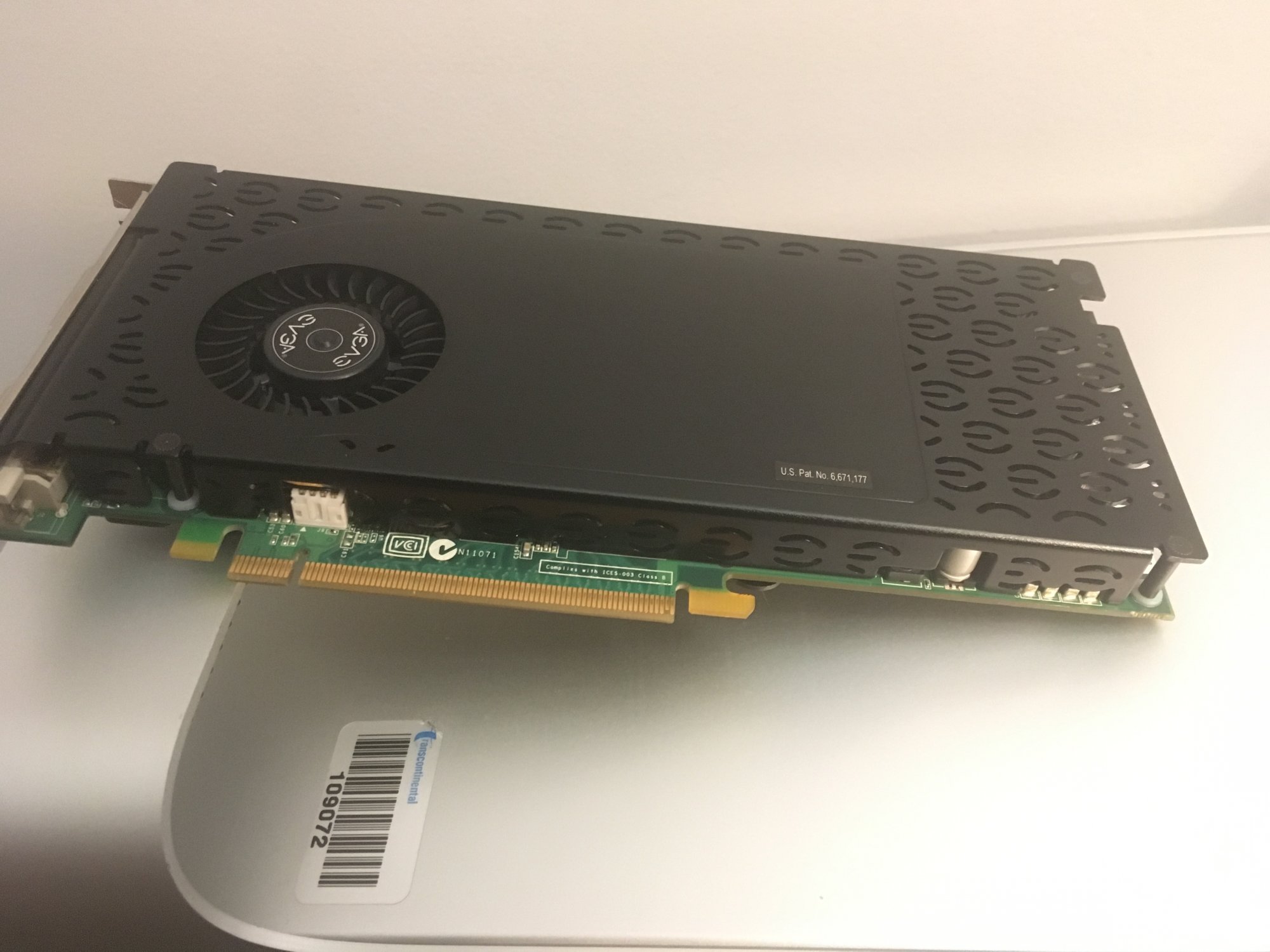

Hello my dear ppc amateurs. Last year I bought a evga 7800 gtx ko 256mg with the idea of converting it to a powerpc gpu. I failed at modding a vbios then failed when doing a bad flash ( eeprom was too small, bad rom). So today, almost a year after, I decided to convert the card to a 7800gt for powermac by:
1: flashing a 7800gt rom from the macelite onto a macpro 7300gt
2: desoldering the eeprom from the 7300 and soldering it to the 7800gtx

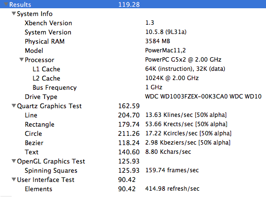

Everything work, I have a boot screen, the card is shown as a 7800gt but the card lack performance. My 6600le is twice as fast in everything I tested so far (the 6600le is faster in classic itune visualizer, twice the fps in quake 4 (30fps vs 15fps), a bit higher score in xbench (160 vs 130)
Did I missed something ? I thought these cards where the top tier for pcie G5. I understand I modded a gtx into a gt but to my understanding they run the same nvidia G70 processor (as in saying a gtx is a gt with higher clock speed).
Picture are there to show the whole process (for your enjoyment 😛) THX!!!
[automerge]1586756144[/automerge]
I just noticed : From a fresh boot, the fan spin, but when initialized by osx it stop and never spin again. So the card is basically cooking itself running a 68c (but some gpu run hot). I presume the card is down clocking itself.
I found out my card got 4 fan wire and the original mac gt have two. I'l solder wire on the header tommorow to test if theres any voltage passing in when the card is booted (maybe it can be a quick fix)
I'v removed the plastic header for the plug.

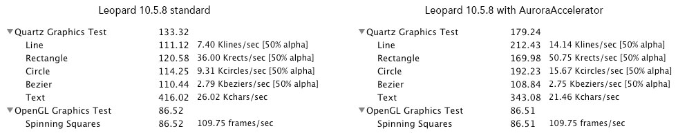

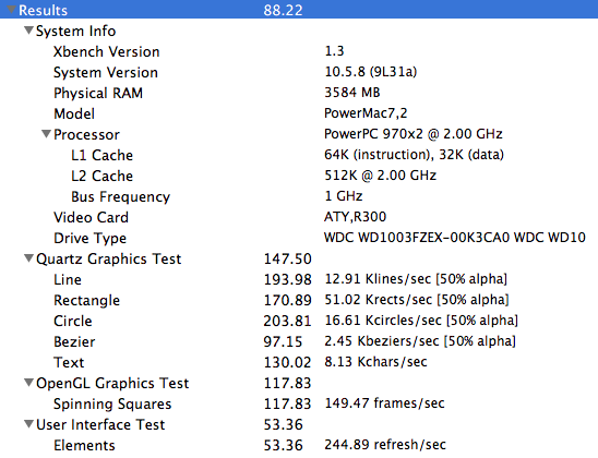

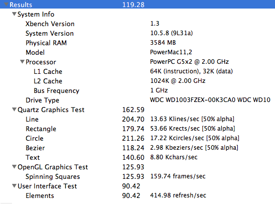

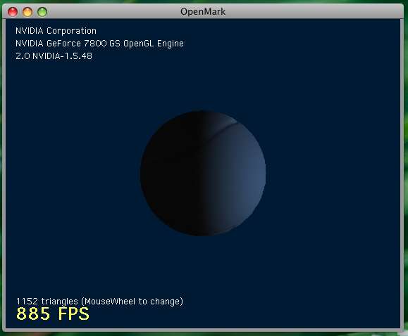

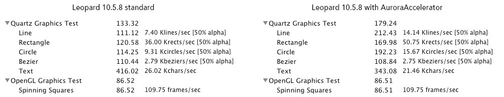

Purely for reference purposes, here is my flashed 9700 Pro and X1900 GT:
There definitely might be something amiss with your 7800s.
Or this test is crap.
I think Doom 3 or Quake 4 is a better indicator for performance.

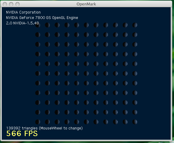

What did you get in Open Mark?

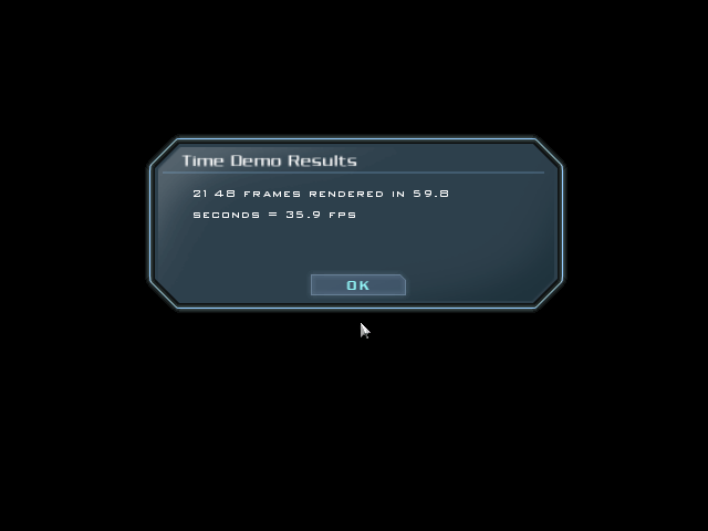

A chance to make a Doom3 timedemo?
Doom can be found in the Macintoshgarden (updated to 1.3.1)
add set com_allowConsole "1" to DoomConfig.cfg (under ~/Aplication Support/Doom 3)
CTRL-ALT-[~] (to open Console)
timedemo demo1
Graphic Settings Medium
(640x480)

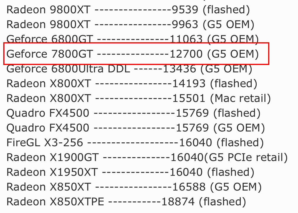

Or did you have other Benchmark results?

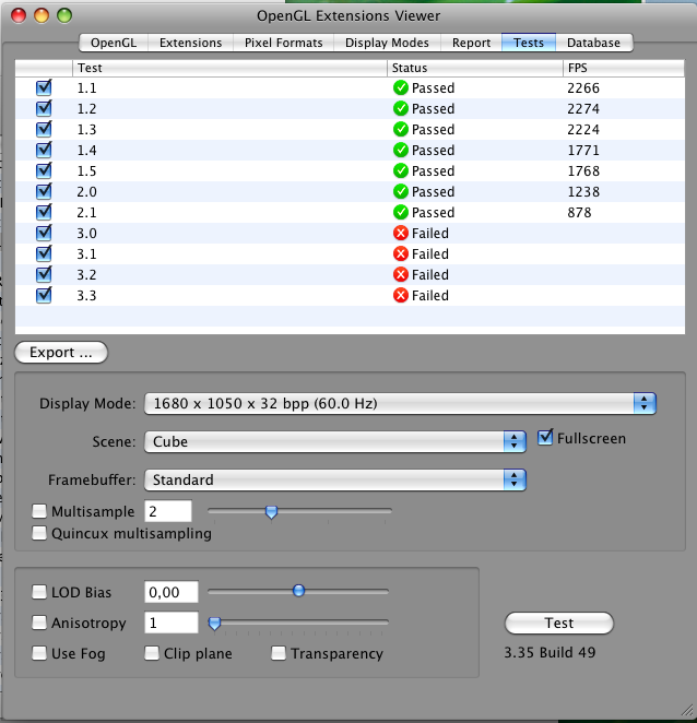

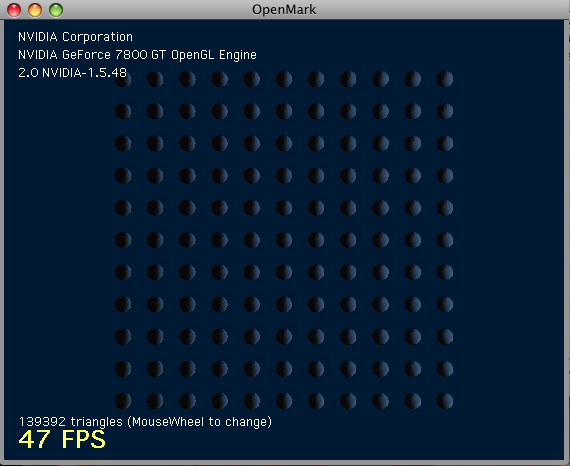

Or OGL Extension Viewer?
@TzunamiOSX @z970mp Thx both, I really appreciate. I’l do some benchmark tonight if I dont fall asleep when I get back from work.

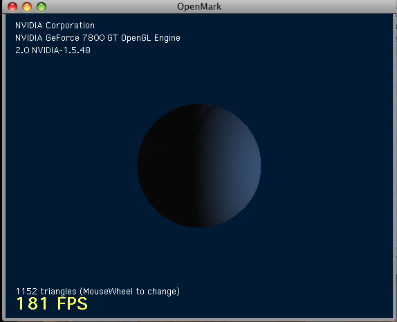

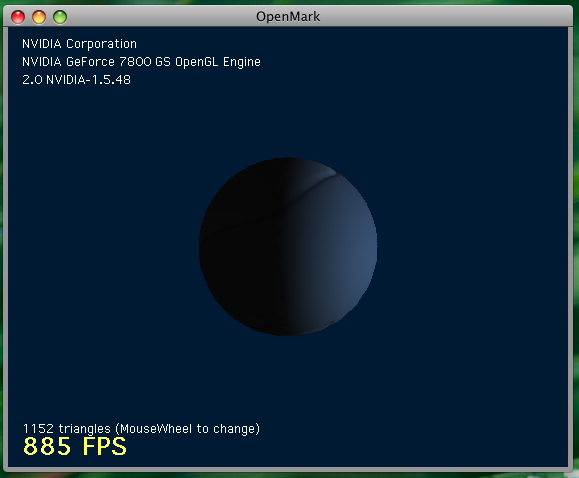

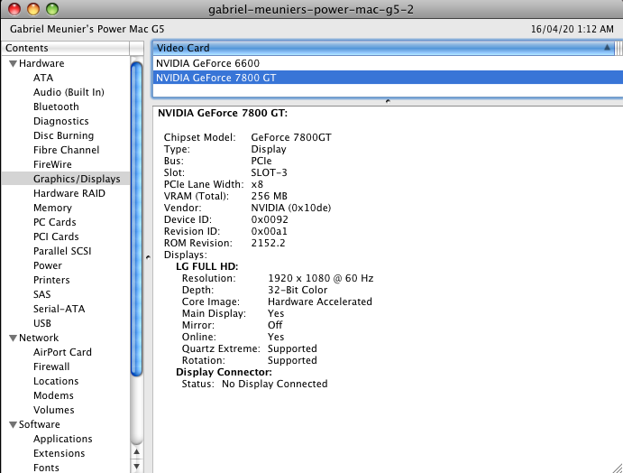

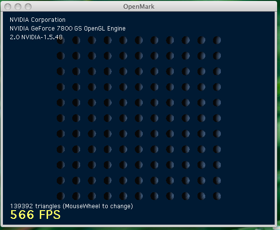

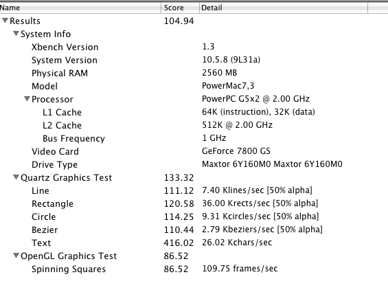

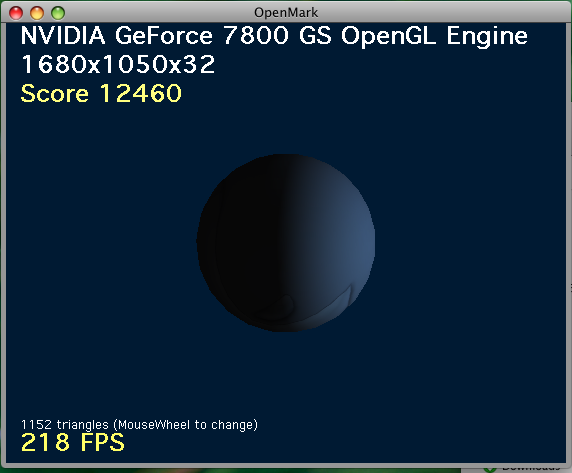

Heres my openmark result for the 7800gtx flashed to a gt

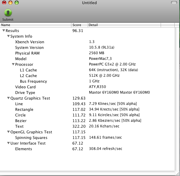

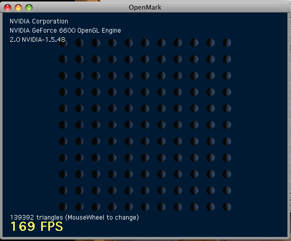

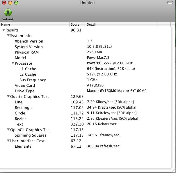

and here is the result for my nvidia 6600
Obviously theres something wrong. I tested the 6 pin power connector and it provide 12v on each 3 pins. I'l go back to the drawing board. I'l first try the 7800gtx 512mg rom ( found on marumors) then try to modify the timing table to fit my 256mg card.
*Note that I'm on slot 3 because my 6600 is in slot 1 (running in x8 dont affect the score)
these are very low resuts

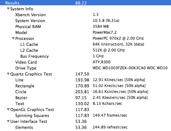

not really, looks like there is somthing better with your System or GPU.

I suppose that being a very powerful card, the X1900 could legitimately win. However, I don't think a 9700 Pro is supposed to largely outperform a 7800 GS. It seems that the 7800 only bested the 9700 in Quartz Text.
Perhaps this is a kext problem and OS X can't take full advantage of this card because of it?
As I was telling @Dronecatcher, there is something called glmark2 on Linux. That may reap different results, providing this is a software issue as proposed.
Precisely.
Look at my Radeon 9800 this card is also slower than your Radeon 9700. Did you modifiy your MacOS? 10.5Trim or something of your stuff^^?
Yes. The Leopard install I ran that on was optimized with AuroraTrimcelerator, Monolingual, and maybe ShadowKiller.
I think, this is the reason why your values are higher. Is it possible to test your GPU on a normal Leopard?

No OSX tweak will make a significant difference to GPU benchmarks.
I noticed that the quoted OpenMark scores in the thread aren't scores but various FPS points - check thread here for how scores are registered.

Yes this was mentioned in my fist post. I was fool enough to think I could convert a gtx into a gt ( same G70 gpu afaik). I'l try as soon as possible the gtx rom. I just have to figure how to flash a fcode bios with nvflash (the bios is now unrecognized). Either I wait for my eeprom programmer to get to my door or I hard wire my raspberry pi and use flashrom under raspbian. All my apologies for the misunderstanding. Thx for the help!
