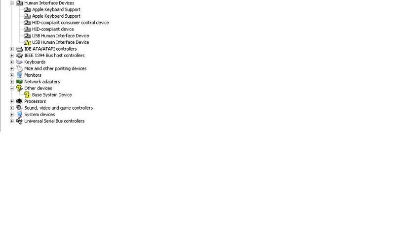

No. The only yellow exclamation I see is "Base System Device".
You can get rid of that with the intel proset network drivers.
Now I just have those pesky PCI-E exclamations and thats it.

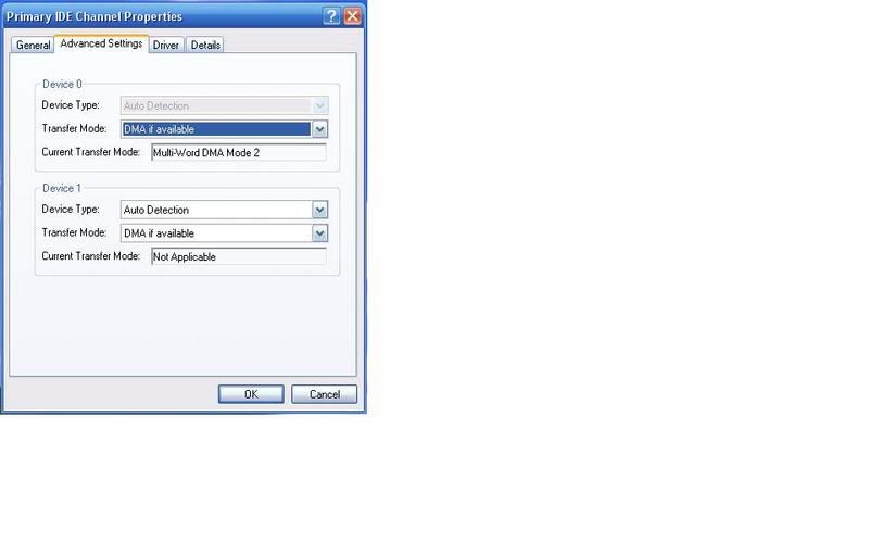

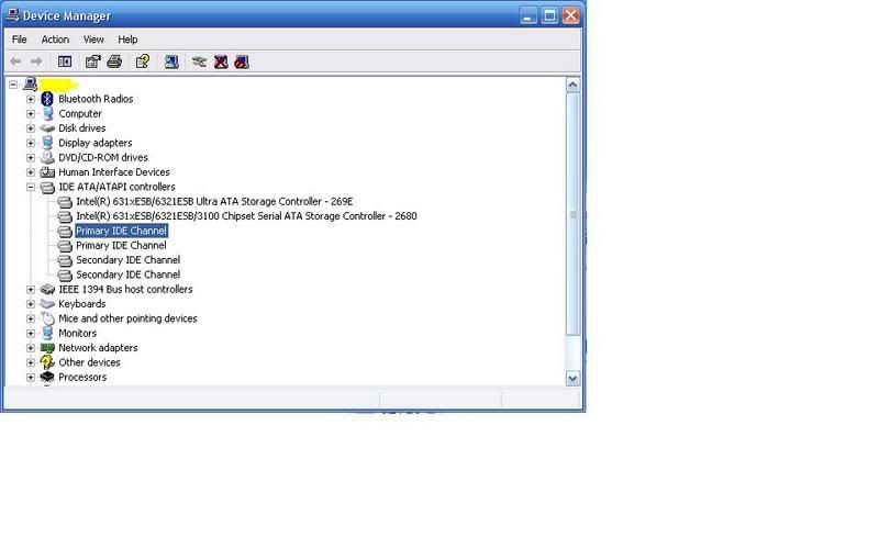

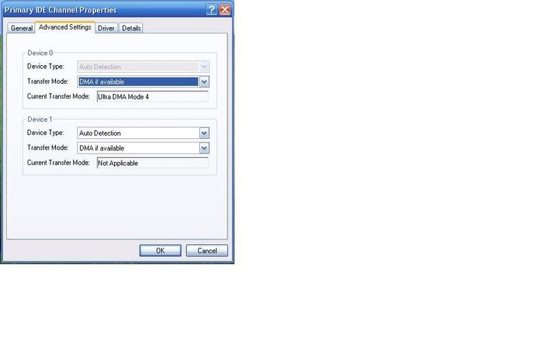

I don't know if I did it correctly, but I follow through the instruction making my own Slipstream CD and seam it install just fine. It feel a lot faster! Logging into Windows and overall Windows XP Pro performance feel like I'm actually using a real PC now. But I havent test out 3D Games and Benchmark yet.
After finish this is what it showing as my IDE...
Screen 1
Screen 2
Screen 3
Strange that I see Duplicate of Primary IDE Channel, but as long as it doesn't show PIO anymore.:D
However, after finish installation my device manager show a lot of Quatation Mark like some of the device is not install or working properly. Yes I did install Mac Driver via using Bootcamp. Is this normal? Should I leave it alone or is there a fix for this?

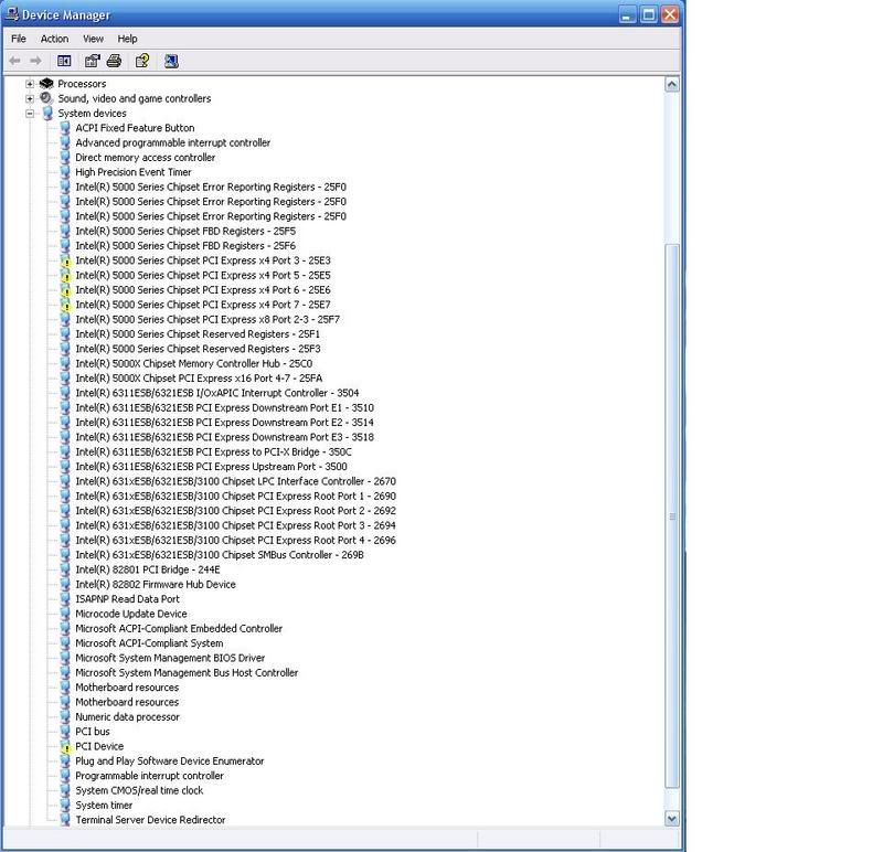

So no one figure out yet about the quatation mark on the Intel PCI in Device Manager? Or it is just empty slot and I shouldn't worry about it?
I'd plug in another pci-e card if I had something other than an nvidia card here =/ I'd be curious to see what it would do with those exclamations.

it shows all the intel(R) 5000 Series Chipset Error reporting registers (three of thoes)
the intel(R) 5000 Series Chipset FBD Registers -25f5 (x2)
the intel(R) 5000 Series Chipset Pci Express (x5)
the intel(R) 5000 Series Chipset Reserved Registers -25f1
alot more of the intel(R) 5000 Series Chipset but i don't want to type them all.
