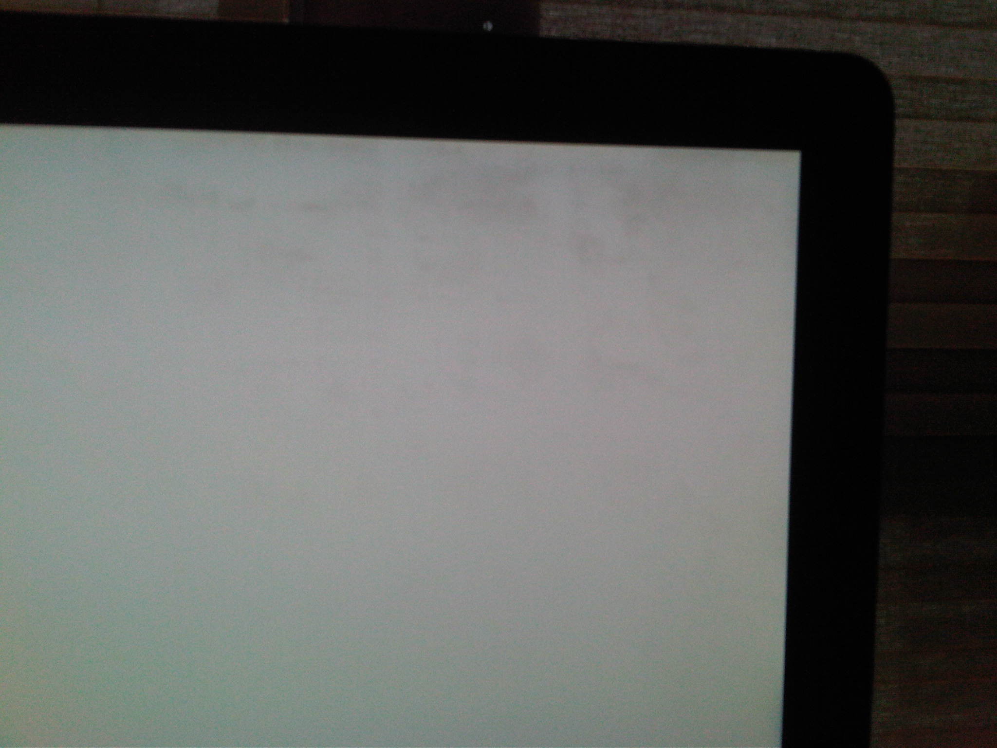

Hi,
I have had my iMac for about 8 months now and had no problems with it. The screen was also perfect when I received it as I did numerous checks for Yellow Screen, Dead Pixels and light leakage to name a few.
Today when I switched my iMac on i noticed these smokey marks in the Top Right of the screen. Any ideas to what this is? See attached photo. 🙁
Neither my wife nor I smoke.
My iMac is obviously still under warranty so will call Apple Care soon to get it looked at, repaired or replaced.
I'd appreciate any thoughts or comments. Before someone says it, Yes I have wiped my screen clean and it is not on the outside.
Thanks

I had that exact same issue and got my screen replaced, but a month later it's doing it again, so I'm at a loss for what I should do... 🙁
I had the same thing aswell on my 21.5", i took it into apple and they have sent it away for repair, got a phonecall from the technician earlier today and they said it was a problem with the LED screen so they are replacing it for me, just hope that it doesnt do it again, if it does I will demand they replace it with a new one.
My 24" imac looked similar. It was hardened condensation. I cleaned it up before I sold it by removing the glass with my fingernails, spitting on a lint-free cloth and wiping the back of the glass.
You may not have the same problem; it may be a backlight fault (which would require a replacement through apple); I can't tell from the photo. But for a minute or two with a cloth, it's worth a try.

I removed the glass and It was immediately clear that the smokey marks are actually on the screen and can not be removed.
I might add that removing the screen is so simple if you review the video in the link in my previous post. It took me less than 2 mins to remove, clean and replace.

Got my 21.5" mac in october 2010, already got smokey screen. Took to genius bar in store this morning. Tech told me it was what will happen and there is nothing you can do to stop it,😕 they are ordering a new glass for it and will have it in for repair. wish i had known this before hand as i would not have brought the mac. Apple really need to sort this problem for future macs.

just to give you all an update, i have just picked up my imac 21.5" bought in feb 2010 that had the same smokey screen problem, apple have replaced my screen and it is looking as good as new now which is a good thing, and the replacement screen comes with a 3 month warranty so im going to keep a close eye in this one to see how it goes, would of expected more from a £1,300 piece of machinery in an ideal world but hey, thats life...
... as I've commented in other threads, my 24" iMac had those swirly, smoky traces in the upper corners from the first time I unboxed it.......... I just wiped them off removing the glass with a suction cup.......
.... seeing the curved, wavy patterns those smoky traces follow, makes me think that it might be due to the air circulating inside that carries specs of dust from the outside through the vent and eventually deposit on the glass..... but again, I might be wrong........
...... after cleaning them off, my screen and glass are spotless. I do this whenever they start to appear again (6/7 months).....
This is the only issue that my 3 years old iMac has ever gone through, otherwise, it´s a great machine........... I just think of it as a periodic (and very simple) maintenance task, just like wiping the outside......

Apple Engineer visited yesterday and told me it was dirt under the Glass initially, which I knew it wasn't as I had already removed the glass and cleaned it.
The Engineer removed the glass, and then said OOO, seems like we have a hardware problem.
To cut a long story short, they have replaced my screen with a new screen. I did numerous tests on the new screen with the Engineer checking for Light Leakage, yellow tint, dead pixles and smokey screen. The new screen is perfect.
Happy that Apple resolved the problem so quickly, concerned in case this happens again after the Warranty or Apple Care protection expires. 🙄
