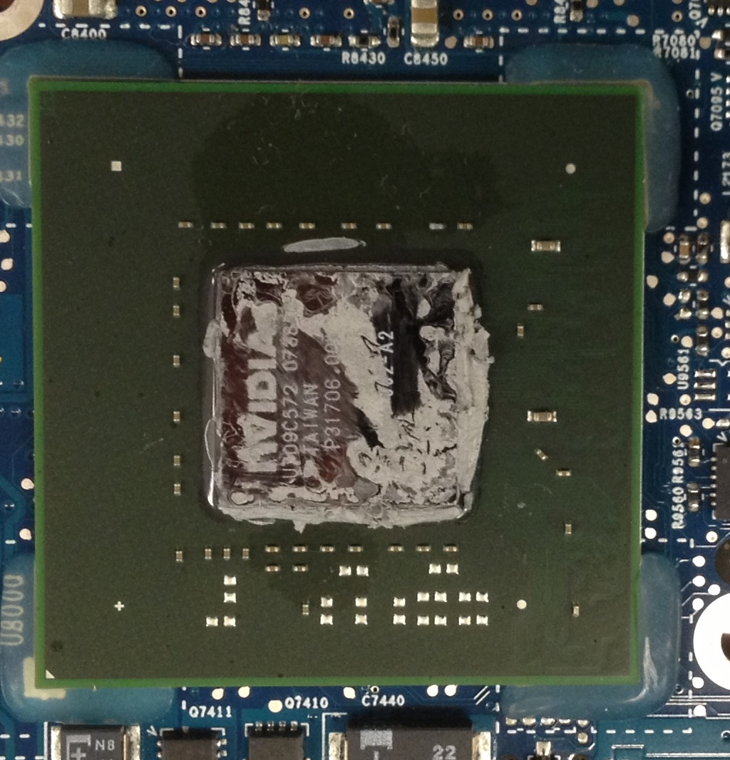

How does one go about reflowing the solder of this chip?
Just apply a heat gun directly to it?
I was hoping to re-solder everything myself, but it seems that might be a difficult task, given the way the chip is mounted to the board.
Would I be able to find a new chip at a local computer parts store?

Frankly speaking, if you're asking how to do it, then no, you have no possibility of doing this yourself. No, you would not find a replacement chip anywhere.

I got a A1226 MBP about 18 months ago as a "good deal", it lasted a few weeks after the return date before failing. I tried baking it several times, wrapped in a blanket, upside down, playing movies for 4 hours, and it would come back to life, then fail again under normal use (office work)within a day. The best quote to repair it was CA$175 from the shop I got it at, and new logic boards on eBay are $350 and up. I learned in this thread that the new logic boards from Apple can still fail. I had given up, it was in the basement, and my wife was struggling with a really awful Lenovo Windows 8 machine, and I re-read this thread. I decided that I would do three things to try and fix it, rather than *just* heating it up again, again based on this thread:
1. Remove the logic board and heat it with a heat gun (I used aluminum foil, several layers, with a square cut out over the graphics chip, to protect the board)
2. Apply high-quality thermal compound (Arctic Silver, followed the instructions)
3. Use smcFanControl to run the fans higher and keep it cooler (minimum fan speed 4000)
So far, it's been running for several days, under heavier loads than she usually gives it (I used it as my main computer for 2 days), noticeably cooler and without problems. Not a long time, but I'm cautiously optimistic. Thanks everyone for your contributions here: it really made a difference for us.
Approximately how long did you heat the chip? And did you aim the heat gun directly at the chip itself?
The repair failed on 21 September, so: the heat gun method, plus new thermal compound AND running the fans higher with smcFanControl, repaired it for almost a month.

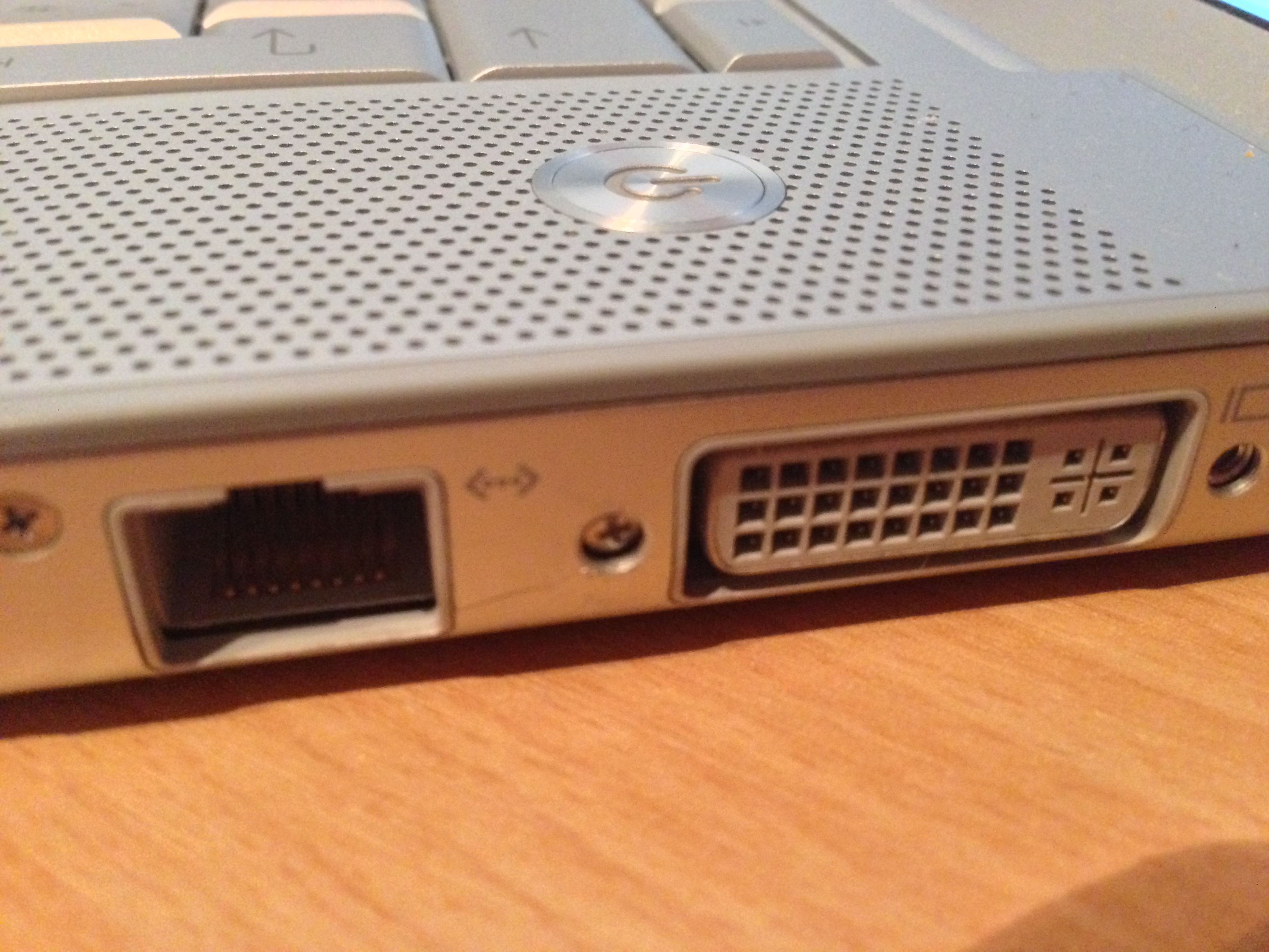

I did do a noob mistake by getting a screw stuck in the DVI port when I was reassembling it quickly and being a bit careless by just sticking the case screws in any hole i seen :( :eek:
Im scared :(:(
Im scared :(:(
The same thing happened with my system when a family member insisted on doing an upgrade for me. It's a bit of an annoyance to have one screw missing from the case and to be unable to fully, securely connect an external monitor, but it ultimately didn't cause any problems. The case isn't loose with only one screw missing, you can still use external monitors/projectors (either don't screw it in or only screw in the other side), and it doesn't affect the system's operation.
Hahaha, I did the same thing years ago! I wonder just how many people have made this mistake. In fairness, Apple's design makes this a very easy mistake to make.
I wonder if theres an easy way to get it out with superglue :confused:
If you're super careful and got it in there at the right angle, my guess is that you could hollow out the head with a drill bit.
Then again, since not being "super careful" is the exact trait that got us in this mess in the first place, I don't think I'd recommend this course of action. :D
