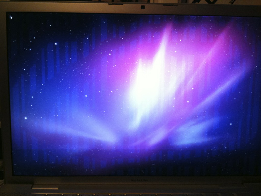

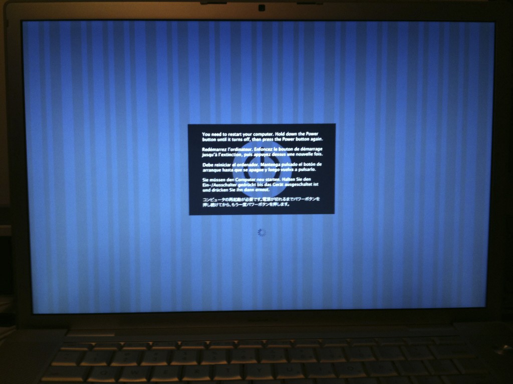

RIP MacBook Pro 2.2GHz [11/12/07-2/4/10]. It was a good time. I will be calling AppleCare tomorrow. After more than 5 Kernel Panics this week and constant freezing, beachballing, and flashing/distorted screen...my MBP has died.
