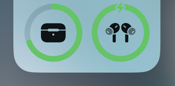

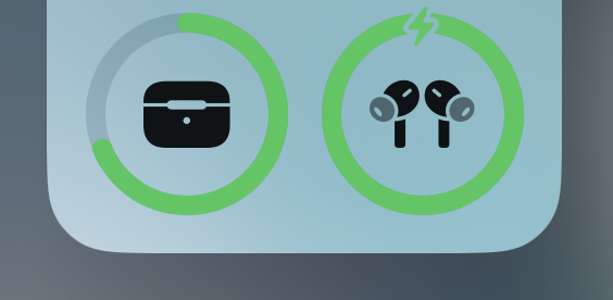

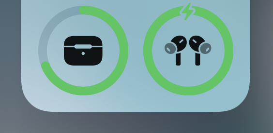

Didn’t work for me, followed your tip. The AirPods still appear to be charging and the case is draining even though the pods are fully charged. Not used in a week and it’s slowly going down more and more.
View attachment 2088707Didn’t work for me, followed your tip. The AirPods still appear to be charging and the case is draining even though the pods are fully charged. Not used in a week and it’s slowly going down more and more.
The AirPods with a green lightning symbol are fully charged. When the symbol is black they are actively charging.
