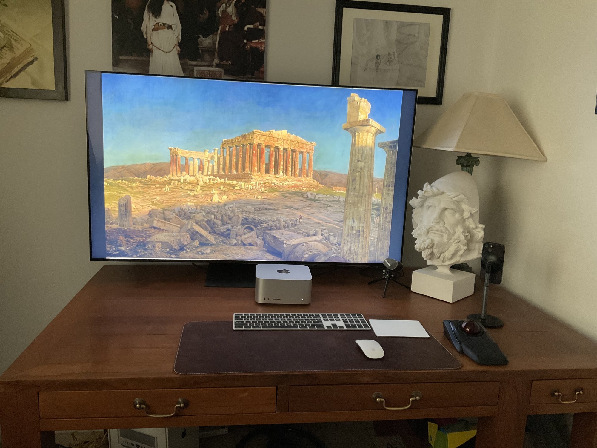

Just a heads up for people looking to get 8k TV as monitor: 55inch QN700B(not sure about A or C) is a way to go. QN900B IS NOT.
After seeing in-person QN700B, I've got 65 inch QN900B, thinking that it could be only better, but it was terrible mistake. There are shadows forming around text(pixel leaking to neighboring pixels), dithering is still there even with VRR(less but still there) and with VRR there is some kind of weird compression going on. Grey text on that chroma subsampling test image is showing rigged/multiple gradients of grey,.. There are also artifacts on text, visible on black text on bright background.

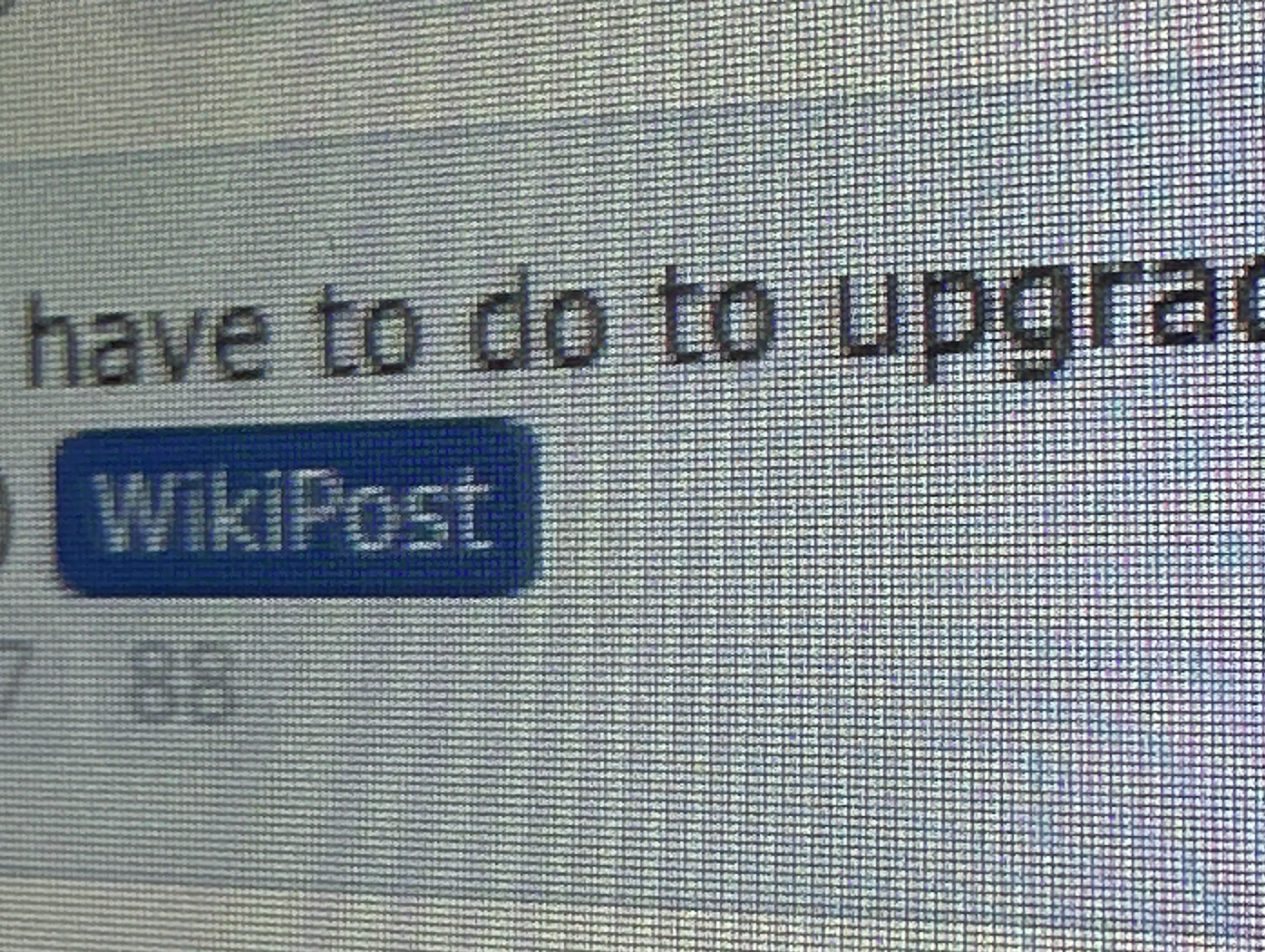

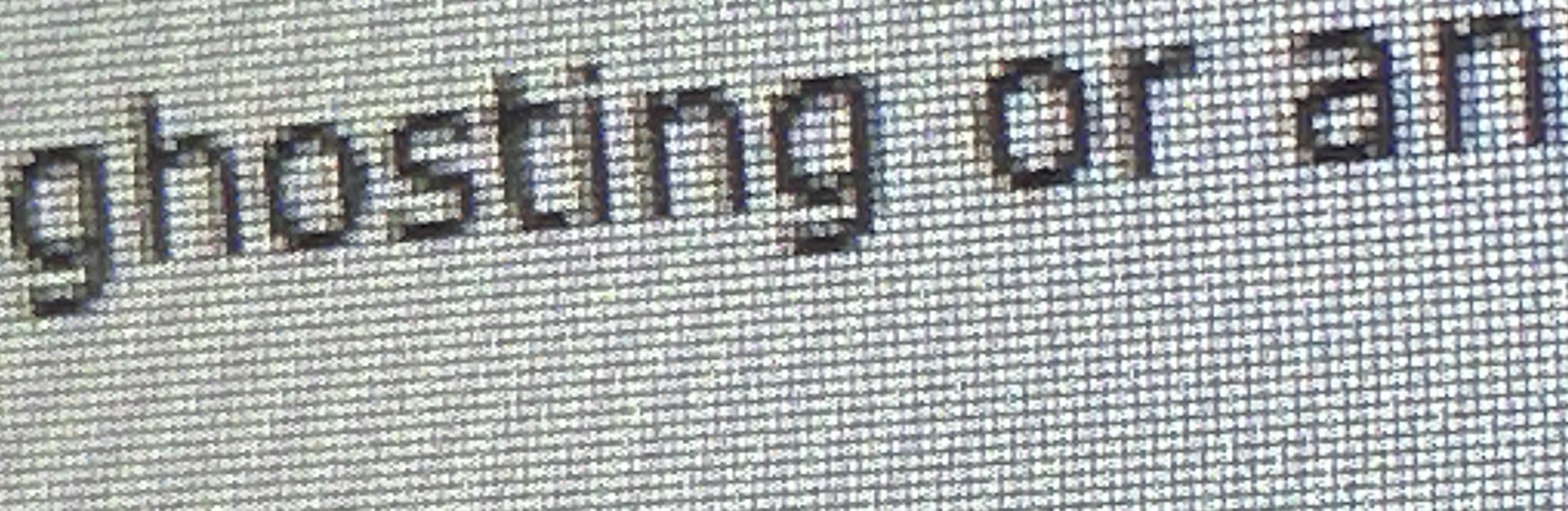

Here is picture of that shadowing around text:
With QN700B there is zero shadowing around text, with VRR dithering is gone and text looks good. I understand that on mac I can't get 444 with 8k60 but seems like it doesn't really matter that much when you have 8k.

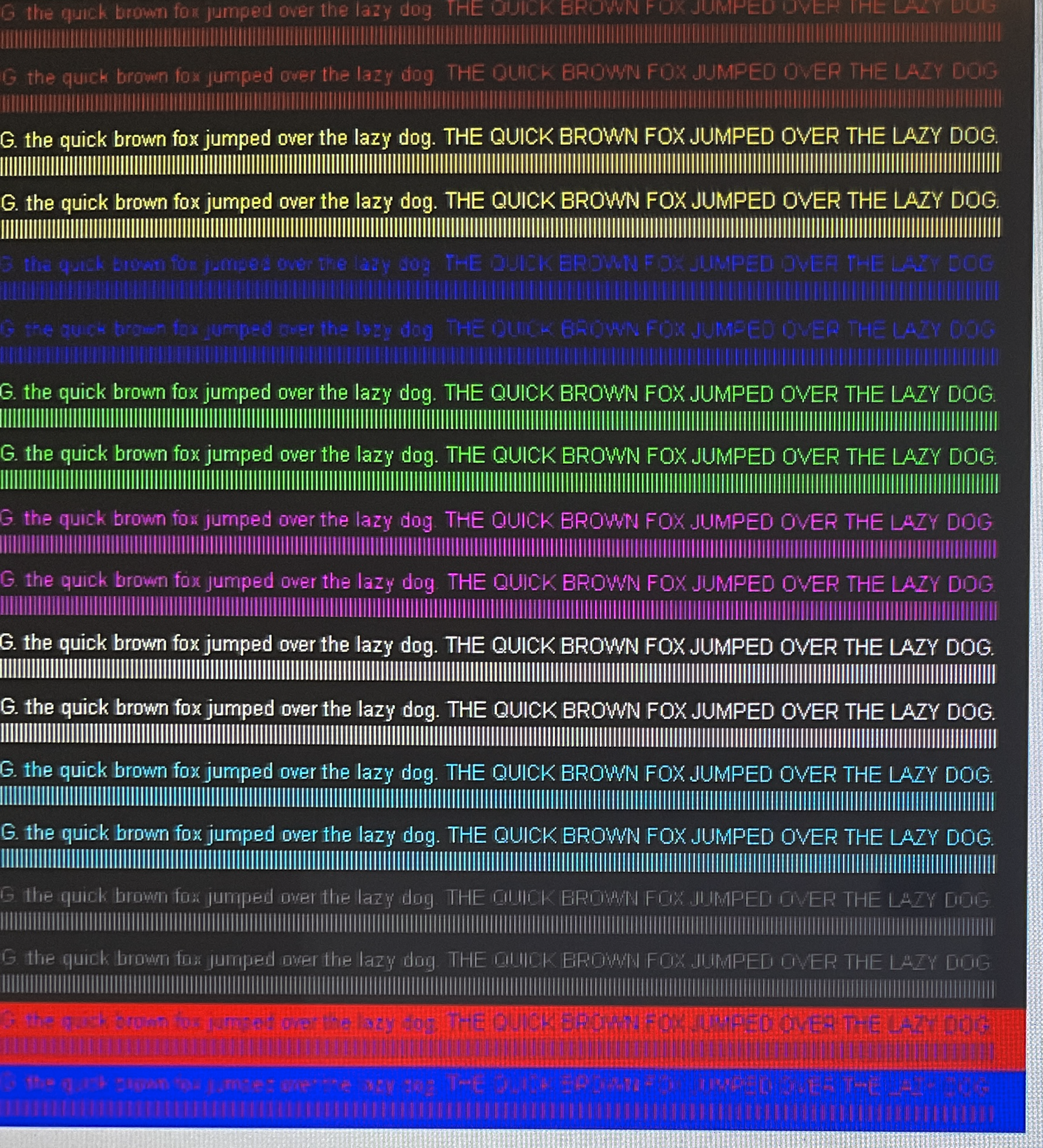

can you try this chroma subsampling test image, grey color row:
It is the most noticable on black background.
Also can you please check it with and without VRR? Enabling VRR introduces some kind of compression which affects grey color. Also when I enable GSync on windows, that pink chroma subsampling test image is not showing 4:4:4 anymore.

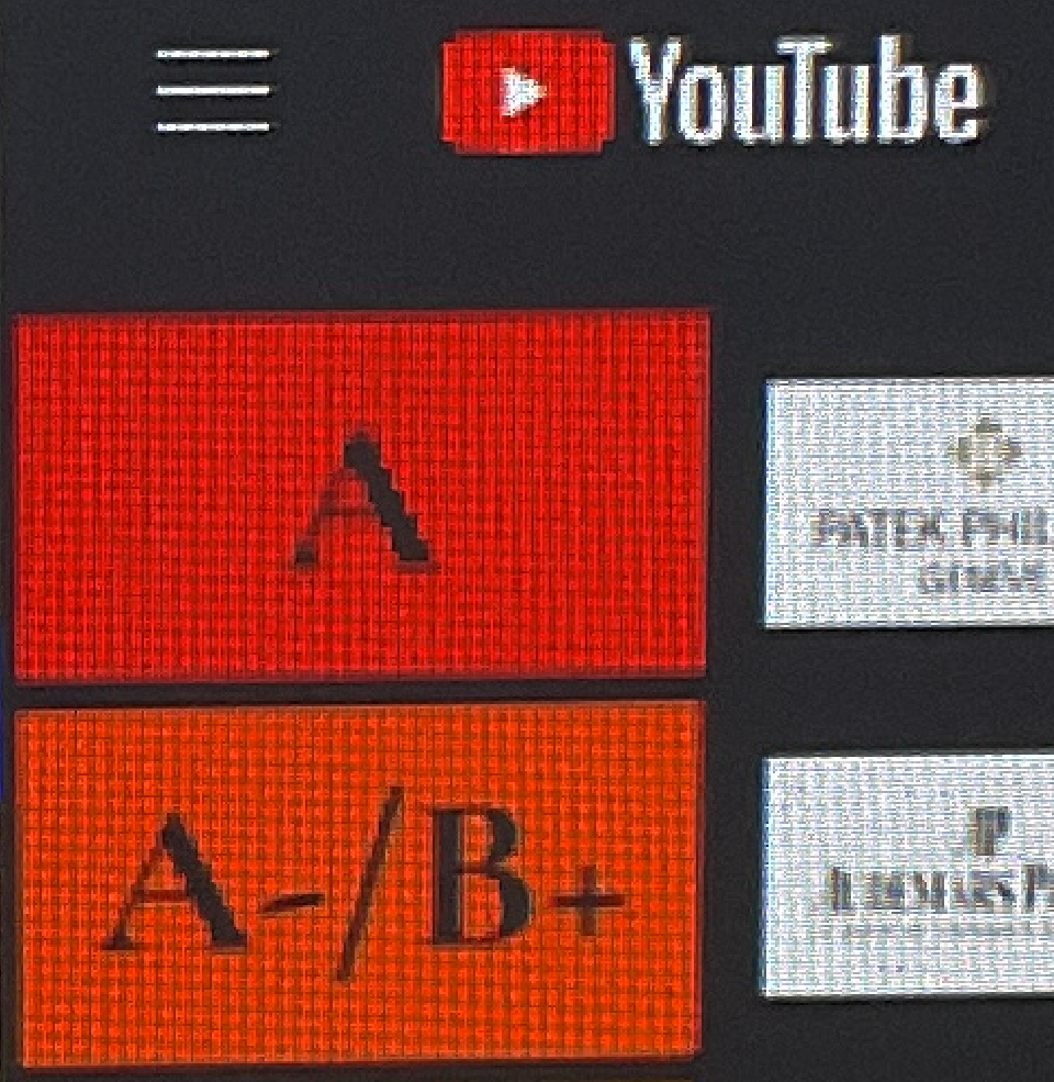

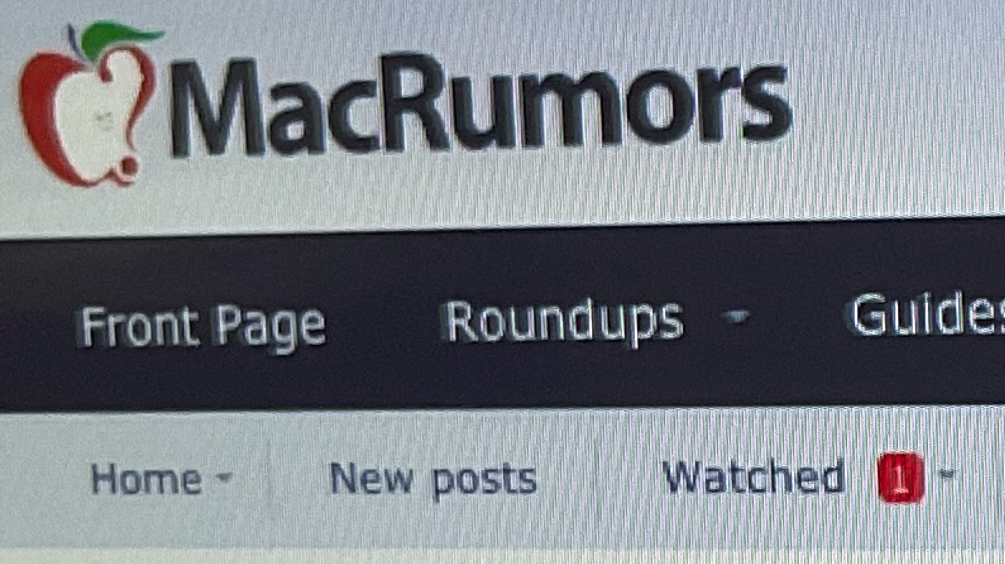

It photographs way worse than it looks in person, but yea the blue with red does look like poop on the screen. For example, the 'shadow' that shows up for the grey, aqua, white text in the photo, you just do not see with your naked eye. Also the blue the on red, generally shows up much better to your eye than to the photo.
That said, the red text on blue background looks like poop both on the screen and even worse in the photo.
The Red item in a surround like that is the only real artifact that does show up for me in day to day use. But it's strange, in that it's in very limited things. Like here is a screen shot of a watch video with Red lettering inside, and it's fine:
Also for this little red "watched" icon/number, it's really fine too:

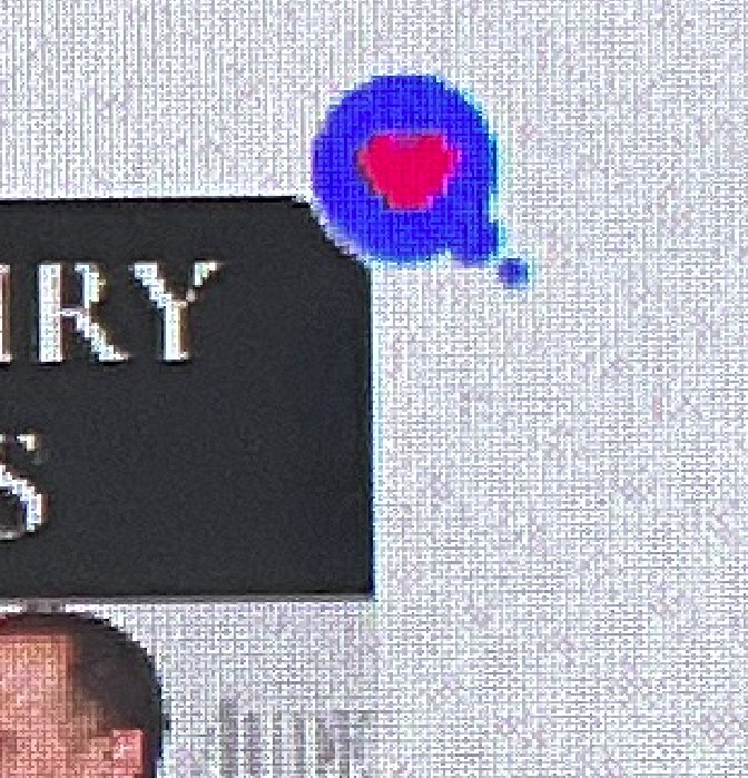

But it will in just one case really, look weird (now 2 with your red on blue text sample):
It's the heart tapback in messages, which is, surprise surprise, red on blue. It is a little muddy in the shape.
Anyway, like i said, I know it's hard to believe but you see none of that ghosting with you naked eye, thats a 'feature' of the camera.
That said, something is off when red is buried into blue. I'm guessing that's the lame chroma etc. coming through?
For me, this is truly a great screen because I value the space. It's very easy on the eyes, frankly better than my ancient 30" cinema displays and by a lot. But that artifact is annoying.
So it's still a driver cable thing, I think. I wish I could stop using this weird cable and just plug in the straight HDMI 2.1 to HDMI 2.1 cable I have, and I suspect that would fix it (and likely would in Windows). But it still doesnt work in Ventura last time I tried it (several versions back). I'm going to try it again after I upgrade to Sonoma to pray something improved.
Oh, and as for VRR, I dont know how to enable or try it. And again, I think this is working with 4:0:0 (or was it 4:2:0), not even 4:2:2, much less 4:4:4
I'd say that this looks pretty similar to mine(QN900B).
You can enable VRR on mac when selecting "Variable (48-60 Hertz)" option. I'm in PC Mode and Game Mode on during this testing. On mac I can also pick HDMI instead of PC, but it seems to be worse

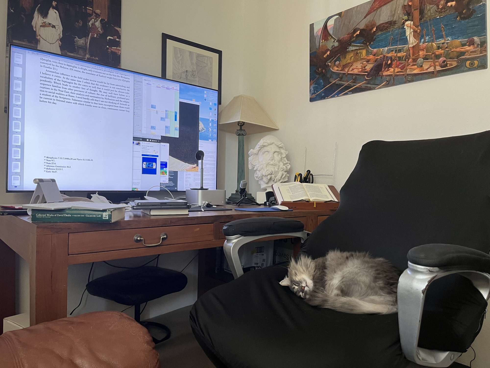

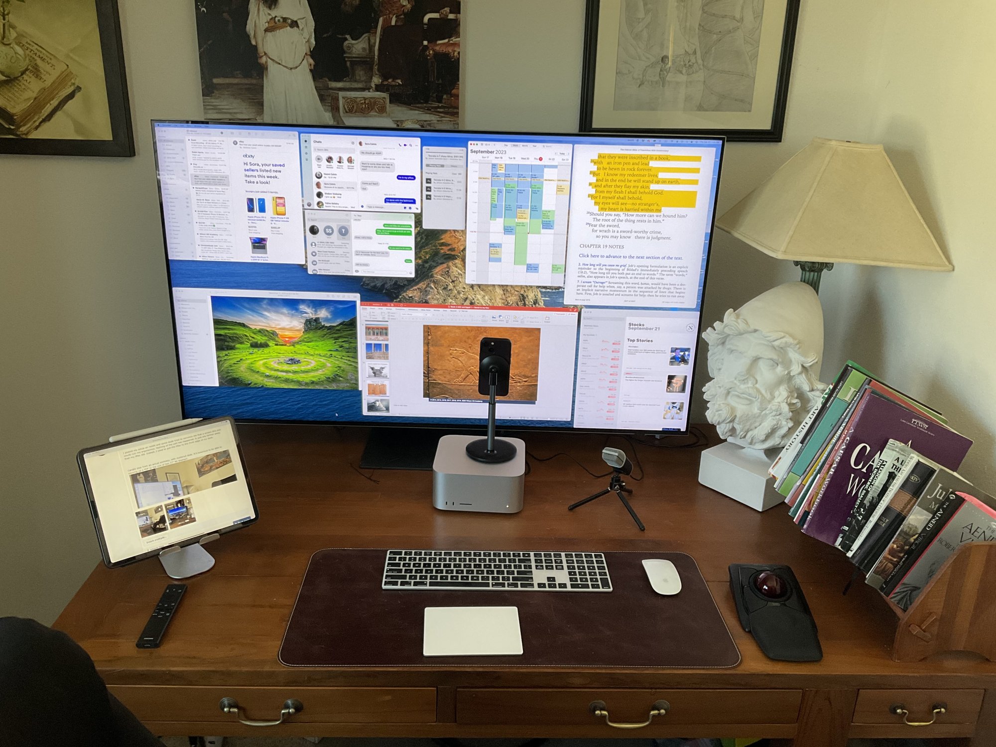

I’m three months in with my Samsung QN700B as a monitor for my Studio. It’s been wonderful.
Pros:
+ Text is sharp. Subpixel effects and ghosting are not seen.
+ 160 ppi is excellent at my usual distance (eyeballs 50-60 inches away from screen).
+ Color seems good to me. I haven’t investigated whether it’s 422 or whatever, but photos look gorgeous.
+ The seemingly endless screen real estate is luxurious. I teach high school classes on Zoom, and it is great to be able to have everything open at once: Zoom, PDFs, ePub books, and all the other apps I might want to look at.
+ The Rectangle app does a great job of managing windows.
+ The price (I paid $1000) is cheap for the pixels and screen size, compared to any monitor offering anything close to this resolution.
Cons:
- The screen is too tall. I tend not to use the menu bar, and spend most of my time looking at windows that I have positioned on the lower 2/3rds of the screen.
- With the screen being so tall, it won’t work to have a webcam on top of the TV. So I have a MagSafe iPhone stand that places my phone in front of the screen and I use it as a webcam via Continuity Camera. This sounds bad, since the phone is standing in front of part of the screen. In practice, however, it’s not a big sacrifice: since there’s so much screen real estate to play with, I don’t miss the few pixels hidden by my phone serving as a webcam.
- The TV does not wake with the Mac, so I have to turn it on manually each time. A real annoyance for those of us coming from an iMac.
- It isn’t quite plug and play. You have to adjust settings and turn on game mode and use VRR in order to avoid some hideous ghosting and nasty effects around text. Not too big a deal, though, since settings are preserved between restarts. Just ”set it and forget it.”
I’m considering mounting it flush on the wall for a cleaner look, especially if I can hide the OneConnect box and the cables for a totally wireless desktop.
I posted my setup on reddit and some dude tried to convince me that a screen this size would ruin my ergonomics. Nothing of the sort has happened. It just sits farther away than my iMac did. Indeed, I used to pull the iMac to the front edge of my desk.
Cleaned up:
Candid shot from an actual workday, with cluttered desk and wires visible beneath it. It’s luxurious to be able to blow up a PDF to the size of two 27” 4K displays:
