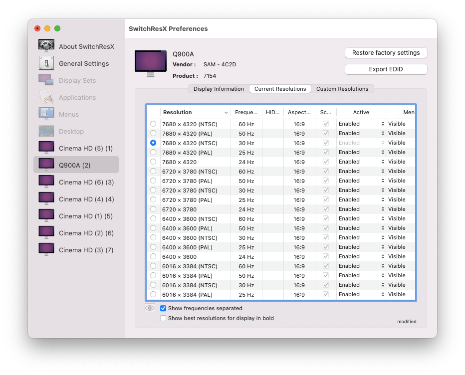

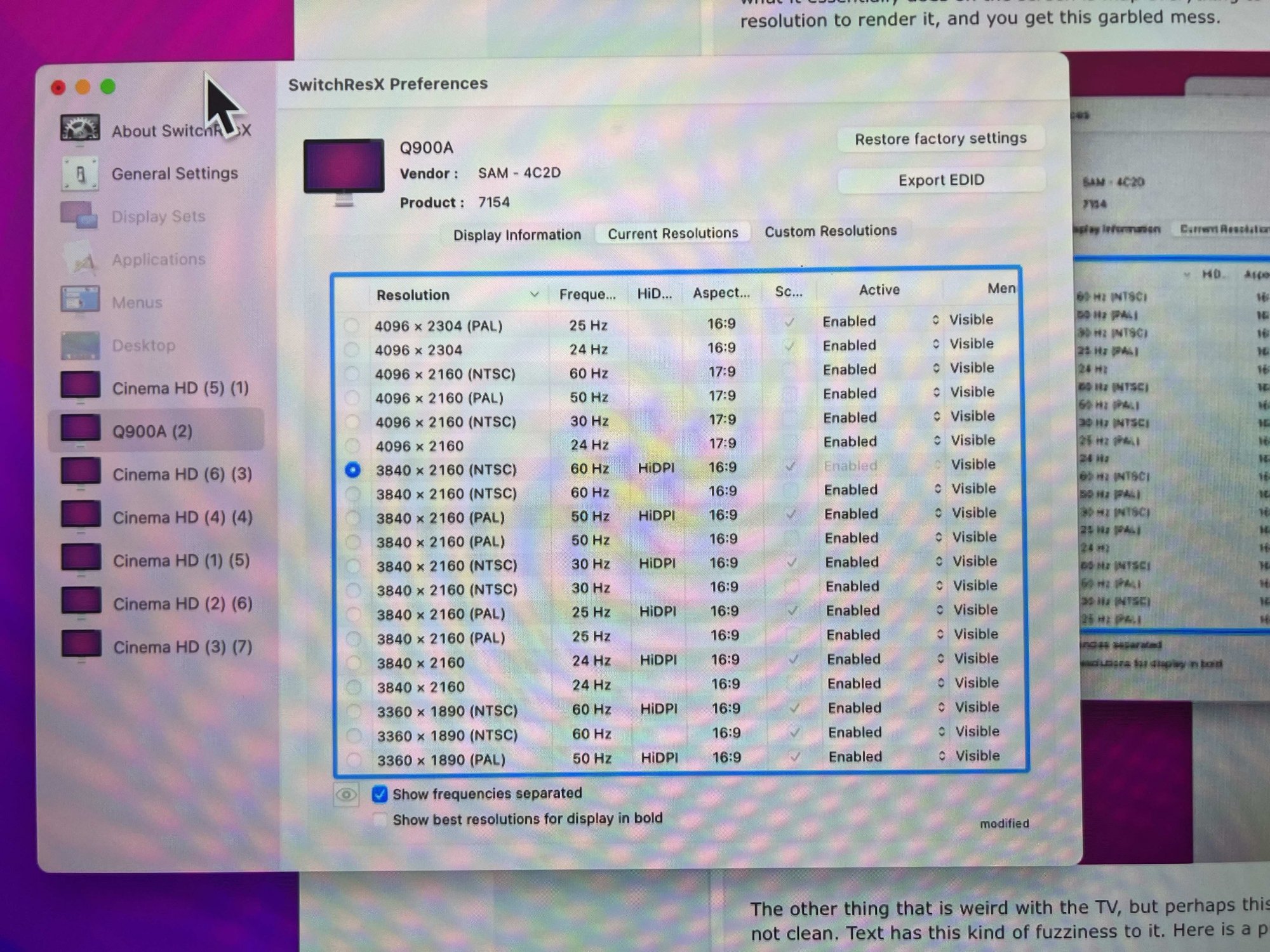

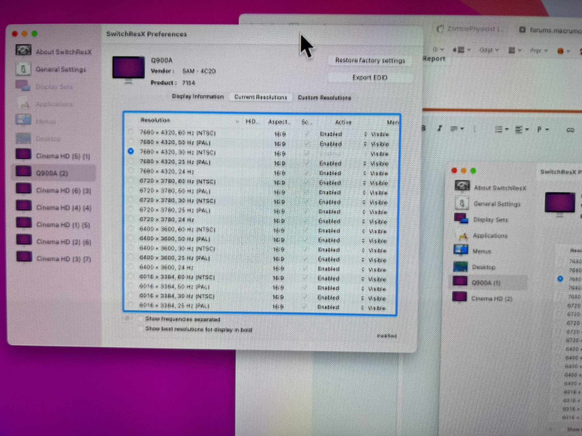

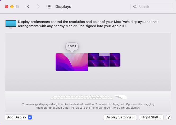

FakeAlmost8k: 8K is rastered by macOS but what gets pumped out to the TV is a 4k signal, but the desktop is shown as if 8k was working, but at a much lower resolution. I got this result if I tried 8k at 60hz, 30hz or 24hz (although I was mostly concentrating on trying to get 30hz working). This is what I mean:

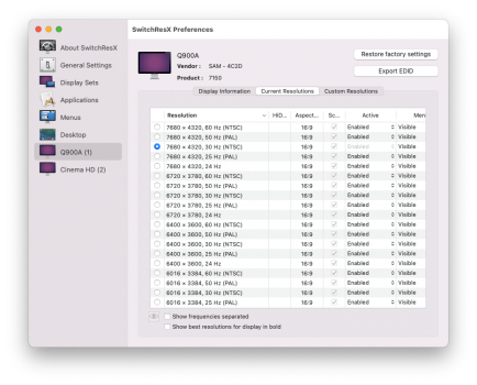

Here is a screen shot of the SwitchResX panel on the 8k display in 8k mode and it looks perfect in memory as a screenshot:

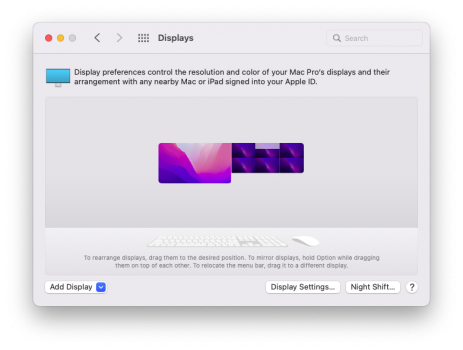

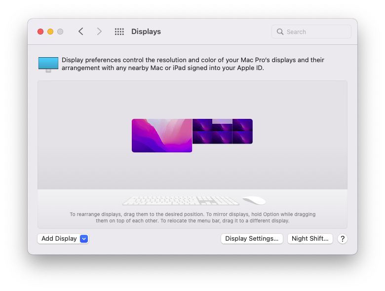

But, below, is how it appears on the TV. So you can see, while in memory it does hold a 7680x4320 image of the desktop; however, what it essentially does on the TV is map everything to the size as if it were that 8k desktop, but uses only 4k of resolution to render it, and you get this garbled mess. This essentially confirms/duplicates @Arvine 's experience.

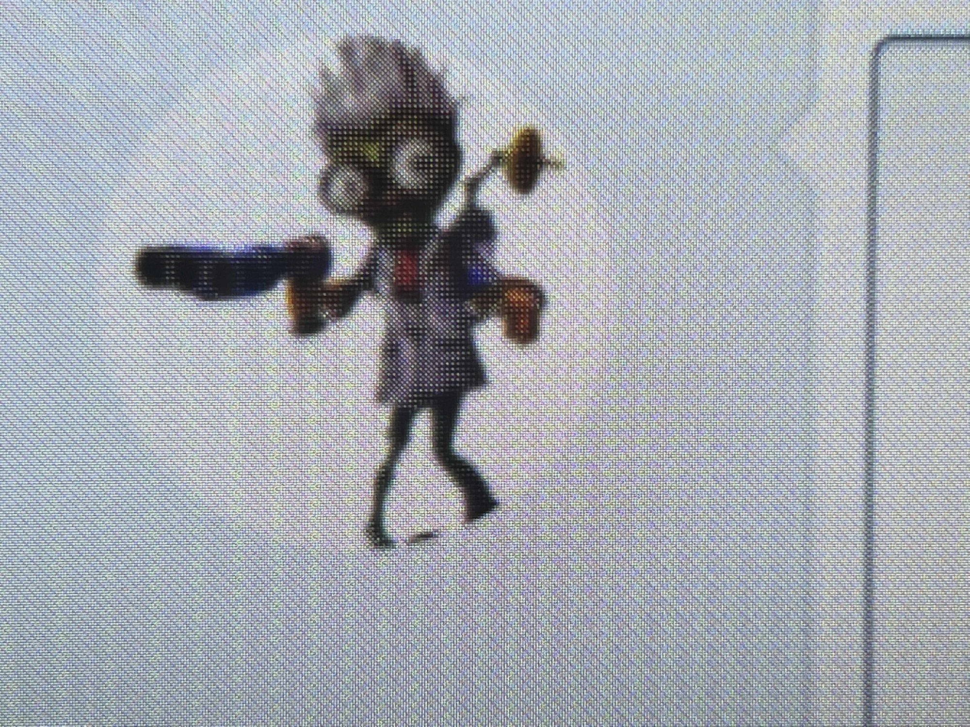

The other thing that is weird with the TV, but perhaps this is a settings thing, that even in 4k HiDPI mode, the rasterization is not clean. Text has this kind of fuzziness to it. Here is a photo:
For example, look at the check box, you can see its doing weird overscan/anti-aliasing.
One other thing, that even in this 4k mode, it's images get dithered rather than have pure colors, you can kind of see the halftone dots in my avatar:
Perhaps this is some setting in the TV or some weird effect of 4k on an 8k TV set?

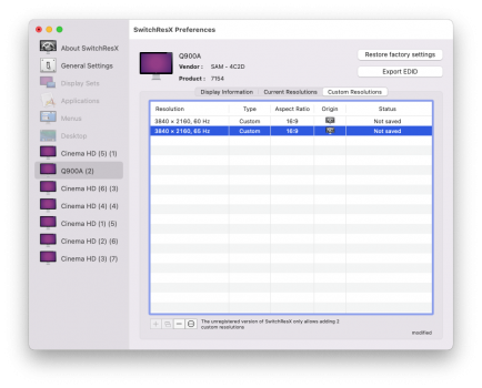

Just a quick followup. Messed around with BetterDummy and Resolutionator, and they really weren't obviously helpful.
So this looks like it's just an macOS driver being incomplete for HDMI2.1 issue. Basically we are at Apple's mercy for whenever they feel like making their drivers actually work with HDMI2.1 8k resolutions. Which is kind of crazy with them touting 8k work flows so much, and the damn Mac basically cannot actually (drive/output) an 8k DISPLAY. Nuts!

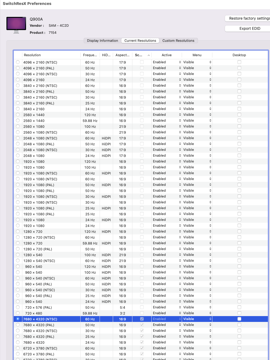

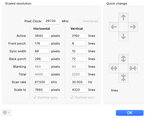

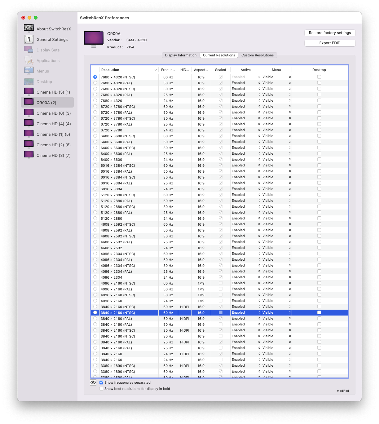

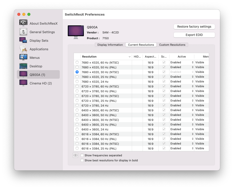

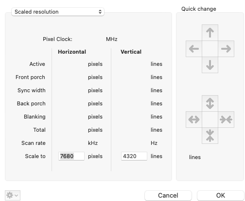

You can see in SwitchResX that all the 8K modes have the Scaled checkbox. If you double click each of them, it will show the pixel clock is like ≈600MHz and the active pixels is 4K.
It would be interesting to see the resolutions sorted by Scaled so we can see what modes are not scaled.
Don't TVs in general have this screen door effect? They're usually supposed to be viewed from the couch at least 6 feet away.

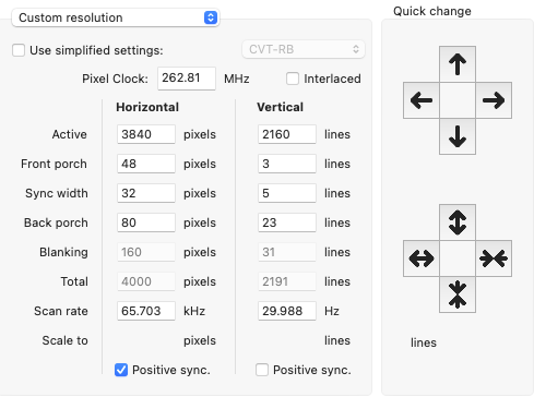

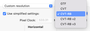

So here are the resolutions by scaled vs non scaled:
So all the 8k resolutions basically shown are scaled, and many of the 4k resolutions too:

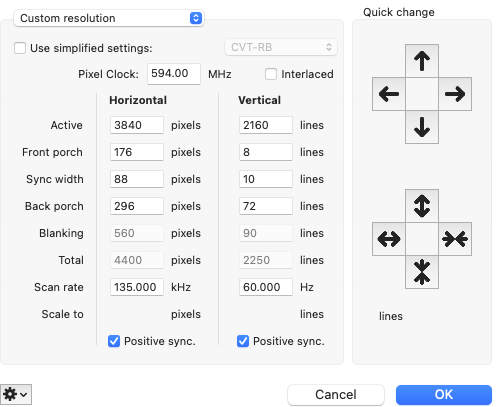

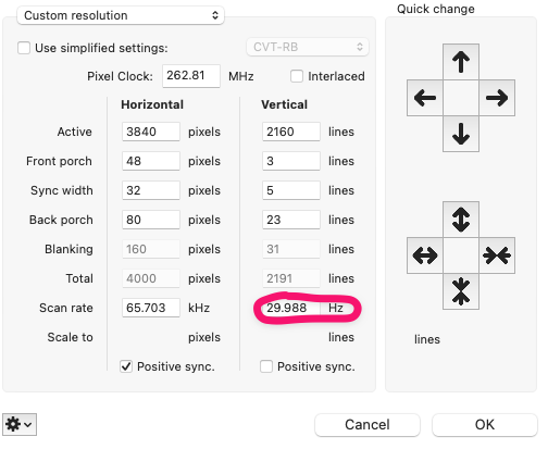

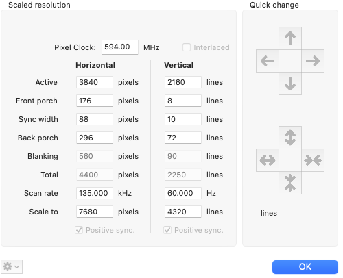

When I double click the 8k resolution @30hz, I see this:
And @60hz, I see this:
As for AGDCDiagnose output files. I'd be happy to do it, but I dont know what it is, or how to make the files. Would appreciate a pointer on how to get it done.
As for if all TVs do this "screen door effect" not sure. I think it's a function of scaling modes. When I plugged in my OLED I don't remember this effect, although it was just a 4k screen. But you may be right, I'm not an expert on the TV side of things.

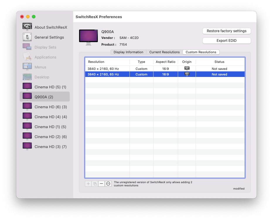

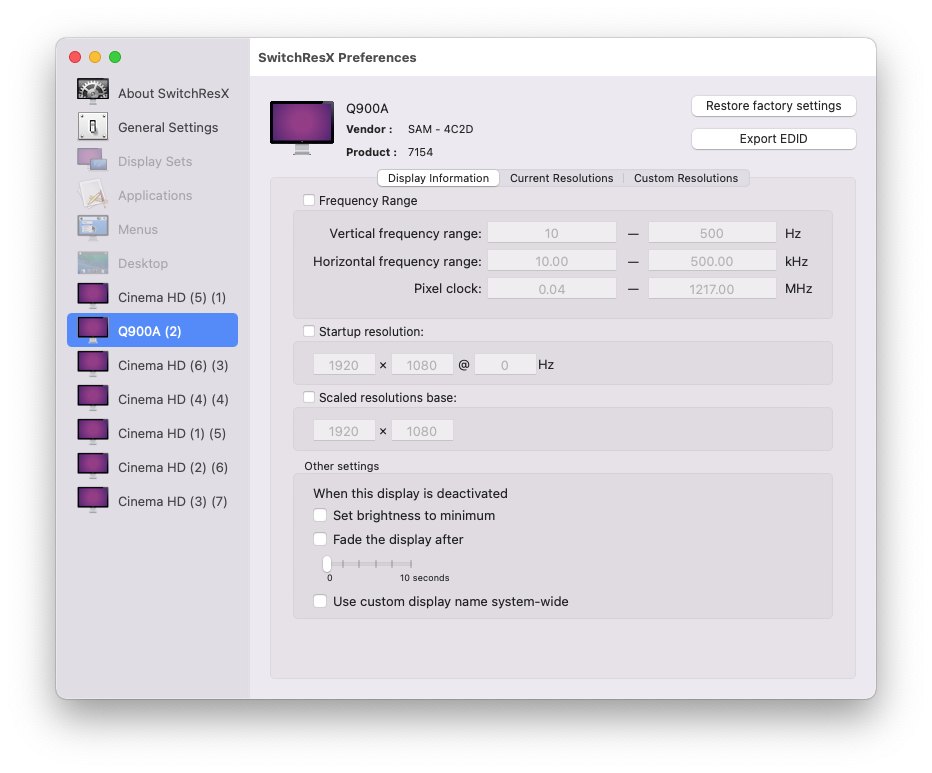

Also, can you show a screenshot of the Display Information tab in SwitchResX? Check each connection tab to see if they all show the same info. I am wanting to see what it says for the frequency ranges in each case and we can compare that with the frequencies in the AGDCDiagnose outputs.

This is the display tab with the resolution set to 8k@30:
So when do I run that? Before or after I plug things in for each type of connection? I'm guessing after, but want to make sure. Thanks!
After. We want to see the connection status, pixel format, and EDID of the display which can't happen until after the display is connected.
Which GPU and port and adapter is that for?
It says Pixel clock max is 1217 MHz. For 8K60, we'll probably need a pixel clock of 2376MHz (the EDID will show what pixel clocks the display expects) so override the value in SwitchResX with something like 3000 MHz.
But that's probably not the problem - 8K30 only requires 1188MHz.
Also, do you have Catalina? I want to make sure the problem isn't with Apple's change in support for DSC. Well, that won't work with the 6900. And the 9100 doesn't support DSC since it's a VEGA card so never mind.
I am wondering how it calculates a value of 1217 MHz. HBR3 limit is 1080MHz for 8bpc but DSC @ 12bpp would allow 2160MHz. 8K60 isn't going to happen unless the TV allows a timing that is more like CVT-RB (2090 MHz) instead of HDMI (2376MHz) or if macOS allows DSC @ 8bpp (which allows up to 3240 MHz)
HDMI 2.0 limit is 1200MHz using 4:2:0 8bpc (effectively 12bpp).

Ok so a big update. I got my screen, I got my card, and I tried a bunch of variations.
Thanks for confirming this. I had the same results..
The dithering may be the dots of the TV, each “pixel” is built up by three physical dots, RGB.
As for custom resolution, if you tell me what to put in here, will happily test it:

Also, the 12bpp, that may explain the dithering/halftone I'm seeing!
For the 4K refresh rate test, use CVT-RB, 3840x2160 60Hz, then duplicate it a dozen times and for each one increase the refresh rate by 5.
The 12bpp doesn't mean it's doing 4bpc. It's an average.
For 4:2:0, there are 8 pixels in a 4x2 arrangement, which has 8 luminance values but only 2 Cr and 2 Cb components - 12 components total where normally there would be 24. In the case of 8bpc, each component is still 8 bits so you still get millions of colors. There's just half as many components (it's just lower resolution except only for the color info - a grayscale image will have full resolution).
DSC also does not reduce bpc. It uses a compression method that is smarter about what information it throws away compared to chroma sub sampling.
Basically, if the image is of a single color, 4:2:0 and DSC will not use dithering.

Some interesting stuff. I don't see any problems.
You have 1 Cinema Display from 2006, one from 2007, and four from 2010. The one from 2006 doesn't support HDCP but your Apple Mini DisplayPort to Dual Link DVI adapters don't care, unlike third party or new USB-C to dual link adapters which must have an HDCP OFF firmware to work with the 2006 model. The EDIDs are otherwise identical (except for serial numbers, dates, and different product number and white color for the 2006).
The EDID of the TV is unchanged in the two tests (since you did not change the port used or the TV settings).
It appears to be connecting with HDMI 2.0 modes:
1) 3840x2160 60Hz 594 MHz, 4:2:0 10bpc HDR10
2) 3840x2160 30Hz 297 MHz, 4:4:4 10bpc HDR10
The modes from the EDID that we want to have working are these:

Sorry, this is going a little over my head. Apologies. I know it's frustrating trying to remote control from across the internet, particularly when I'm a dummy on this. I really appreciate all the help!
When you make a custom resolution the above is the starting point. Do you want me to start the highlighted vertical scan rate at 60hz, and then increment it to 65, 70...120hz and leave all other setting shown there the same?
Assuming that is correct, what do I do once I create the custom entry to try it with the TV? there seems to be noway to engage that mode in SwitchResX?
Lastly, someone suggested that there might be a way to use Picture by Picture mode or something like that on the Samsung TV where I use 2 cables. Basically make half the screen screen one powered by one input cable, and then the other half of the screen powered by another cable.
Not sure the Picture in Picture thing would work, but it was an interesting thought.
