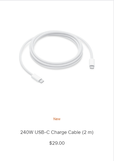

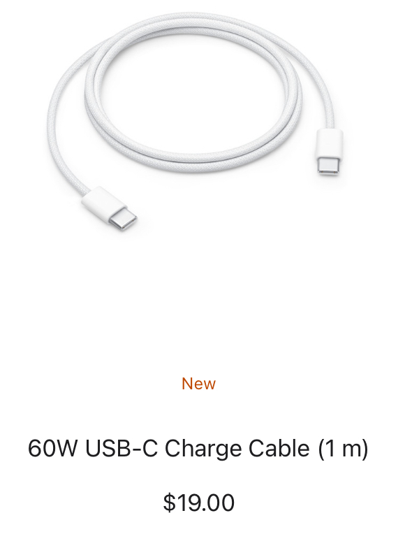

Was that in the store or on the store site? Yep. Full description is:
"This 1-meter charge cable is made with a woven design — with USB-C connectors on both ends — and is ideal for charging, syncing, and transferring data between USB-C devices. It supports charging of up to 60 watts and transfers data at USB 2 rates. Pair the USB-C Charge Cable with a compatible USB-C power adapter to conveniently charge your devices from a wall outlet and take advantage of fast-charging capabilities. USB-C power adapters sold separately."
Was is also interesting is this: and it has USB 2 data speed.
Does Apple sell a USB C USB 3 cable?
Don't think so. Apple has switched away from USB-A as their standard pack-in for awhile now. IIRC, the last iPhone generation with a USB-A cable was the XS/XR. All iPhones since then (until the 15) has been using USB-C to Lightning cables.

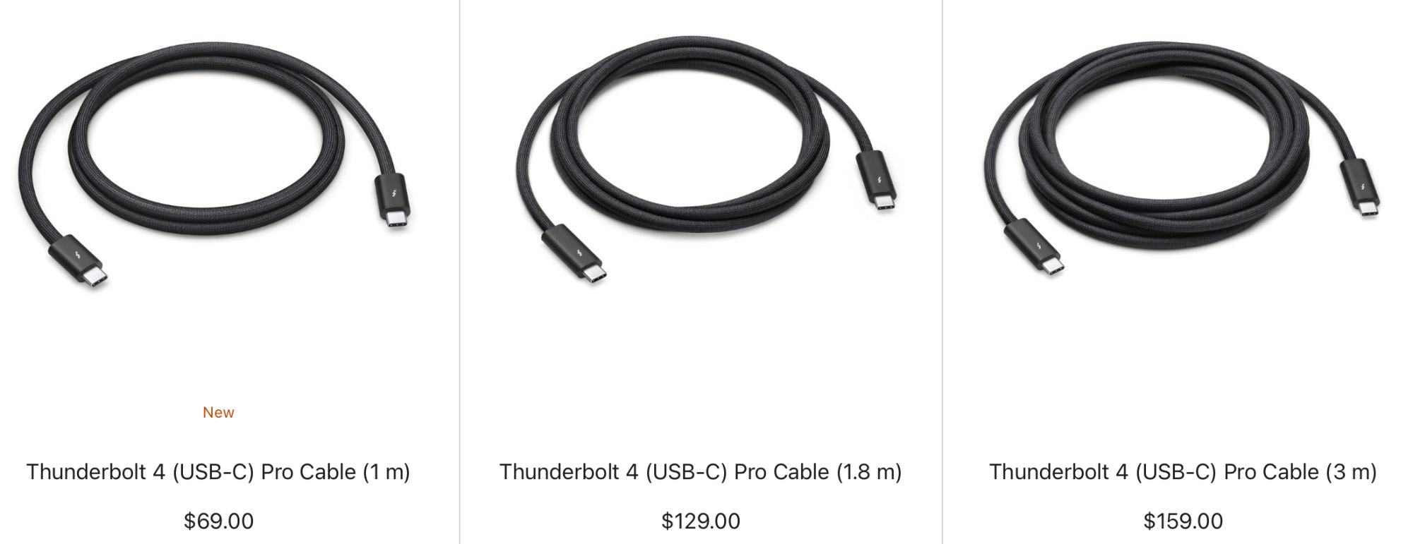

They do sell Thunderbolt cables that transfer data at USB-C 3 and 4 speeds.
Bummer. For a short cable I like the braided one - just wish there was USB 3. 3rd party it is. 😉
