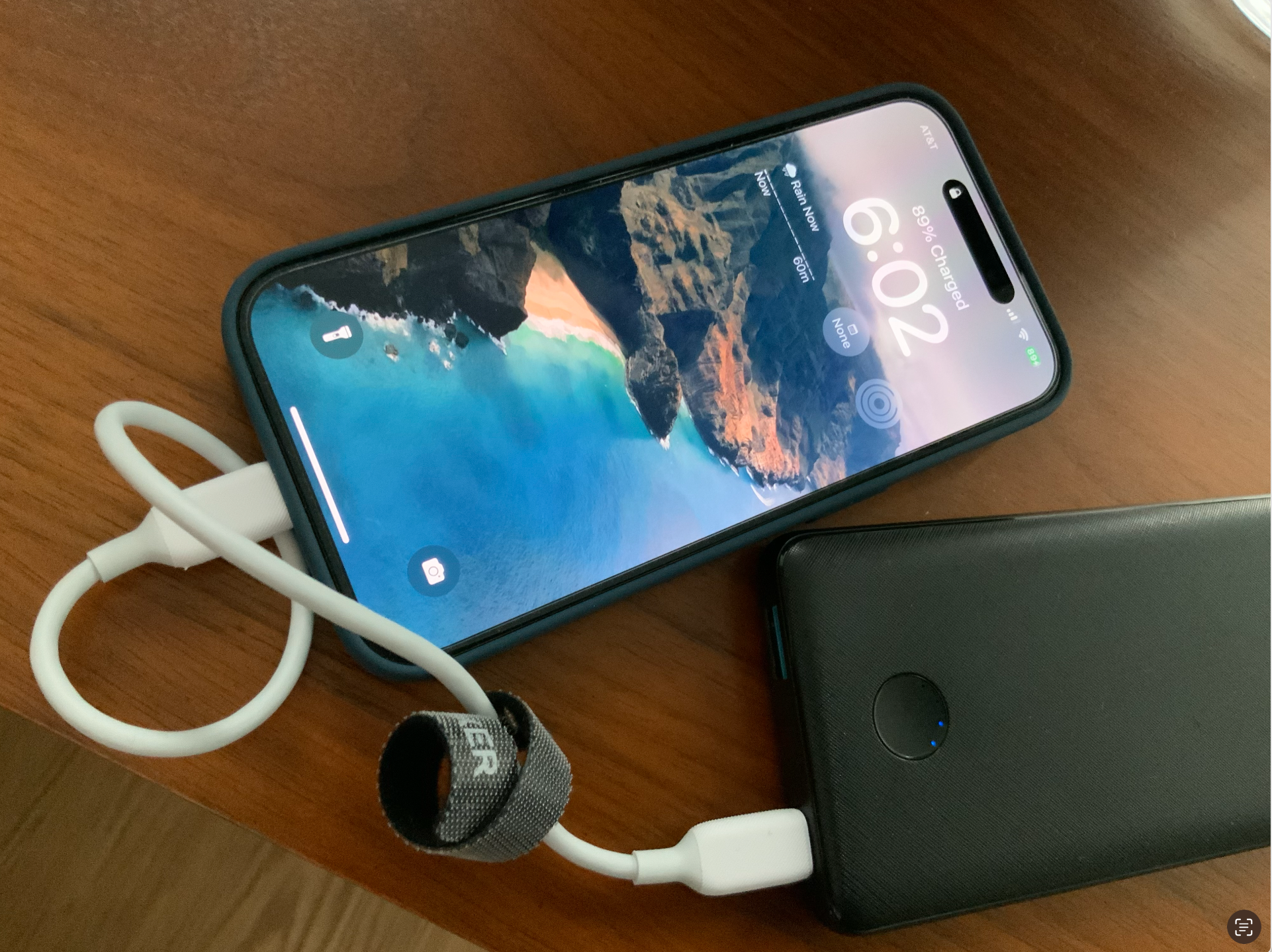

That proves nothing. I suggest you take a picture of the iphone AND the charger in the same picture showing the charge symbol on the iphone.
What would I gain lying about it? I suggest you take a look below at Post #41 in this thread before you chirp... 🥴🤫
Anker with 2 of 4 lights (assume 50% charged) is charging 89% charged iPhone.

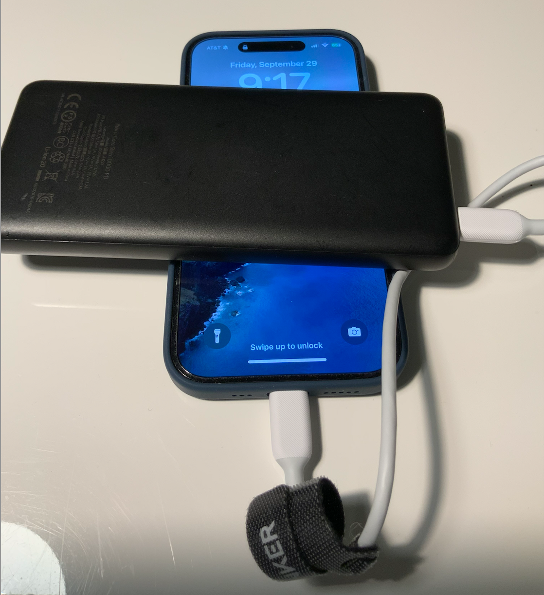

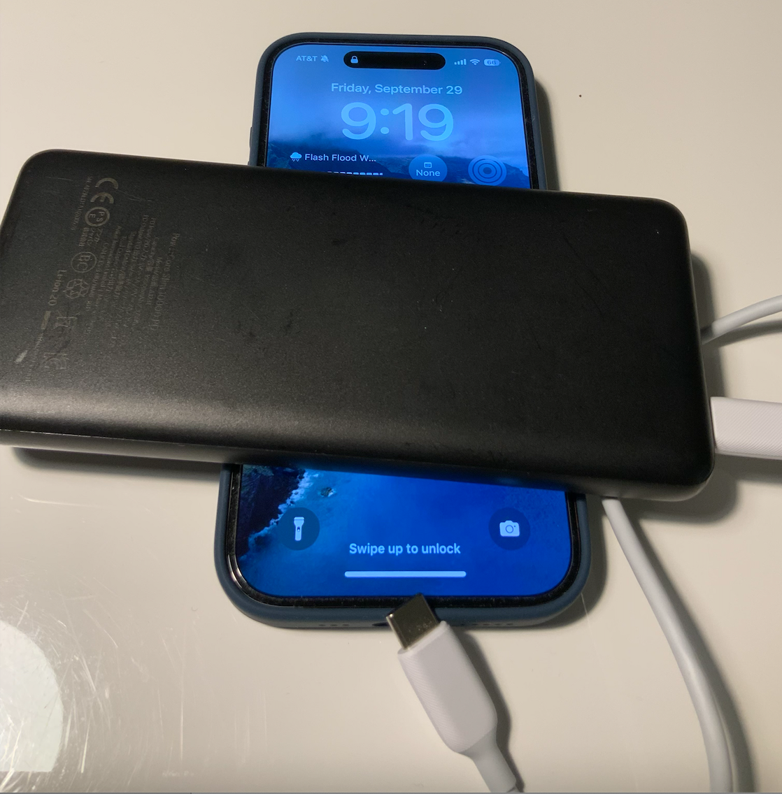

Weird, then what’s this article talking about? Is it charging consistently as far as you can tell?
From what I can tell, mine is charging consistently. Pictures from a few minutes ago. Including the Anker model information as well (Powercore Slim 10000 PD).
Post #41 also shows the power bank with lower charge (50%) charging iPhone with 89% charge.

Have that exact model listed in the article...mine is charging without an issue via the USB-C on the Anker 🤟

I also have this model and just tested it this morning. It charges the iPhone just fine. I used the cable that came with the phone.
I was going to post a picture of the phone charging but it’s set to 80% max so it flashes charging and then stops.
