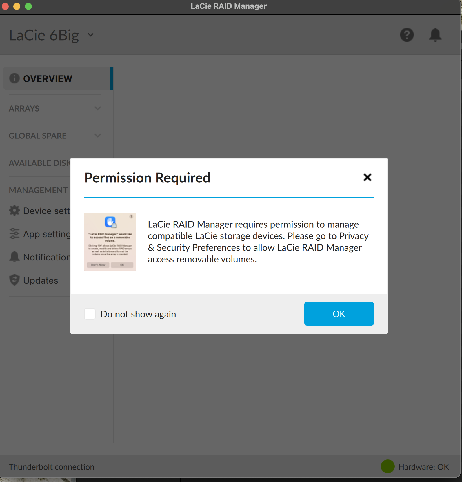

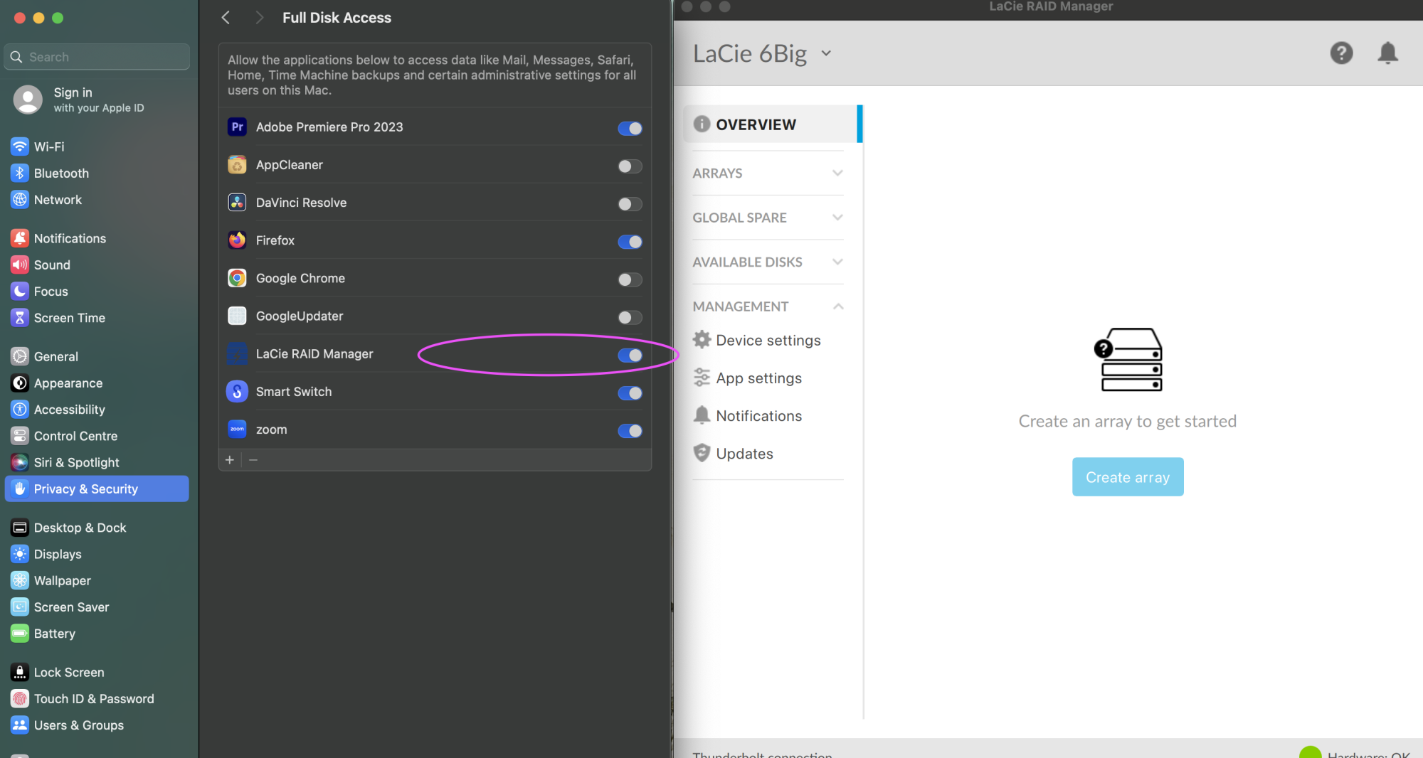

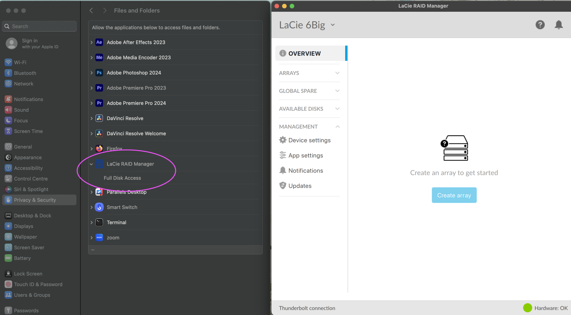

Dear All, Anyone able to help with LACIE 6Big 24Tb |Macbook Pro M2Max
I was able to mount and worked few weeks ago and now its asking for permission again, not sure what else to do. Please see below screenshots.
