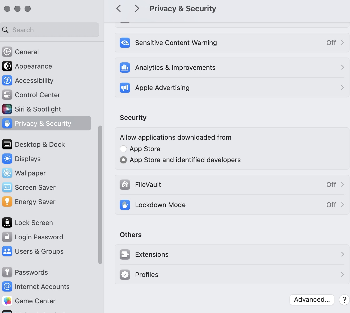

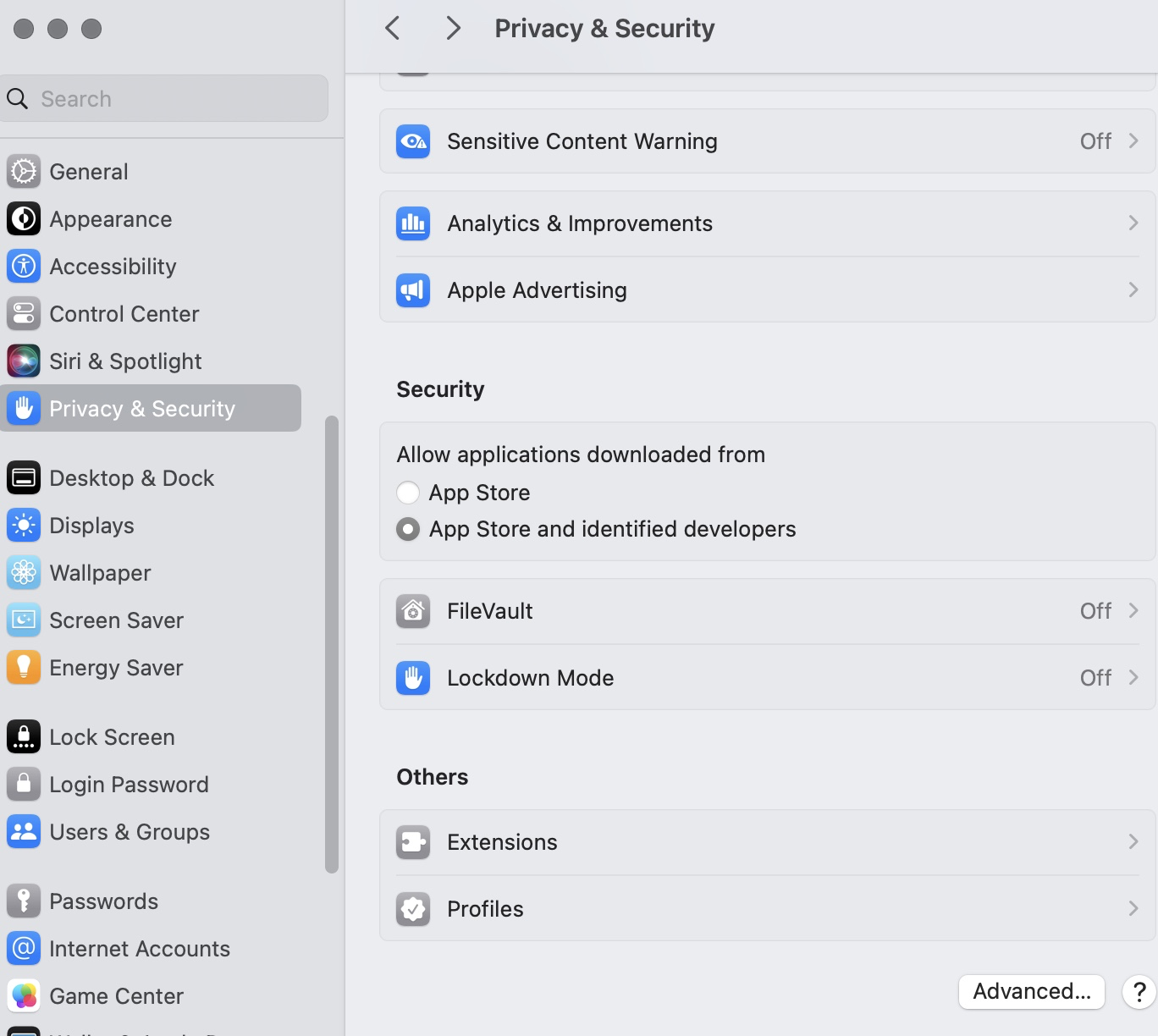

Thanks for your help. I was able to navigate to privacy and security but can't find "allow accessories to connect". I checked all the menu options and can't find it. Am I blind?
This is what I see. I have checked under every tab.

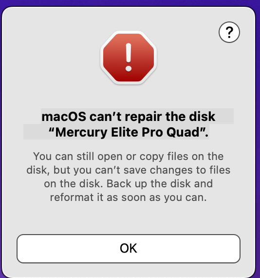

Yes, I was in the process of copying all my files from DROBO 5d3 to a new OWC Mercury Elite Pro QUAD/ and got this message:
macOS can’t repair the disk “Mercury Elite Pro Quad”.
You can still open or copy files on the disk, but you can’t save changes to files on the disk. Back up the disk and reformat it as soon as you can.

It is really messed up now, because I cannot save anyting to it. I tried to save something and got another msg:
The document “macOS can’t repair the disk “Mercury Elite Pro Quad”. You can still open or copy files on the disk, but you can’t save changes to files on the disk. Back up the disk and reformat it as soon as you can
..png” could not be exported as “macOS can’t repair the disk “Mercury Elite Pro Quad”.
You can still open or copy files on the disk, but you can’t save changes to files on the disk. Back up the disk and reformat it as soon as you can..png”. The volume “Mercury Elite Pro Quad” is read only.
I cannot use it as my DROBP replacement now, as it is hosed up and won't save anything to it. It is just another unusable drive. I want to get rid of DROBO and have a real back up, but now I have to go buy another one. What a lousy product this is. I should have spent more money on Synology. I do not need a NAS buy a SAS
WHAT? out of the blue. I knew something was up with it, when it just DISMOUNTED TODAY AND FREAKED ME OUT. WHAT A WASTE OF MONEY.
The problem that caused drives to not mount was a bug specific to the first versions of Sonoma that is fixed in the current versions. It affected all drives of any brand (WD spinning disks and Samsung SSD for me). The symptoms were not what you’re seeing, but not mounting at all.
What you are experiencing doesn’t mean you need to throw away the drive. Was it disconnected from the Mac before unmounting? Did it suffer a power outage while being used? Did you ever get a message saying the disk was unplugged while the Mac was sleeping or unattended? There are many ways a drive can become corrupt. Some may be related to failing hardware, but others may be what I said above, just an unclean disconnection or power down. The OS is doing the right thing, telling you the file system is inconsistent and refusing to allow you to save your data there (as it may be lost) and advising you to copy the data to somewhere else while you can.
I would copy whatever I needed out of it, and reformat it. Then you can use it again. If the problem comes back during regular usage (assuming you didn’t unplug the cable before unmounting, or not suffered a power outage during active use) then you can probably assume there’s something bad with the hardware (start by replacing the cable if the drive happens to disconnect by itself while in use). If it’s a one off, it’s fine. I have drives with many years of use that corrupted once or twice occasionally due to the OS being buggy and loosing the USB connection during sleep. They are fine.
This means that the volume's directory is likely damaged. Can happen for multiple reasons, one being an unexpected shutdown or loss of connection. Open a ticket with the SoftRAID and they can help you out!
