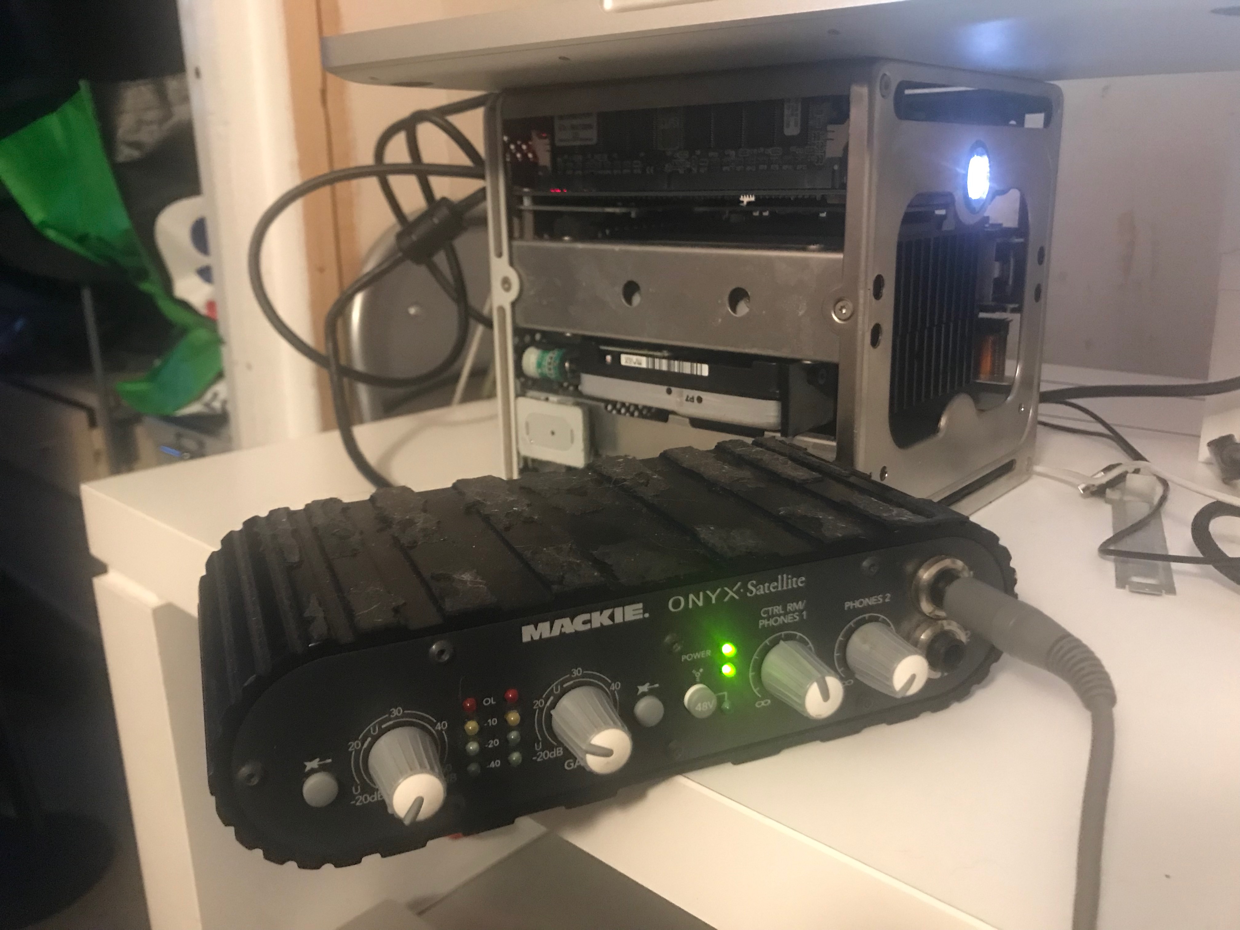

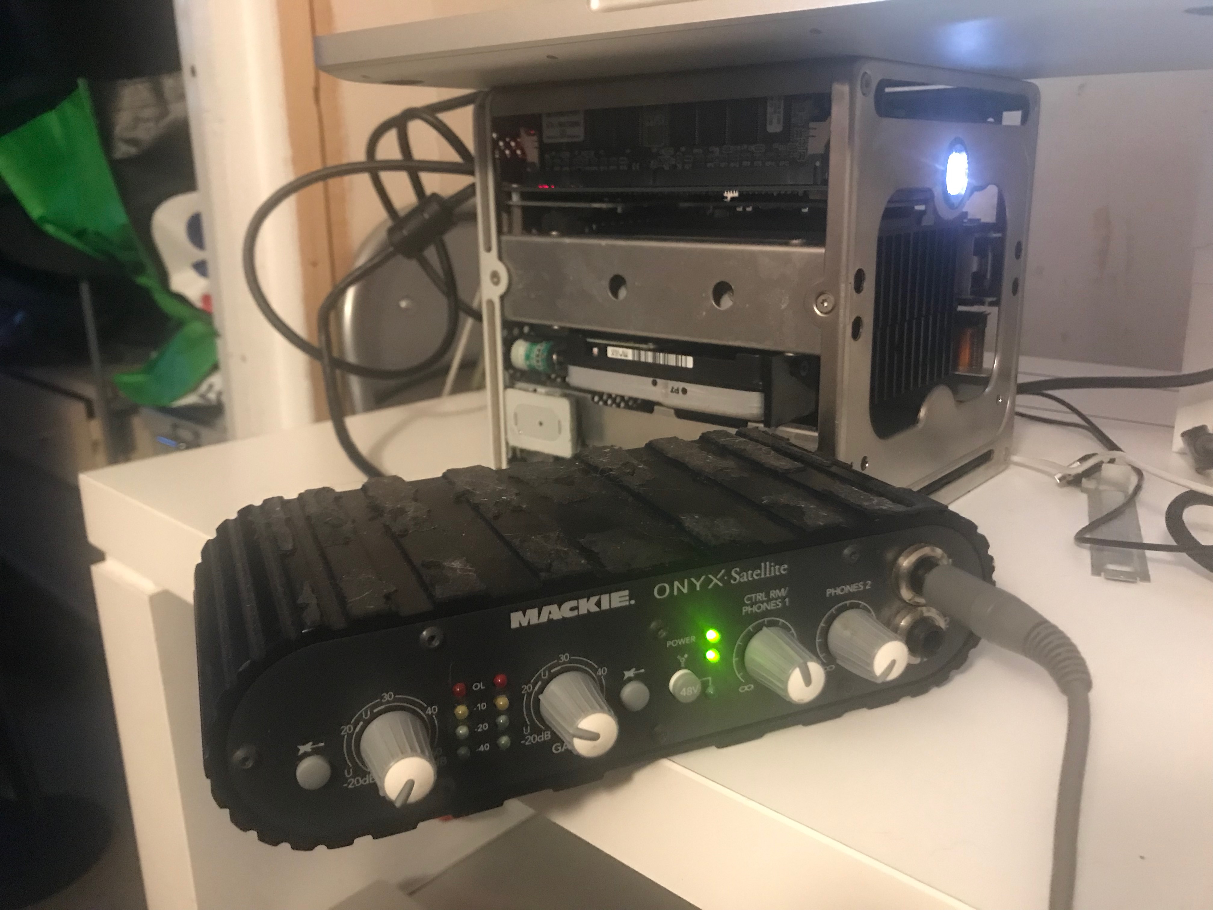

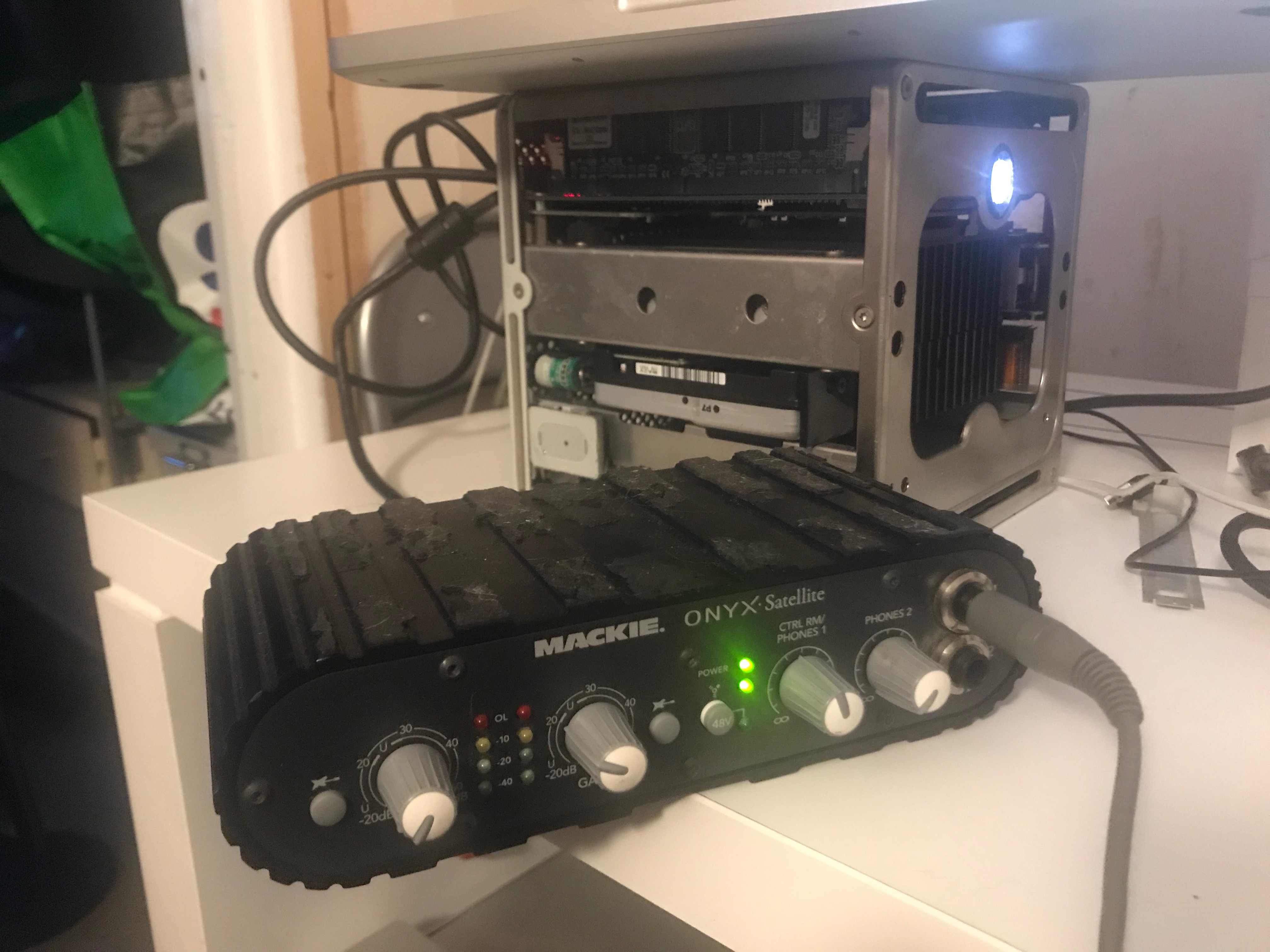

I didn't think this would work but I just plugged an old firewire sound and it worked without having to install any software; Core Audio BABY! :apple: <3
RESOLIVED!
Thanks guys.

Oh, that looks like high end pro stuff.
Thanks - havn't been aware yet, that there is great FW-stuff to enhance audio-in/out for old Macs!
