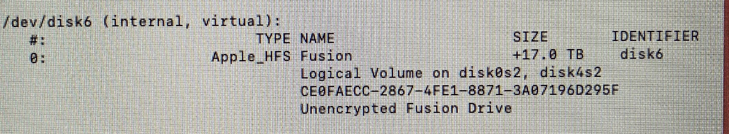

Hello everyone,
I'm a media composer. I am using BigSur, my system is installed on 2TB m2 SSD.
I want to speed up my 16 TB Exos Seagate sound library archive with another 1 TB m2 SSD via FusionDrive. So I will not install an operating system.
Since "cs storage" is not working in BigSur anymore, I connected two disks to another computer and applied the following commands via HighSierra at terminal. And I created a FusionDrive. (I guess)
Code:
diskutil coreStorage create myLogicalVolGroup /dev/disk1 /dev/disk2 (SSD first)
diskutil coreStorage createVolume lvgUUID jhfs+ "Fusion 100%
But at this point, I want to confirm if I did it right, before I loaded the whole backup.
What I want is to use 16TB of space and speed it up with a 1TB SSD. But I'm not sure if I did it right by marking 100%. I mean the part I'm stuck with is the last percentile. It was 17TB of space. In other words, I didn't understand whether the speed will decrease after passing 1 TB. I want the SSD to have an effect on the entire disk, like a kind of cache.
Thank you.

Thank you. Do you remember this Terminal command ? I think, it would be great for me.
I had a corestorage DIY Fusion drive with 500GB SSD and 2TB HDD, and it was wonderful (it was my boot drive). After setting it up I verified it was working as expected with the 'iostat' command. My method may not be as practical for you because it involves filling the SSD, but here's what I did:
Use diskutil list to get the device IDENTIFIER of each part of your Fusion drive.
Run this command in Terminal.app, replacing the '2' and '3' with your Fusion disk numbers: iostat -d -w 2 disk2 disk3
Now, copy more than 1TB to the Fusion drive. Watch the 'iostat' output. The first 1TB will show high MB/s transfer rates to the SSD device number. After the SSD portion of the Fusion drive fills up (actually, a 4GB buffer is left empty), data will be written to the HDD device, and you will see a sudden drop in the MB/s transfer rate.
This proved to me that the Fusion drive was operating correctly. Once the SSD is full, you can re-test with a 5GB file (for example), and watch the 4GB be written to the SSD buffer, and the remaining 1GB to the HDD. Great fun!
Also: I haven't tried yet, but I believe you can set up a DIY Fusion drive on Big Sur using APFS. I don't recall the exact commands, but they would start with 'diskutil apfs....' It's on my list of things try out -- I loved my old Fusion drive's performance and convenience! Good luck.
