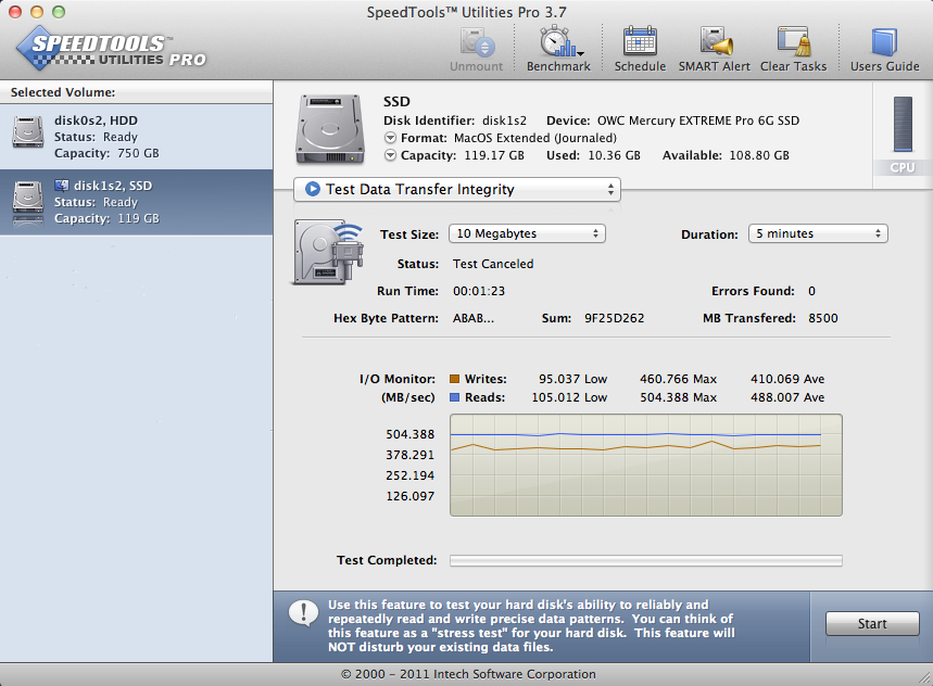

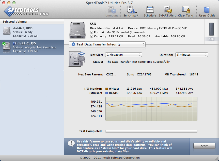

How full is your SSD? The fuller it is, the worse the write performance. Also, have you checked that your SSD shows up as SATA 6Gb/s device?
There's basically nothing but Lion on it. Under Serial-ATA it says 6 Gigabit for both Link Speed & Negotiated Link Speed - I guess that's it, right?
Here is a screenshot of a little test I ran in a different software though (the speeds look pretty good here??:
