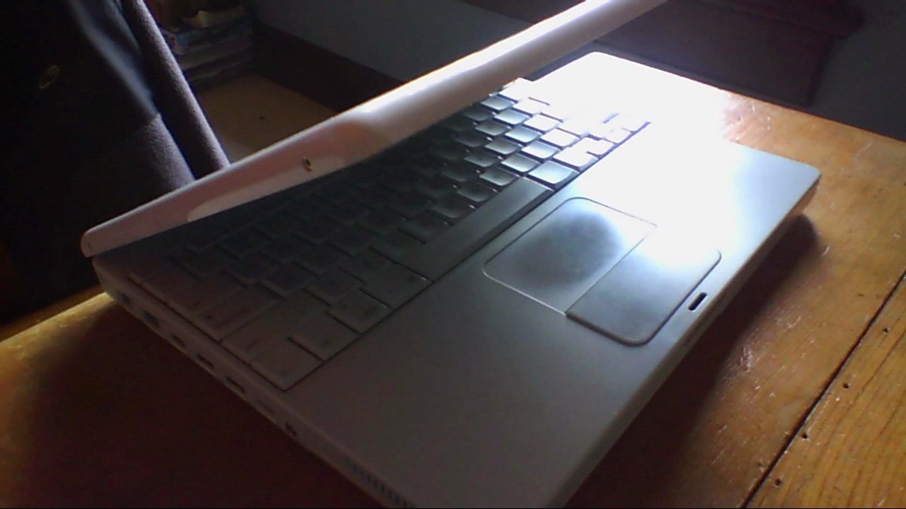

The next upgrade I am going to perform on my G4 iBook is an SSD. I have a few questions though. Should I get a IDE/PATA SSD (32 GB), or a mSATA bridge and a mSATA SSD? They both add up to around the same price, the IDE SSD coming in at around $45 and the mSATA SSD around $40. Would the mSATA bridge increase speed and performance or not, since everything is still routed through the IDE input? Also, I have heard of the mSATA bridges not being terrible reliable, and of course they won't fit perfectly in my G4. Please reply with suggestions. Thanks!

Go with a mSATA. They fit perfectly, with the correct adapter, can be reused in a future SATA/mSATA machine, are cheaper per gigabyte, and are generally more robust. The adapters cost about $25.
The speed will always be bottlenecked by the IDE connection. I went with a Transcend 32 GB IDE so I wouldn't have any fitment issues with adapters, but I believe others have been able to use adapters without any problems. You won't get any speed benefits though. It might be nice to not have to hunt down an IDE drive however, so you will have more options when you go to replace it if you use an adapter.
So as I understand there is no way to overcome the IDE speed curse. It makes sense to me, just wanted to clear that up. No matter what hard drive I buy, it will be limited in speed by the connection. Sort of like water and a funnel. 😱
Correct. In the best cases you can reach about 95% of the maximum theoretical speed of the bus.
