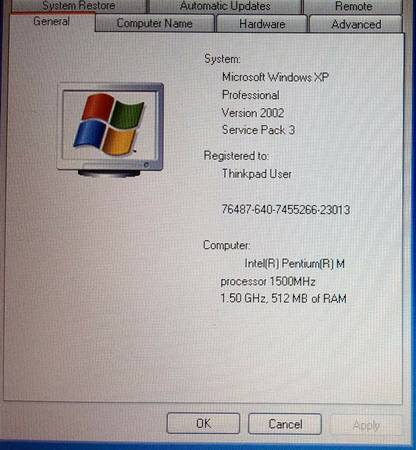

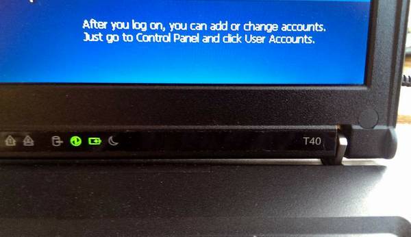

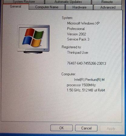

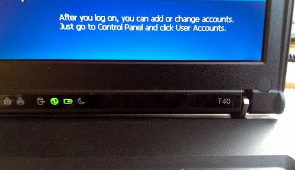

Hmmm reco2011...I don't see the name iBook on that computer. OH, MY BAD. It isn't. It's a T40. Very different than an iBook. You're still missing every point I've made. I don't know if it's purposeful to annoy me, or if you seriously can't see what I'm saying. That isn't an iBook or PB. Thus the results will be different. So you mean to tell me that a Lamborghini is the same as a Ferrari? Or an F-22 is the same as an F-35? Nope, sorry. Not buying it.
But it's almost identical to the system linked to by GraniteTheWolf (see post #46). It was his post which I responded to when I entered the discussion, not yours.
