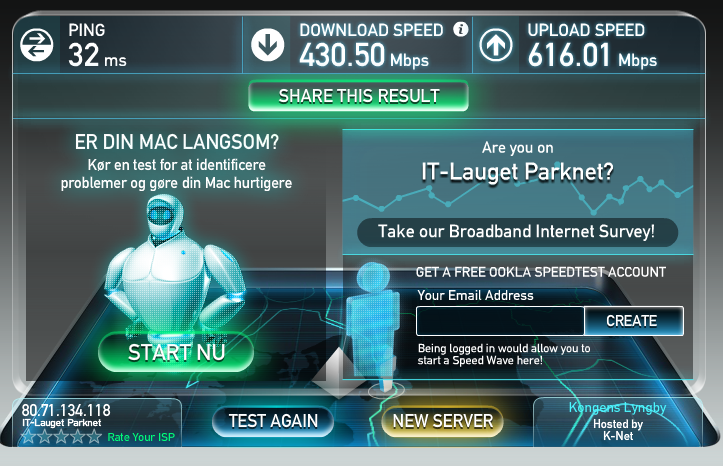

It goes directly to the TC. No modem, and it´s fast...
Okay... now I'm jealous! 😀
How and with what setup are you connecting to do this speed test? Is your computer set to a static or DHCP?

From your speed test earlier it looks like your Internet IP address is 80.71.134.118. I can actually ping that address. That should be the static address the IP gave you yes? Did you enter that in the static IP section in the TC setup screen? From your Airport Utility screenshot it looks like you did not.
That 192 is an internal address and not your Internet IP address.
