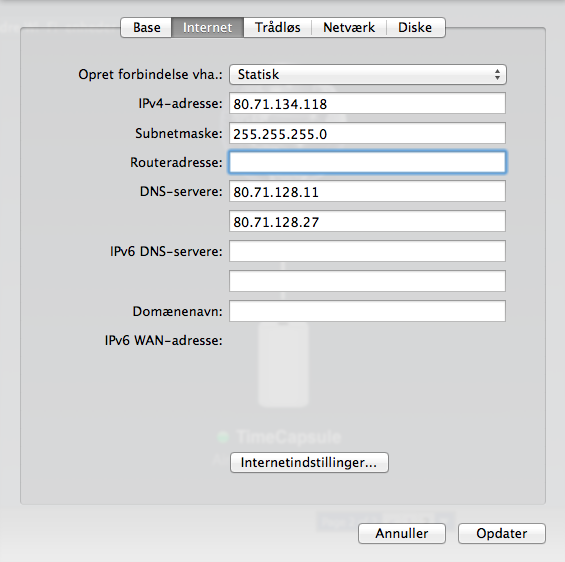

Well, no. The instructions from my ISP told me to enter what you see in the screenshot. Did the same with the old router.

Type in 80.71.134.118 as the static IP then use DHCP in the 192.* range to serve up local IP's to devices connecting to your TC.
If I do that, I don´t know what to type as the routers address...😡

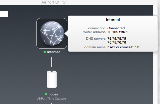

Here's how you find out.
Open the Airport utility. It should look like this :
There you will see the router address.

How is this screen setup under Airport Util in the Network tab then Network Options at the bottom?
That would normally be 80.71.134.1

What do I typer under "routers address"??
