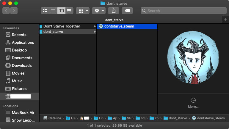

The games are run from here:

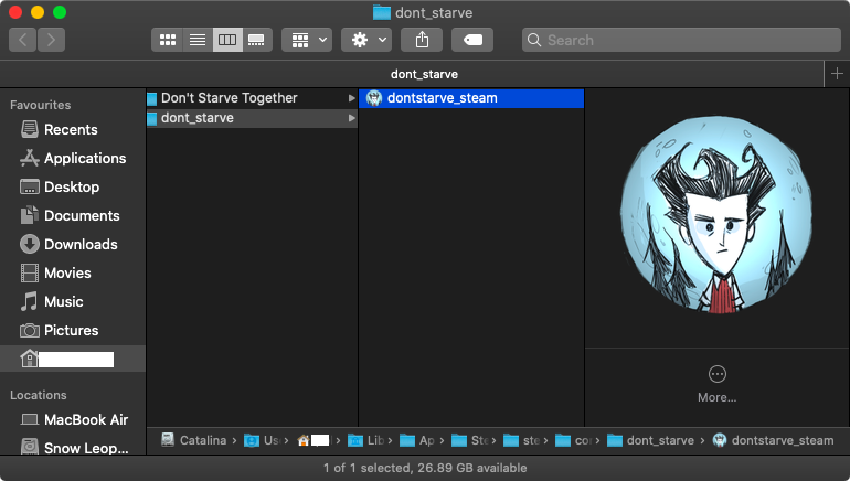

Now that I've managed to circumvent Imgur's UK geoblock (that was imposed without any warning, thanks so much!), I can share a screenshot of the location where you thought that the games would be stored.
To reiterate, of the two folders, only one has a file and as you can see, it's not executable.

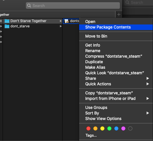

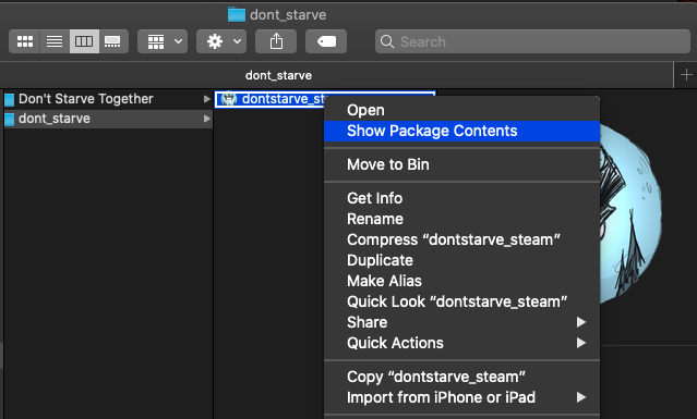

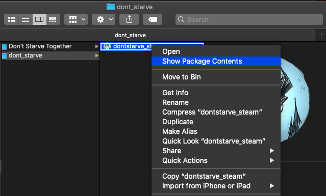

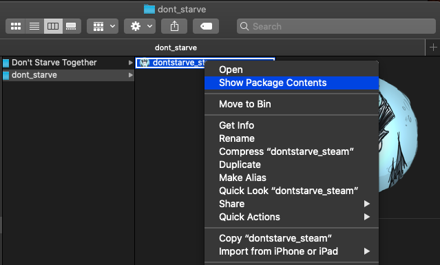

What's in Show Package Contents of dontstarve_steam?
Yes, and then what's in the Contents folder? Please look for "libsteam_api.dylib" and/or "steamclient.dylib".
Oh, sorry it looked like the folder just wasn't expanded. Well, your earlier screenshot showed the app bundle is 9.3 MB, which can't be true if it only contains an empty directory, so one or the other is lying to you.

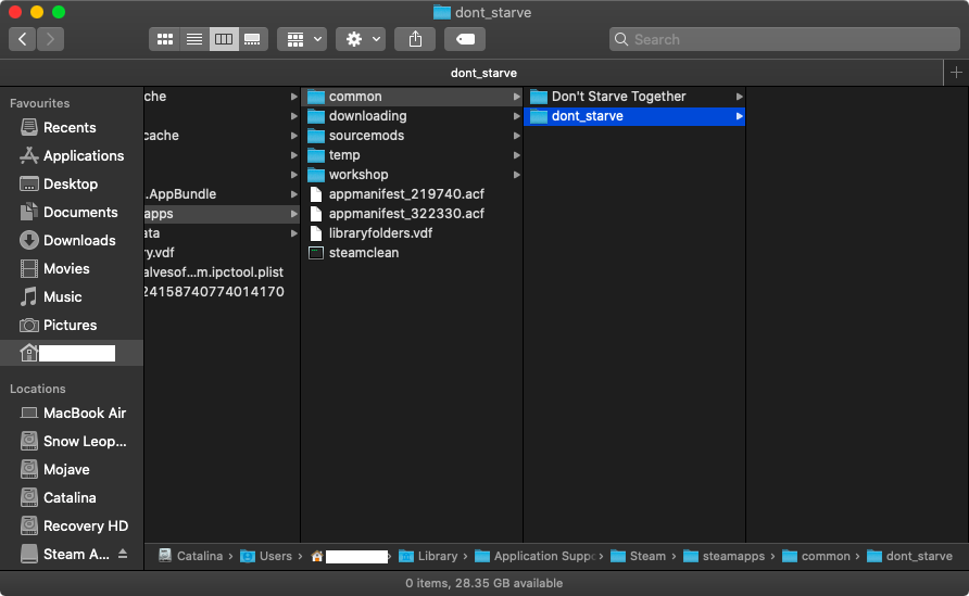

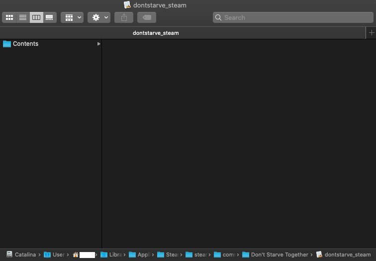

I owe you the apology because I wasn't paying attention and showed you the wrong folder. This is the game folder that's empty - for Don't Starve, which is the single player version of Don't Starve Together:
See? Completely empty with 0 items under Finder.

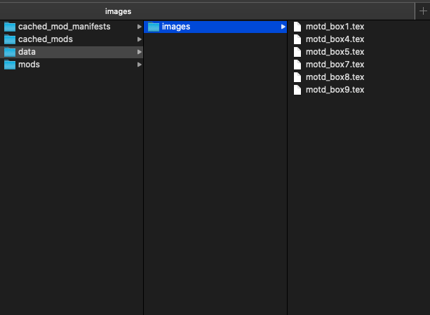

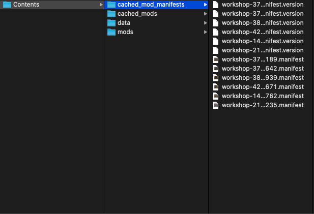

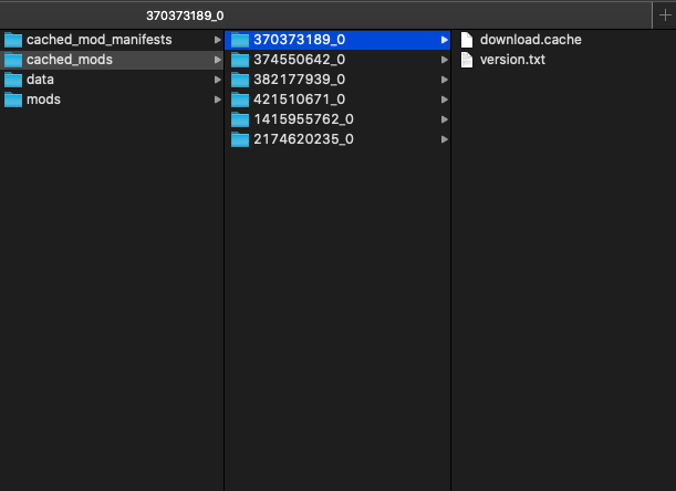

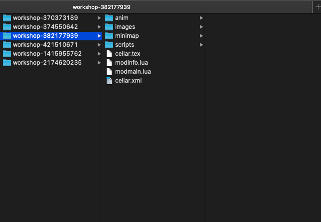

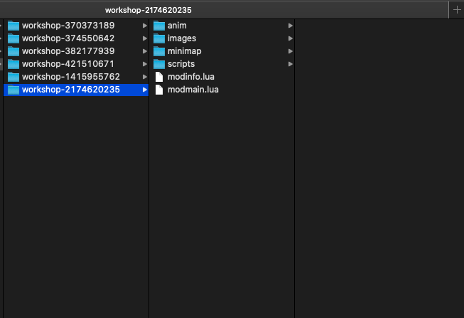

Here's the contents of Don't Starve Together:
There are no copies of libsteam_api.dylib or steamclient.dylib in those folders.

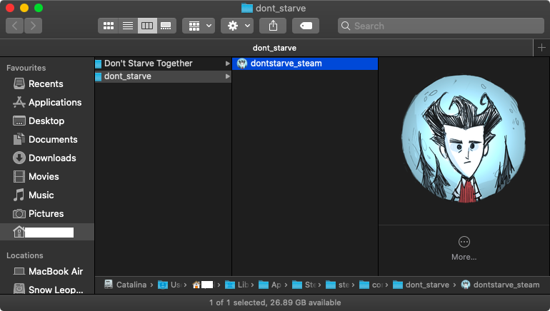

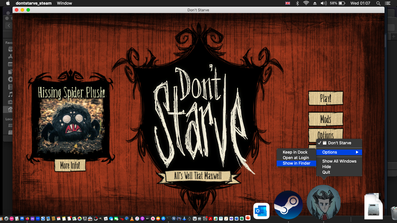

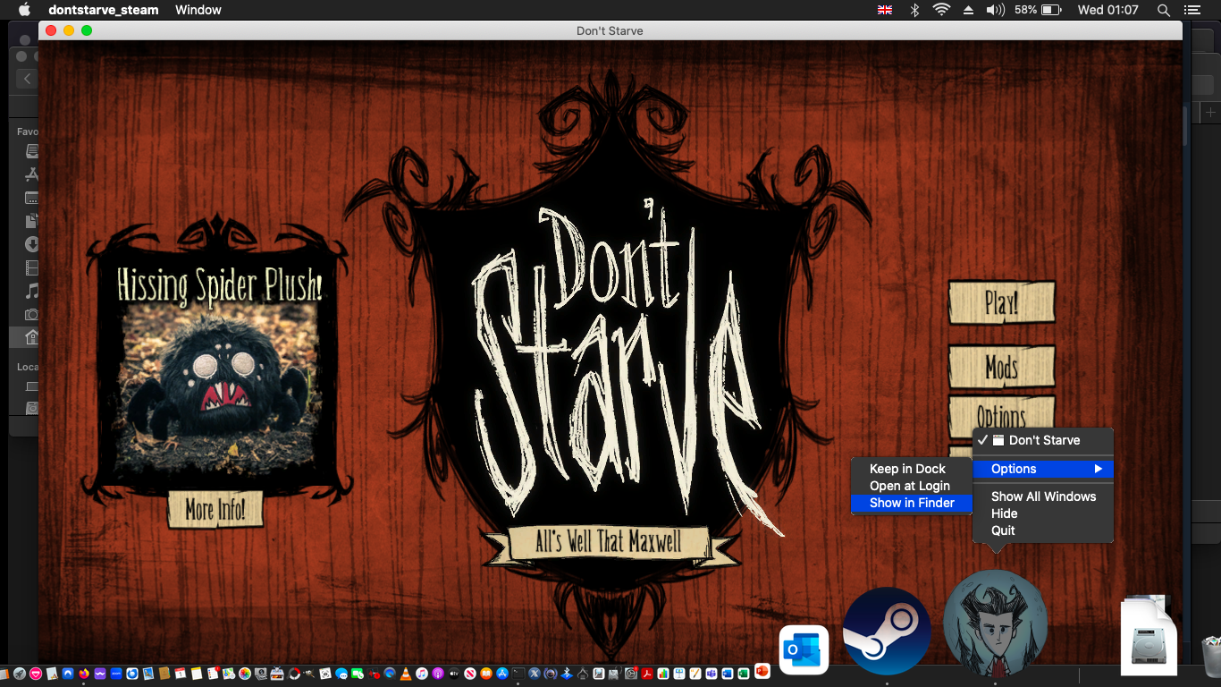

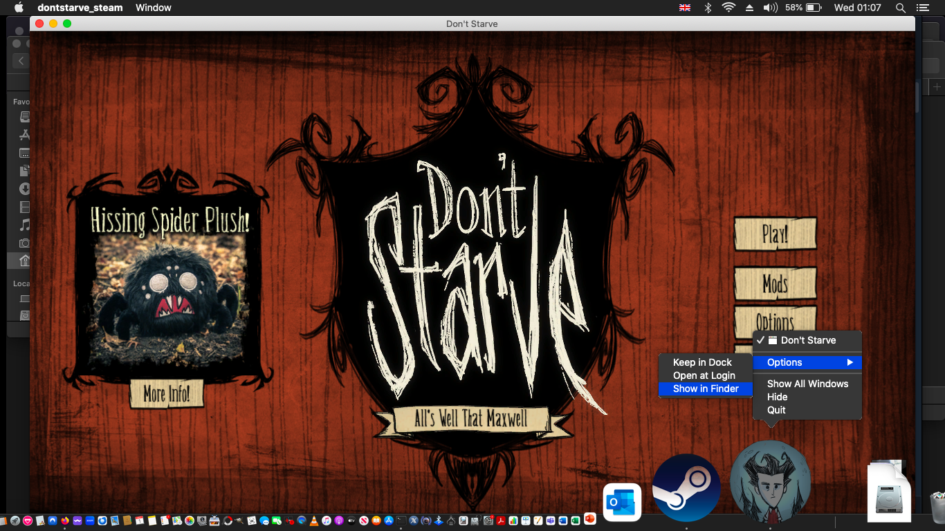

Launch the game, then right-click its Dock icon and choose Show In Finder. Where does that take you?

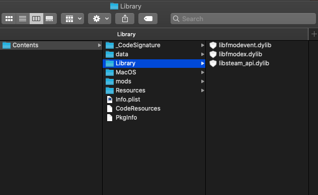

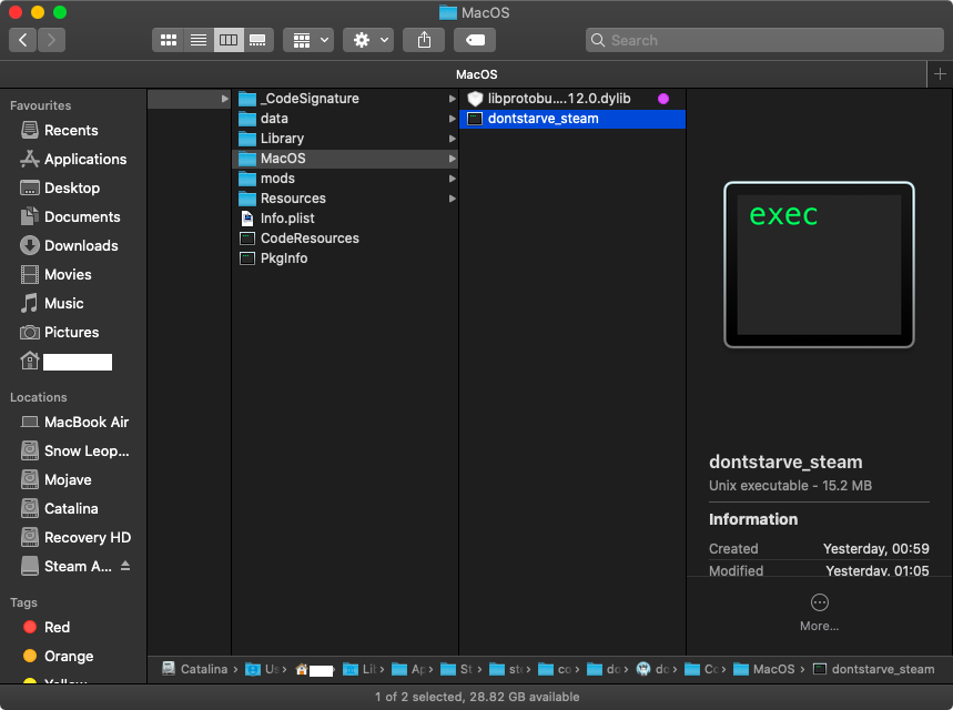

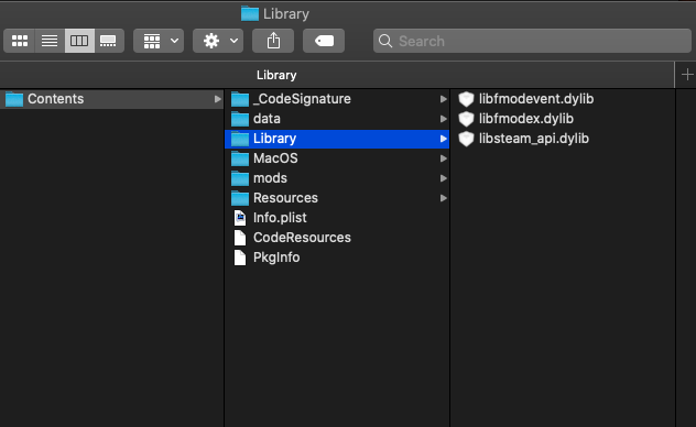

Once I allowed Steam to go online, it re-installed the game and your instructions took me here:

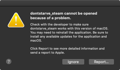

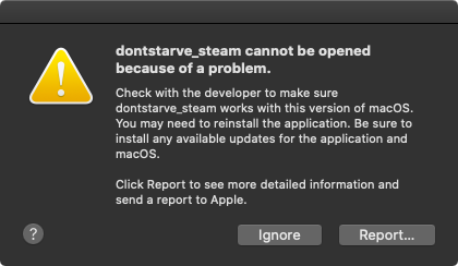

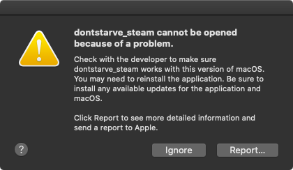

I then copied the patching dylib files into "Library", ran dontstarve_steam and received the following error message:
Yay, you finally found it! Did you also copy the protobuf dylib to the same directory as libsteam? If so, please press report and share the crash log.
Yes, of course. I explained that I copied all of them into the Library folder. 😉

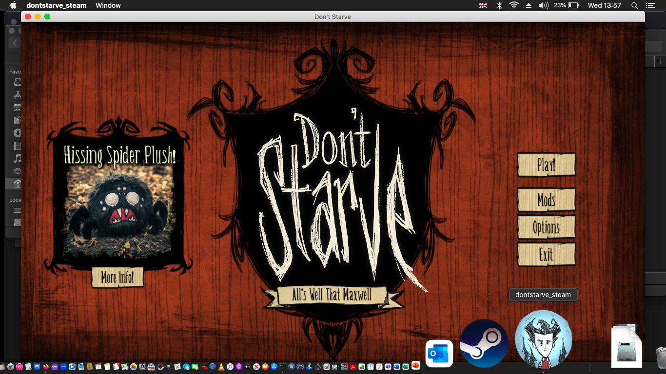

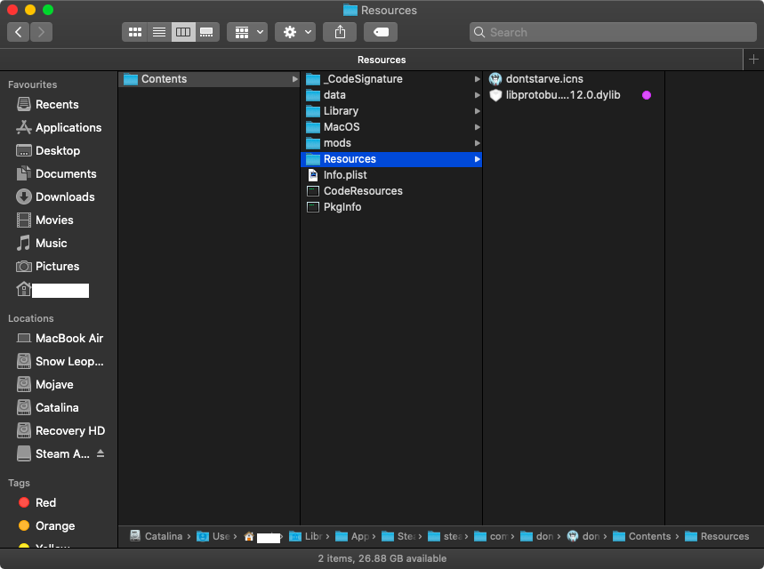

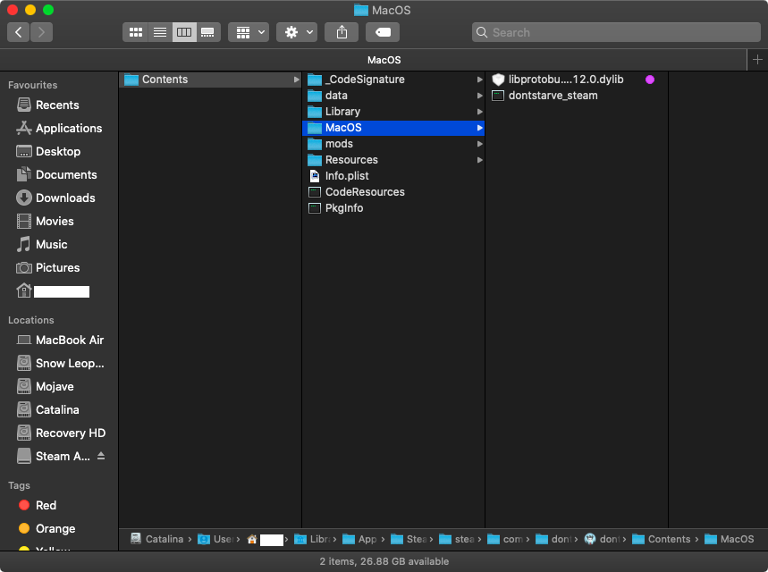

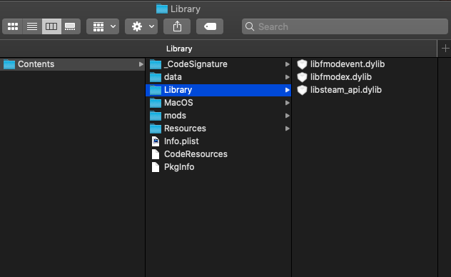

After a nap, I had another crack at this as I suspected that on Catalina, protobuf probably needs to be placed elsewhere because the configuration is different from earlier macOS versions. So I copied it into two other locations:
Now, let's try again…
Yes, the patching is now working! 😀
Do you notice that the Steam icon in the dock is inactive? That's confirmation that the game is no longer requiring Steam to run. It took me a few false starts but between you and @Nermal I got over the finish line eventually. I no longer have to worry about my OS being unsupported because I can purchase games and run them independently and it also means a lower system overhead on this particular computer (2GB 1.4Ghz C2D) because it no longer has to run both Steam and the game.
Please update the original post and the API emulator instructions to warn people that on later macOS versions the location for protobuf is different. 🙂

I’m actually a little confused as to why the protobuf library needed to be in a different location. (I’m not entirely convinced it’s due to Catalina as opposed to something about this specific game.) Which of the locations ended up being necessary for the game to run?
In a while, I'll delete the file from both locations and then check which one works.
I can confirm that it's the MacOS folder because with the protobuf file deleted from "Library" and emptied from the bin, Don't Starve still runs without Steam
Thanks, that makes some sense, it probably has to do with how the game sets its paths. So for some games, protobuf needs to be with the other dynamic libraries, and for some it needs to be next to the game binary.
