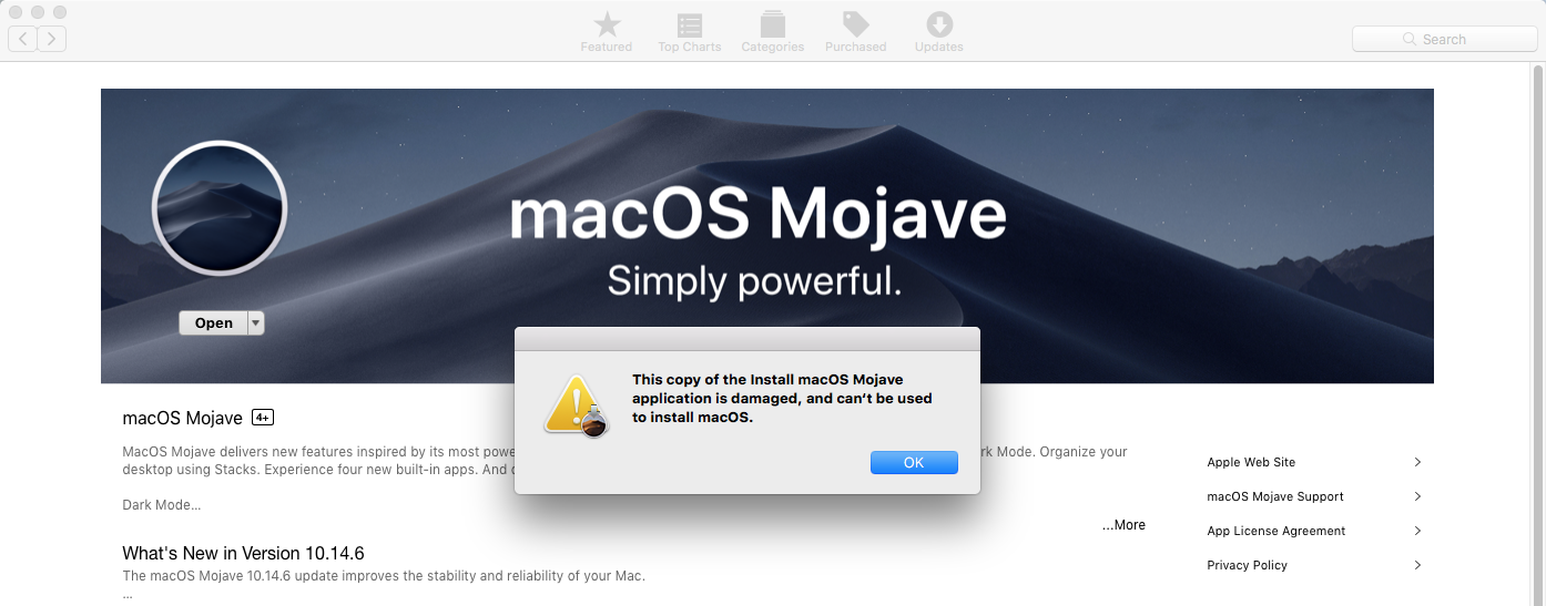

I'm wondering if updating to Mojave would be better. I tried downloading the installer from Apple's website link that redirects to the Mojave App Store page, and when I click on the "Open" button, the error message shown in the attached screen shot comes up. I noticed the button says "Open" and not "Download" as it does on the Catalina App Store page.
Does this mean Mojave is no longer available to download?

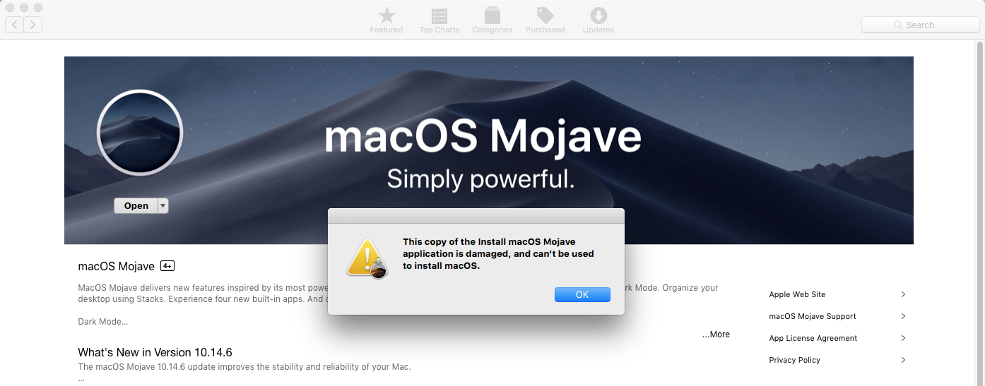

Remove from all your disks, yes external too, any previously downloaded Mojave installers.
You probably have previously downloaded Mojave somewhere on your storage and this version have the signing certificates that expired October 24.
You can always download Mojave from the Apple support article
Yes, thank you, I forgot I had already downloaded it some time ago -- on my work Mac, which is where the error came up. It's sitting right there where I left it in the Applications folder. 🙂
