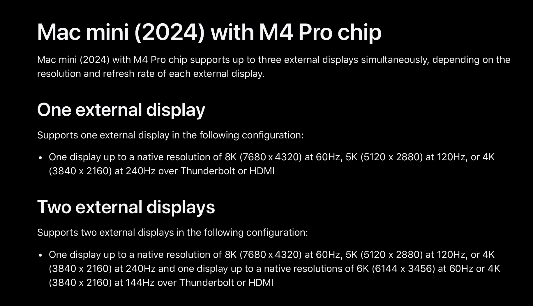

It appears this article has the answer... For some reason the M4 Pro Mac mini is slightly more capable than the M4 Pro MacBook Pro. I did not realize this limitation otherwise I would have gone with the M4 Max!!
Mac mini M4 Pro
MacBook Pro M4 Pro
Hoping this can be fixed with a software update but it sounds like there is definitely some hardware limitation.
Mac mini M4 Pro
MacBook Pro M4 Pro

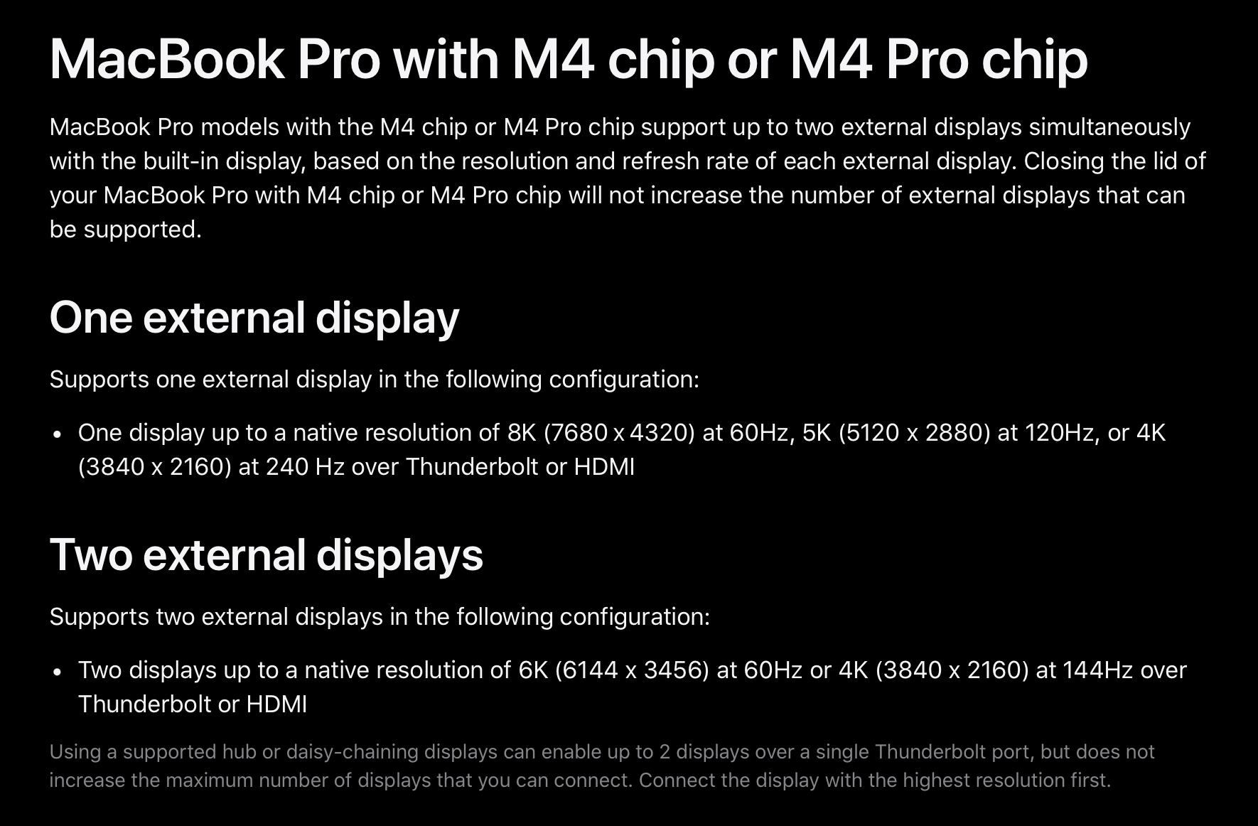

Italics below is copied and pasted from Apple's support page, detailing exactly what your m4 pro mbp can and can't do, and I will translate.
You can do up to two external displays in addition to the built in display.
If you run one display at 5K 120 Hz, that is the only external display you can run.
You absolutely can run two external 5K displays AT 60 HZ EACH.
Yes you can daisy chain from one XDR to another display, if you can handle your settings, thunderbolt cables, and thunderbolt ports correctly.
So. Fire up the mbp alone. Then connect the first studio xdr display with the included tb5 cable. Set it to 60 Hz. Then grab the other tb5 cable included with your second studio xdr, and plug in the second display into the first. (Or plug the og studio in with its included tb3 cable.)
Don't freak out. Call support if you need more help. Don't forget to restart the computer and run updates if needed.

MacBook Pro with M4 chip or M4 Pro chip
MacBook Pro models with the M4 chip or M4 Pro chip support up to two external displays simultaneously with the built-in display, based on the resolution and refresh rate of each external display. Closing the lid of your MacBook Pro with M4 chip or M4 Pro chip will not increase the number of external displays that can be supported.
One external display
Supports one external display in the following configuration:
  • One display up to a native resolution of 8K (7680 x 4320) at 60Hz, 5K (5120 x 2880) at 120Hz, or 4K (3840 x 2160) at 240 Hz over Thunderbolt or HDMI
Two external displays
Supports two external displays in the following configuration:
  • Two displays up to a native resolution of 6K (6144 x 3456) at 60Hz or 4K (3840 x 2160) at 144Hz over Thunderbolt or HDMI
Using a supported hub or daisy-chaining displays can enable up to 2 displays over a single Thunderbolt port, but does not increase the maximum number of displays that you can connect. Connect the display with the highest resolution first.
A couple points:
1) What myself and others have been arguing what Apple is saying about the two external displays (see below). DOES NOT WORK or works inconsistently at best. You have to plug the displays in the exact right order and it is not stable. If you plug in the display in the wrong order one monitor won't work. Sometimes when it wakes from sleep, one display does not turn on. This is certainly a bug that will get fixed in software. It's pretty crazy to me the number of people having issues with the MBP M4 Pro specifically. Surprising as Apple is usually more careful about quality and compatibility than this.
2) This is just an opinion but I cannot believe my base $499 M4 mini with Thunderbolt 4 can run two 6K displays (one at 120hz and one at 60hz). The $3349 MacBook Pro can't run this. Seems ridiculous to me. Apple in the past has leveraged clam shell mode to support higher quality display output to external displays. Seems lazy or an oversight. Maybe something that can be fixed in software, we will see.
3) Daisy chaining doesn't work and based on my understanding it probably should on M4 Pro. I have tried every possible thing I can think of to make it work. I have no idea why this is the case. It would be helpful it Apple extremely clearly laid out on an information page about what is supported specifically on the Studio Display XDR and ensure to include what the expectations should be rewarding daisy chaining because like you said we're spending a lot of money here.

A couple points:

  • One display up to a native resolution of 6K (6144 x 3456) at 60Hz over Thunderbolt, and one display up to a native resolution of 4K (3840 x 2160) at 100Hz over HDMI
Hoping for a fix soon as well.
I understand but to my original point they used to do this with M3 and stopped doing it. I am assuming this affects less than 1% of people but you know would be a nice touch. The point is the M4/M4 Pro are clearly capable of this but it's just something they decided not to do on the laptop version. E.g. below:
Two external displays​
Supports two external displays in the following configuration with lid closed:
  • One display up to a native resolution of 6K (6144 x 3456) at 60Hz, and one display up to a native resolution of 5K (5120 x 2880) at 60Hz over Thunderbolt
if the limitation is baked into the silicon, which I believe it is, there won't be a fix.
I suspect it's something with the way it's "wired" internally. I wouldn't get your hopes up for a fix.
You're probably right. I'll be happy if they literally just meet the requirements of the support page. Everything else will just be a bonus.
