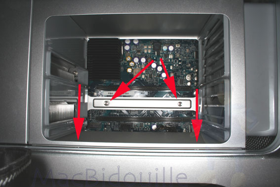

	I actually didn't remove the memory cage. I messed around trying to get it out for about 10 minutes then gave up. If I remember correctly though, I did have to remove the screws in order to slide it over to the right. Which screws exactly did you strip? I would say the only thing to do is get them out with a pliers or vice grip now. You might end up having to buy a specialized tool (long needle nose plier or very skinny vice grips) that will get the job done in that cramped space.
You may have to just end up grinding them out with a drill. I had to do something similar with some other screws in my Mac Pro - I used a handheld electric screwdriver with a little drill attachment.
the ones that are pointing down when the case is upright? I think you could have good luck with a compact right-angle pliers. I don't think you'll have much trouble if you have the right tool.
Is that wise? Did it work? I've never drilled anywhere near a computer before!
