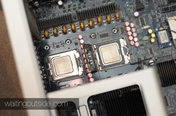

Great thread! I just found it...after upgrading to 5355 over the weekend.
So far, all is well. One question: About This Mac shows "Unknown" for the CPU. This is cosmetic only--but does anyone know a fix (Beyond changing AboutThisMac.strings)? I remember seeing something about a new plist file with CPU definitions but of course can't find it now. (OS 10.6.2, by the way)
I'll add my experiences with this upgrade in case it helps someone else down the line.
The sites (pix) that were most useful:
http://www.anandtech.com/Mac/showdoc.aspx?i=2832&p=3
http://www.hardmac.com/articles/70/
http://www.o0o.it/pro/
MacPro Service manual (find it online).
The blog post above was great, too! I had just as much dust on the heatsinks, so it was good to clean it out.
Memory Cage: Same trouble as nearly everyone. Apple has a little wrench that fits over the hex standoffs. Someone enterprising could make one from a thin piece of metal. That would have helped. Instead, used the trick from Anandtech: remove the plastic partition at the left side of the memory cage. (Slip a thin putty knife around all sides except the one near the motherboard. There are 2 latches on each side, near the corners).
Heatsinks: used ArcticClean & Arctic Silver (Radio Shack) for these. FYI, manufacturer recommends only a thin line of thermal compound above the cores. (http://www.arcticsilver.com/arctic_silver_instructions.htm). For the 5355 as far as I could tell, the cores are oriented vertically. Verified that this method coats evenly by pulling the heatsinks.
Hex Key: In US, check bargain bin at Ace--I found a knockoff set for $2 that did the job fine.
One scare: if a cpu heatsink cable is not plugged in all the way, the fans spin up to full speed, which is amazingly loud. I did this.
Otherwise, well worth it if you can find the CPUs for the right price on eBay.
