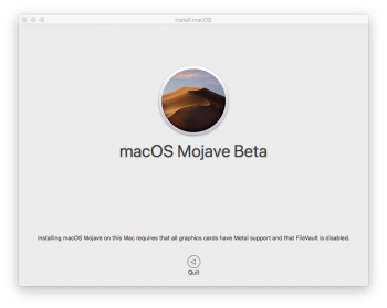

^^^^^Though I can't run Mojave, I believe DP2 can install on a 5,1 cMP. I think the message at the bottom is quite clear, it won't install without a Metal capable card. It does NOT say won't install on this Mac. Am I wrong here?

Yes, DP2 can run on 5,1, but the installer is NOT regardless which GPU installed. You have to install DP2 from another Mac, and then it can boot on the 5,1, but not via direct installation. Or at least not directly download the installer form cMP. AFAIK, this step cannot done on the cMP yet.
That message belongs to a beta installer. And it's known not accurate yet.
A user may not able to install 10.14 with just the GT120. However, it won't stop the GT120 to serve as an emergency card once 10.14 is installed. That's what post #3 talking about. The EFI (boot screen) will still work because that's OS independent.
In fact, I believe in your case, you can still install 10.14 if upgrade from High Sierra. Of course, it depends on how Apple check that "Metal capability". If the installer only read the current GPU status in system info, your 1080 should able to tick that "Metal supported" box. But if the check is based on an internal white list, then most likely both of our Nvidia GPU won't have any luck.
And once the OS is installed, despite there is no Metal GPU detected yet, you should able to boot to desktop with just the EFI display to install the associated web driver (same as the current situation). Again, that's because EFI is independent to OS, as long as no driver to take over, it will work forever.
And MVC already done the test with a Mac EFI HD6xxx GPU, which has no Metal support, but still able to boot to DP desktop without any acceleration. So, unless Apple intentionally keep us away from 10.14, and further change the rule on how the system "able to boot" (not able to install). Any Mac EFI GPU should able to boot to desktop which including your flashed 1080 (before web driver installed), and GT120.
However, No matter your "Mac EFI GTX 1080" or "GT120 + any Maxwell / Pascal combination". There may be no way to perform a clean installation. If we boot from the installer, and the installer further check the "current status of Metal capability". There will be no Metal capable card considered installed (because the installer has no up to date Nvidia driver, and can't recognize the Maxwell / Pascal GPU).
If this assumption is correct. We won't be able to re-install the OS in recovery partition as well unless we have an OOTB Metal supported card.
But in any case, GT120's EFI should work and should display if 10.14 is installed.
Post 3# and Post #8 was talking about if GT120 can serve as an emergency card in 10.14, but not if we can install 10.14 with the help of GT120.

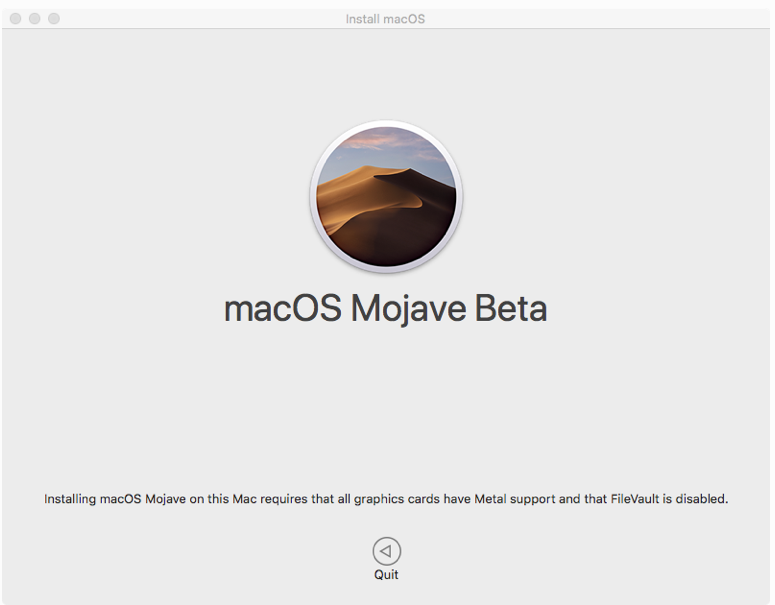

Public Beta installer, downloaded on a MP51, telling "Installing macOS Mojave on this Mac requires that all graphic cards have Metal support" excludes GT120 as EFI failsafe, no?
Just when installing. I would assume after installation, a GT120 can be used in tandem with a metal compatible card if you need a boot screen.
