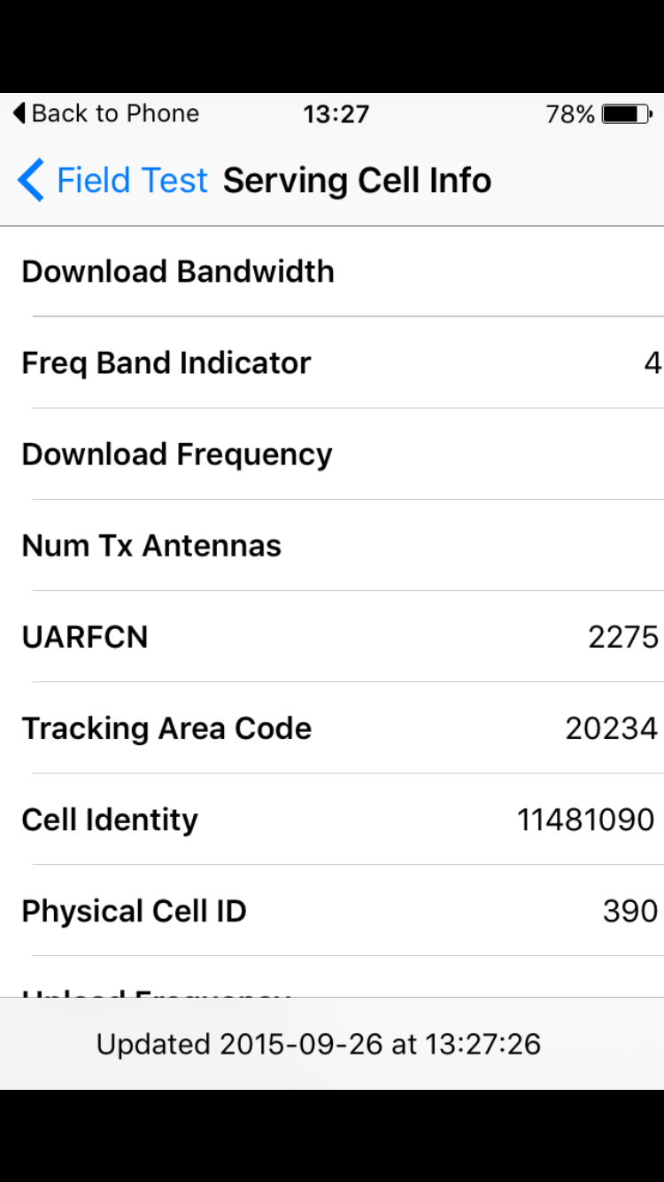

I have been running yet since yesterday and mines has been at "4" all this time! I checked the map and I'm in a 12 band area, I'm in DC but I'm not receiving 12 band

I started a thread about this but didn't get any replies. I live in the DC Baltimore area and I don't have any more bars than I did with my 6 inside my house. One of the reasons I upgraded was for this new band thing, I am wondering though if it requires a carrier upgrade over the air or if it just really isn't that big of an improvement.

I upgraded from a 5s and I live in DC and my bars are the same nothing has changed

Mine will connect to band 12 on occasion, so I know it can work. It just doesn't prefer a stronger band 12 connection over the weaker (indoors) band 4 connection like I expected it to.
