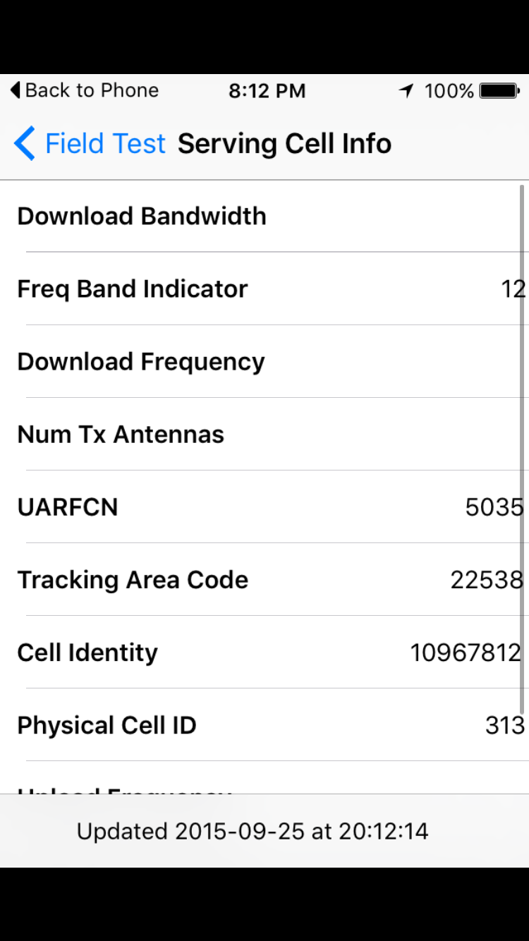

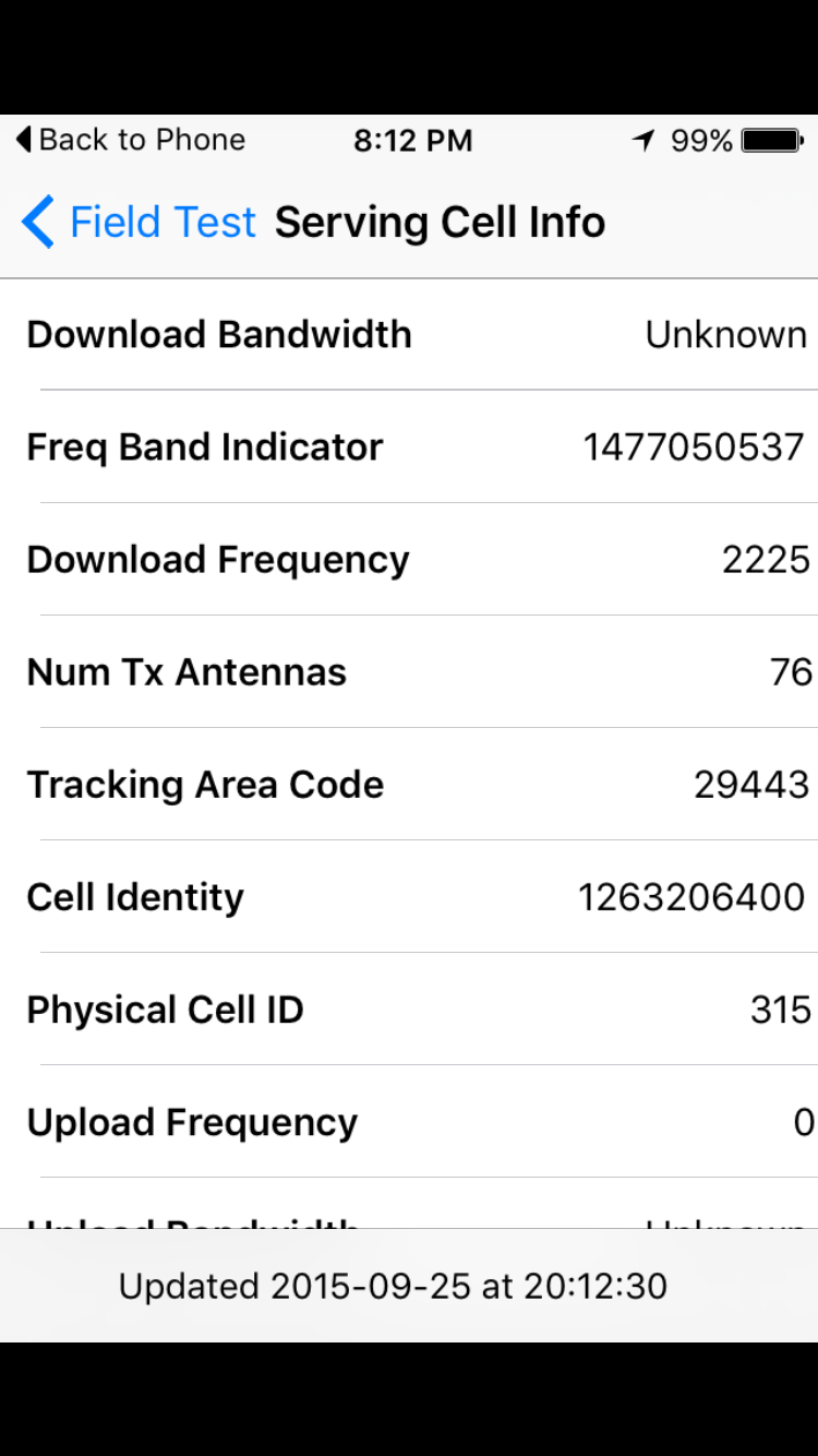

It went from 4 to 12 to that weird 1477... number.
