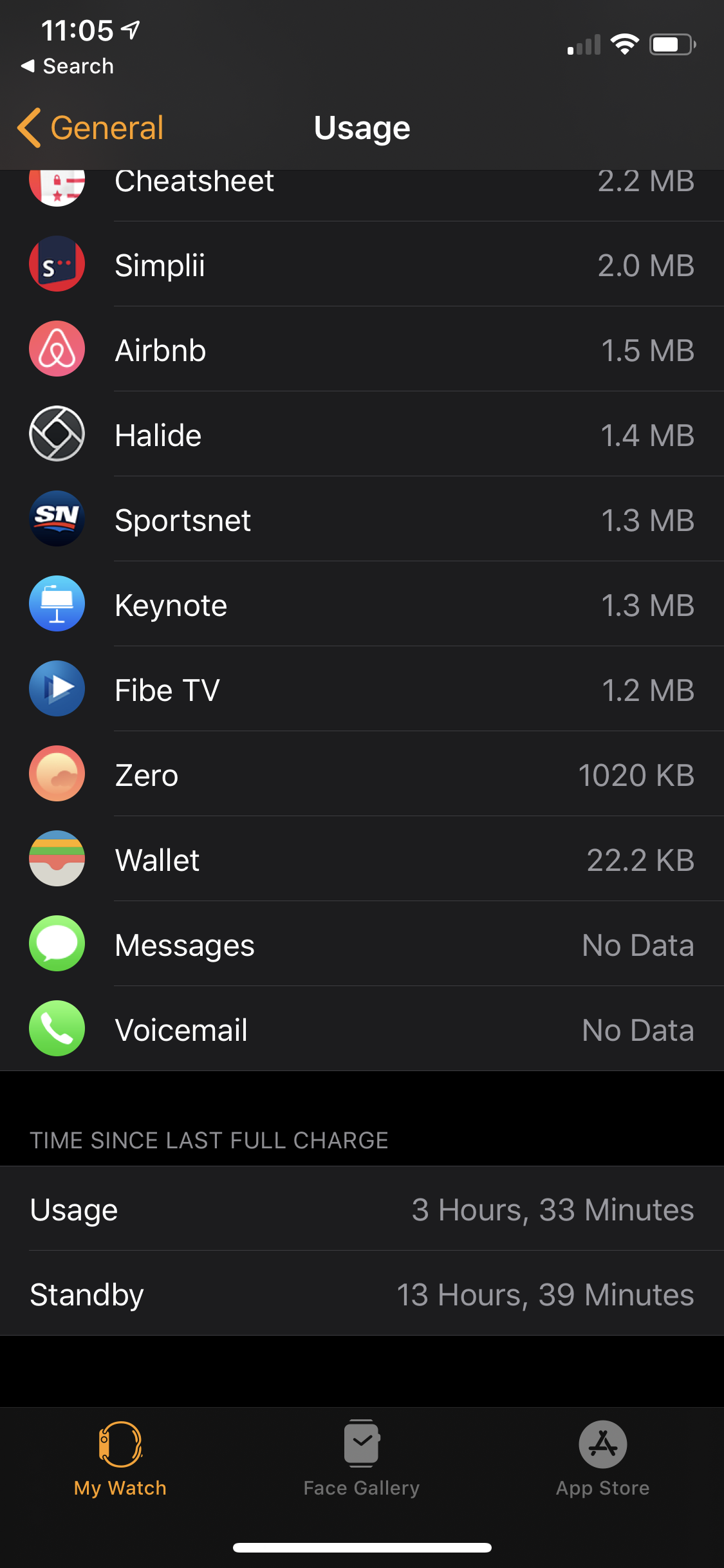

51% this time, similar usage. Only difference being 13.1.1.
