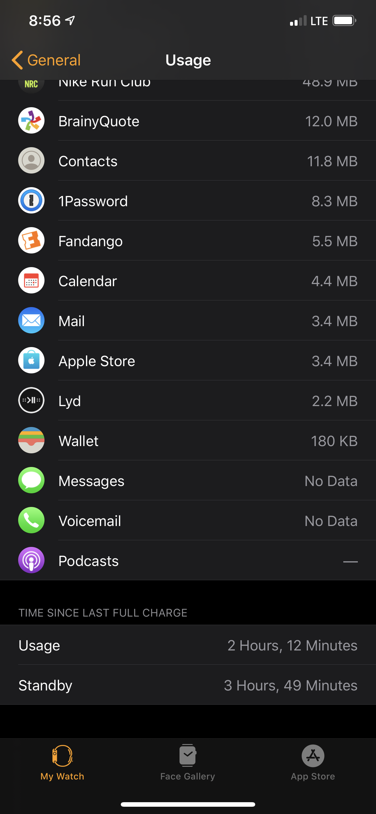

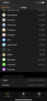

Today usage is attached. This includes a 90 minute workout. AOD has been off the whole time. Battery is at 85%.
