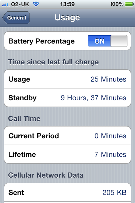

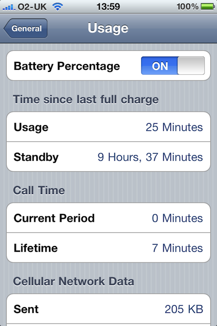

It's definitely one of the apps. Screen cap is with only the jailbreak and nothing else installed.

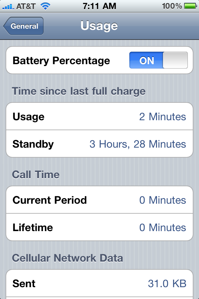

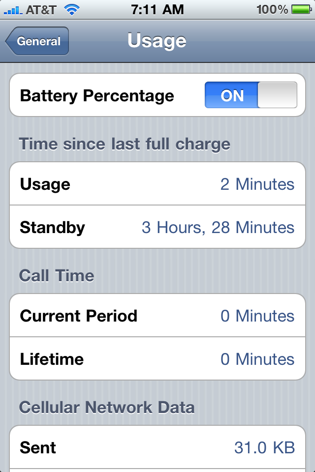

my Iphone 4(Pre Jailbroken) would still be at 100% after 9 hrs on standby.
